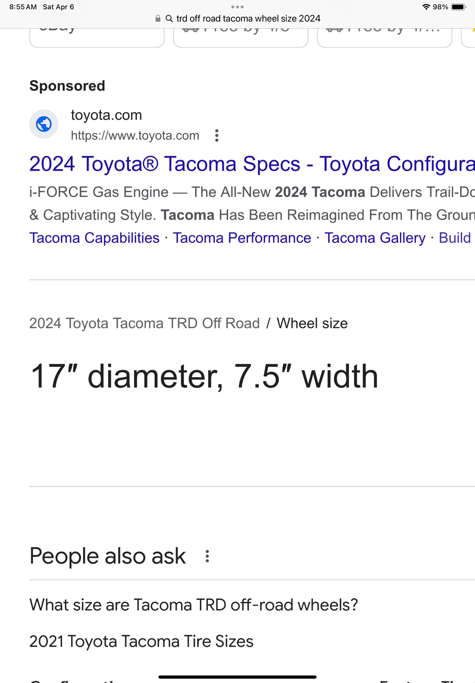

Could you do me a favor if possible and check the factory OR wheel width?
I'm shopping tires that the dealership will upgrade when the truck lands and I can't figure out iif the factory wheels are 7" or 7.5" or even 8?
Side note - your new bronze wheels look fantastic! And we have similar taste I opted for a White Trd OR as well.
I found this on google. I will try and double check my oem wheels, but that might be difficult with the tire mounted to get an accurate measurement. The factory tires are chintzy to say the least.

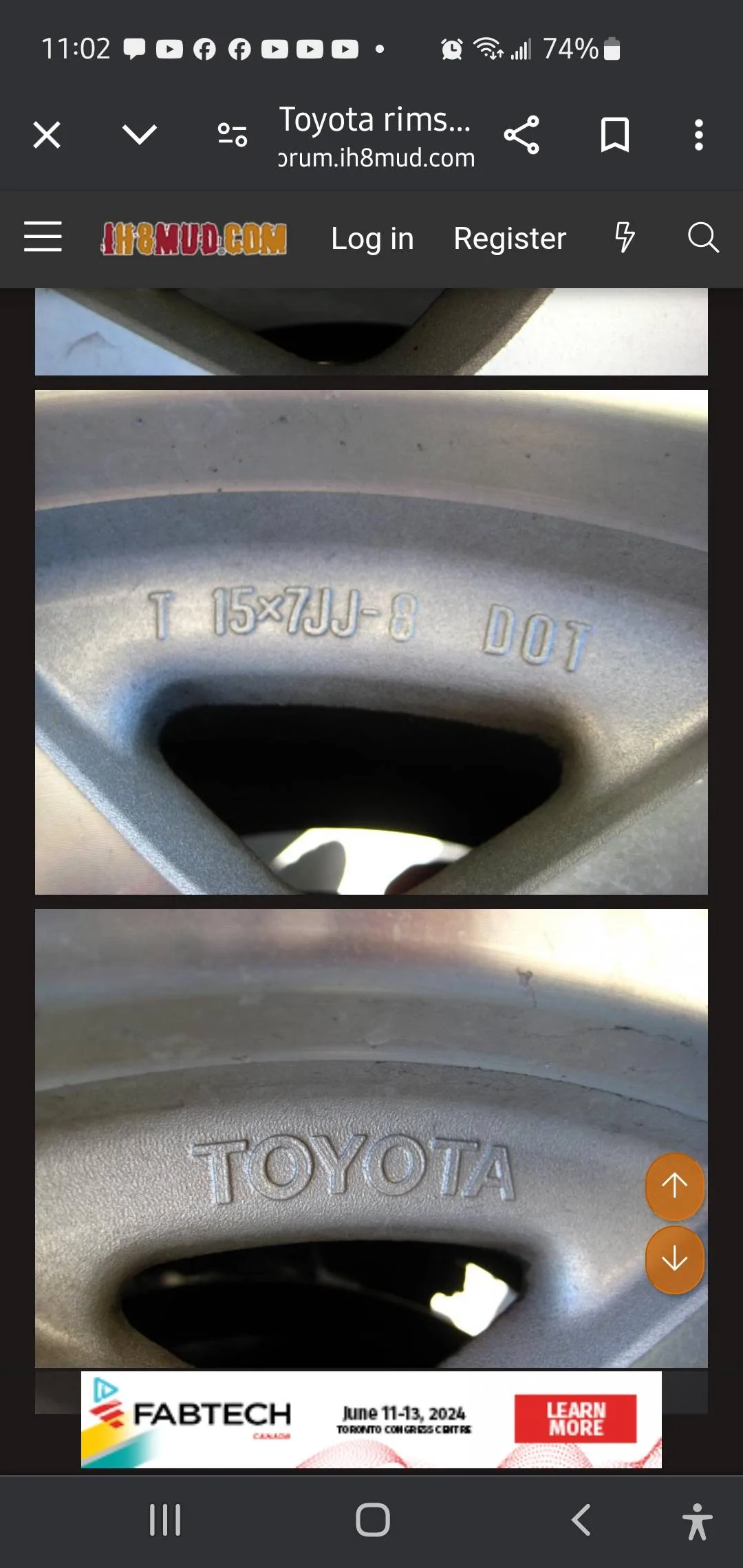

If it's too awkward to check behind I totally get that but if you can get a look on the inside of factory wheels they should be stamped somewhere on the rim showing 17x7.5 or similar

I’m on it! Didn’t know that. Give me a minute.

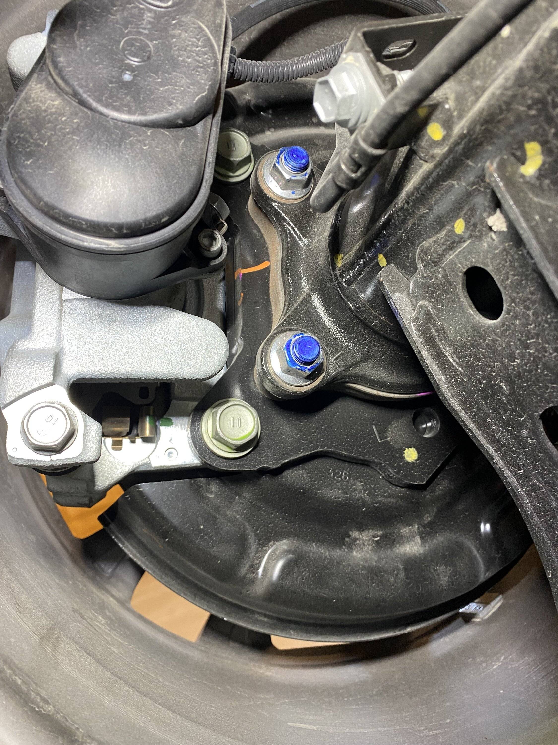

Sounds like you have a lot more tire experience than I do. All I know is the side wall is so soft, it feels like I could push my finger through it. It also does nothing for the aesthetics of the truck.
So I crawled underneath and can’t see the back of the wheel because of the disk brake. If I get a minute this evening I’ll jack it up and take one off.

Oh don't worry about it I really appreciate you trying but don't bother pulling the wheel I can talk to the dealership and really we should be able to trust toyota.com listed specs that you found earlier that it's 7.5".
Appreciate you going thru that effort already.

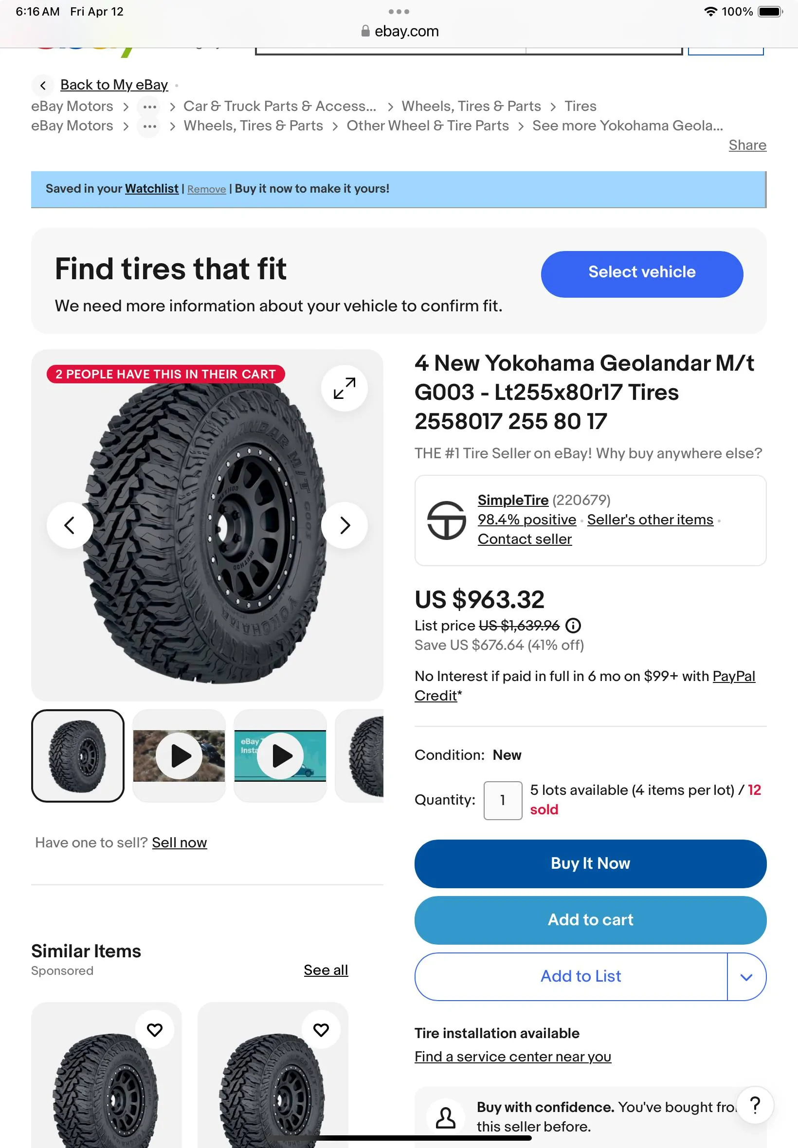

I have wondered about this tire quite a bit. Still narrow, but would be a true 33. Sorry to make you think about this more!

Those Geolanders are beefy! I bet they'd look great however my concern is that their listed weight is 53.4lbs. They stock tires I believe are 37lbs. I think your Destinations are around 37lbs too.
With Yoko's aggressive mud tread and the substantial increase in unsprung weight per tire, I think it would affect the driving experience and hurt mpgs quite a bit.
If I was offroad daily then that tire would be something I strongly consider.
