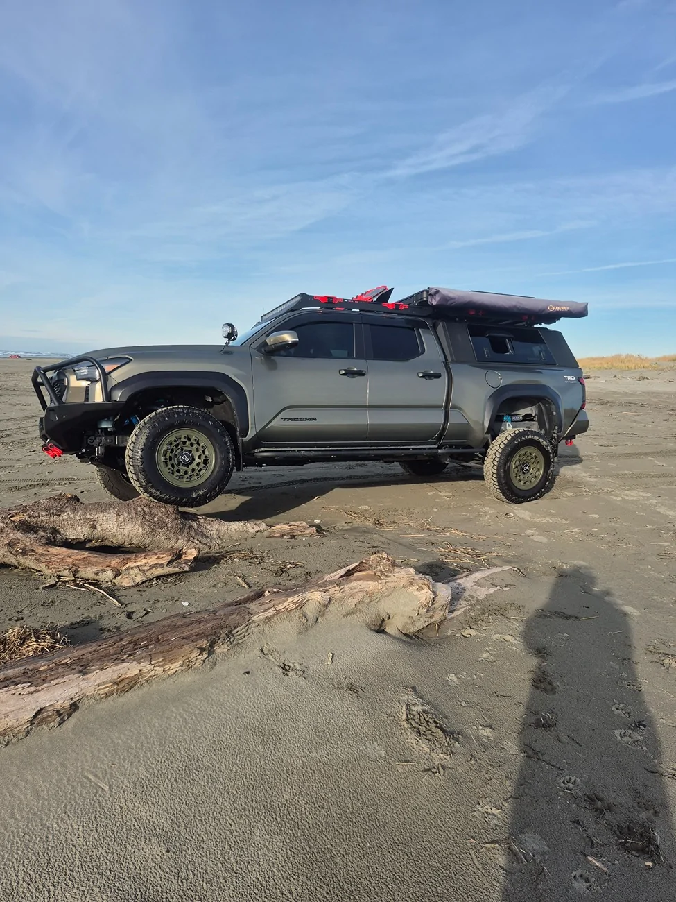

A 285 75 17 measures
33.8 inches tall and 11.2 inches wide. I agree with Briscoelab that these trucks are better off with a narrow tire than wider ones due to the rubbing and trimming needed to accommodate a wider tire.
At the moment I am running with a set of E rated 255 80 17 +20 which measures a true 33x9.5 with 0 trimming and 0 rubbing when I am out using it off-road with the stock suspension. I have added a 3" King long travel kit on my Tacoma and will be upsizizing to a 35x11 when I have worn these out.
My research into upsizizing to the 35s with the +20 offset and the 3in lift has provided me with enough information to confidentiality go to 35s with 0 rubbing and trimming? We will see down the road.
Good luck with your de
2024 Tacoma 35’s or 285 75 17 20251130_134858
Good luck with your decision..
BTW this is the LARGEST TIRE that will fit where the spare tire is located.
