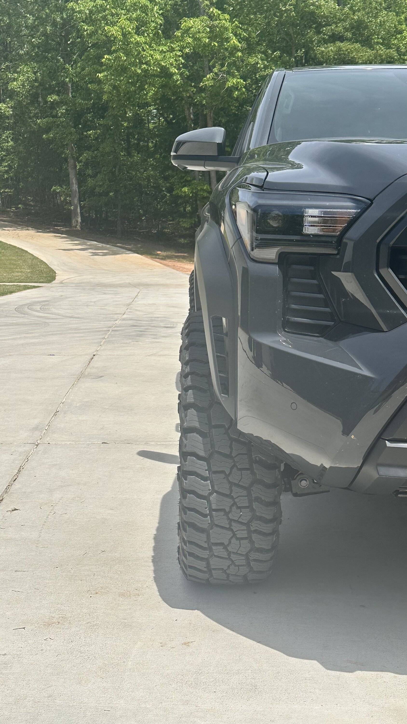

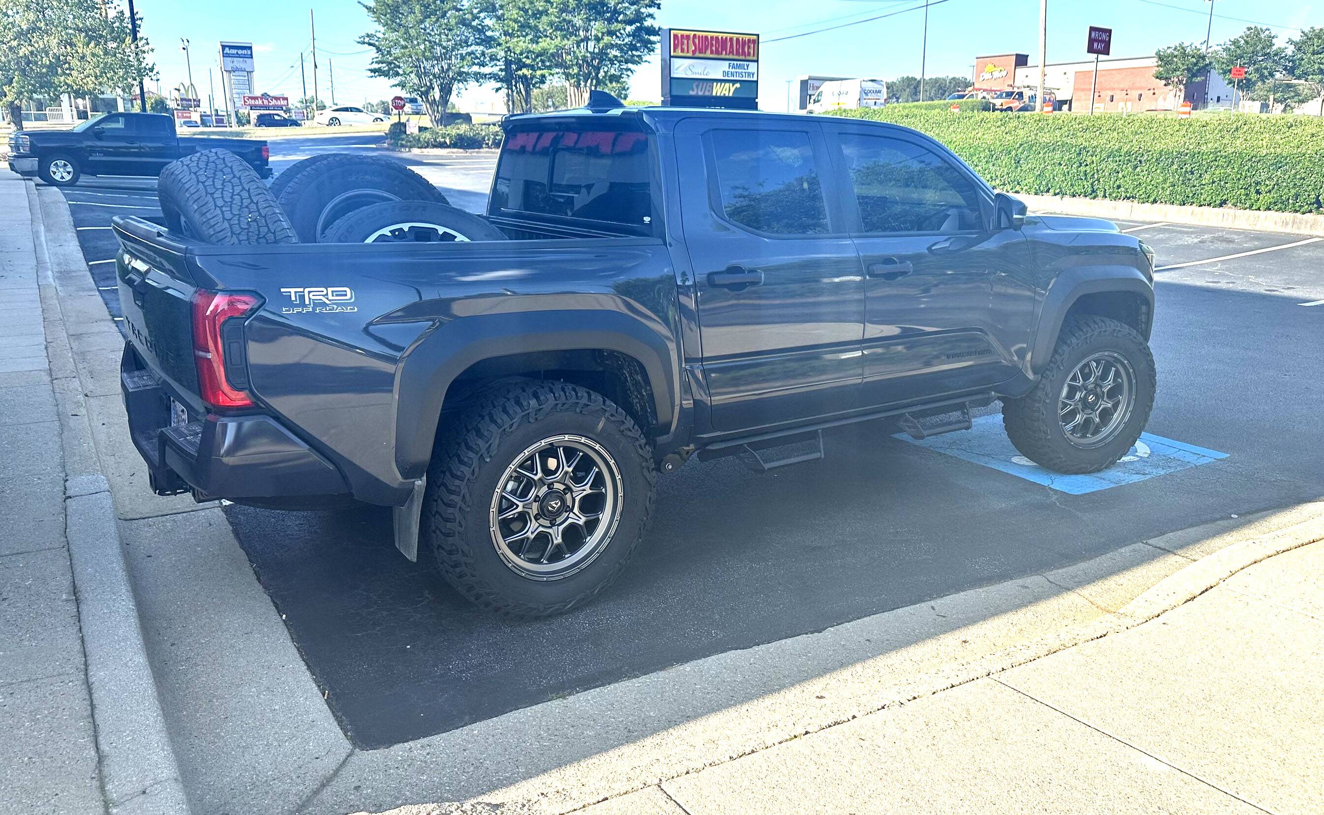

Finally was able to get some new shoes put on my 24 ORP. I did need to remove the crash plates in the front fender well, and remove the front mud flaps. She still rubs a little in the front if I back up and turn quickly, due to the nose dipping down. I may end up trimming some of the felt to prevent that.
Observations after driving for one day: I did lose a good bit of fuel mileage. So far it looks like I went from an average of 16-17, to 14-15. It has plenty of power to turn the wheels, but I would say it feels like a 15-20 percent reduction in “peppiness”. It still gets up to speed just fine, but definitely doesn’t feel as quick. I thought eco mode was super lame before, but it’s twice as shitty now.
The truck rides well on the new tires and lift, maybe even smoother than on the stock tires. The tires are nice and quiet for a hybrid A/T M/T tire and only have a very slight amount of hum, which I would say is comparable to how my stock tires sounded. There is a little bit of a bounce at highway speed, but that is normal for bigger tires and a lifted truck. I will say that I find myself going much slower now as it does feel like I’m going faster than I actually am (probably just getting use to the lift).

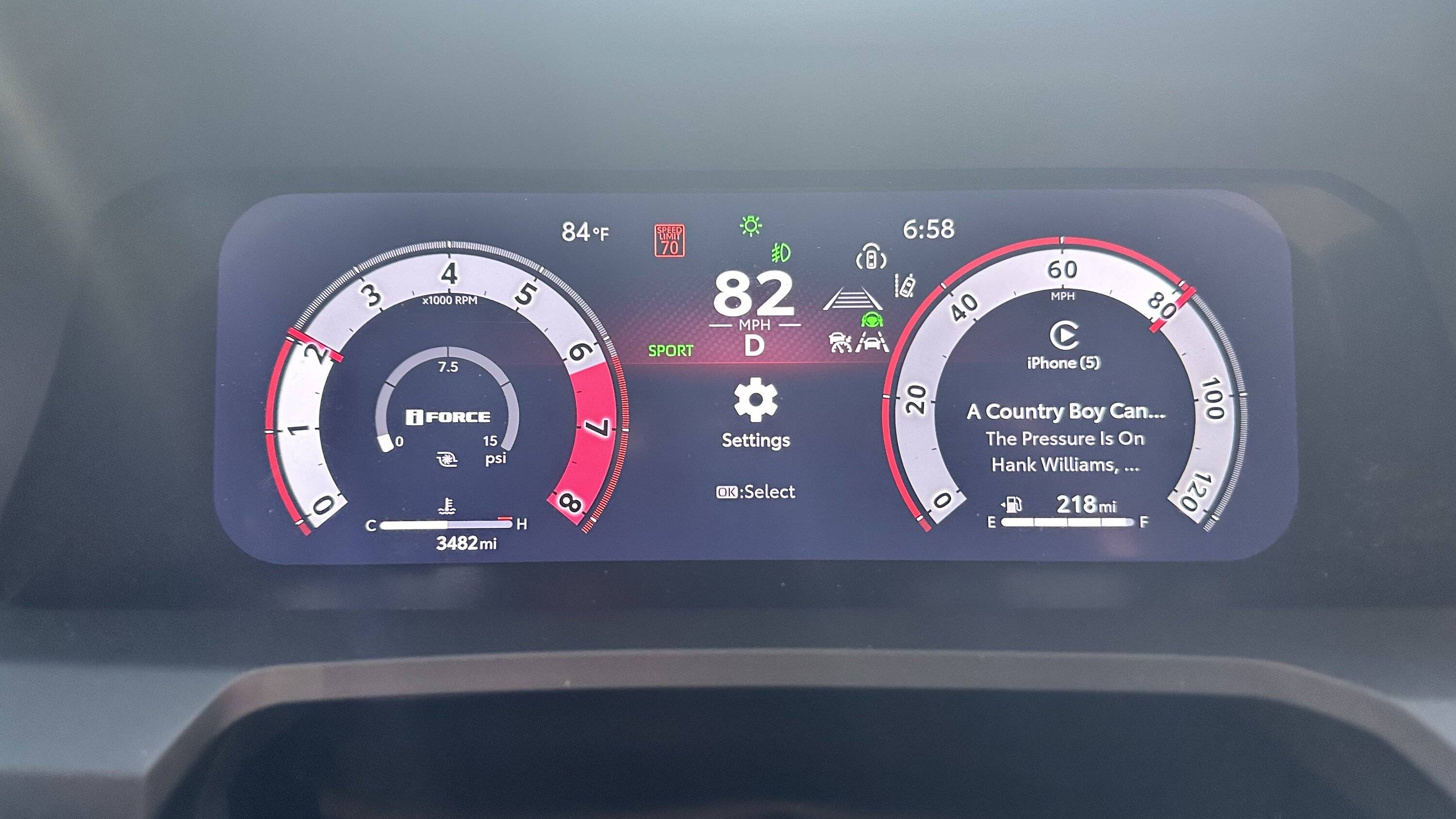

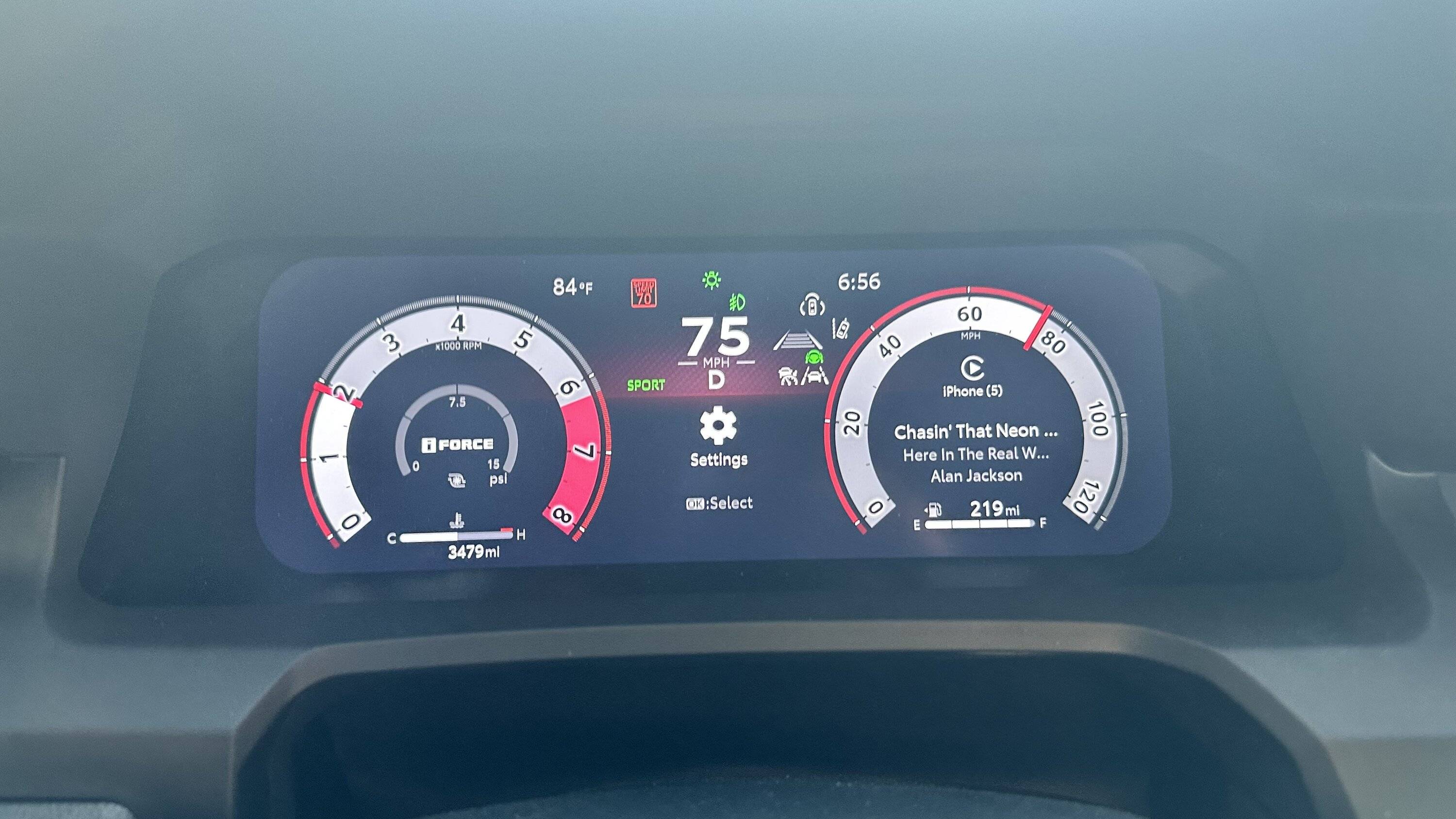

As far as RPM’s go, it isn’t as bad as I figured it would be and stays around 2k RPM at 80ish MPH on the highway, likely due to the extra 2 gears in the 8 speed transmission.

These are 20” wheels?

Right amount of poke in my opinion, something I would like to get. Planning on getting the same tires but 35x12.5. I'm worried that the Method 305 in+25 offset with 12.5 tires might make the poke a little more than I want.
