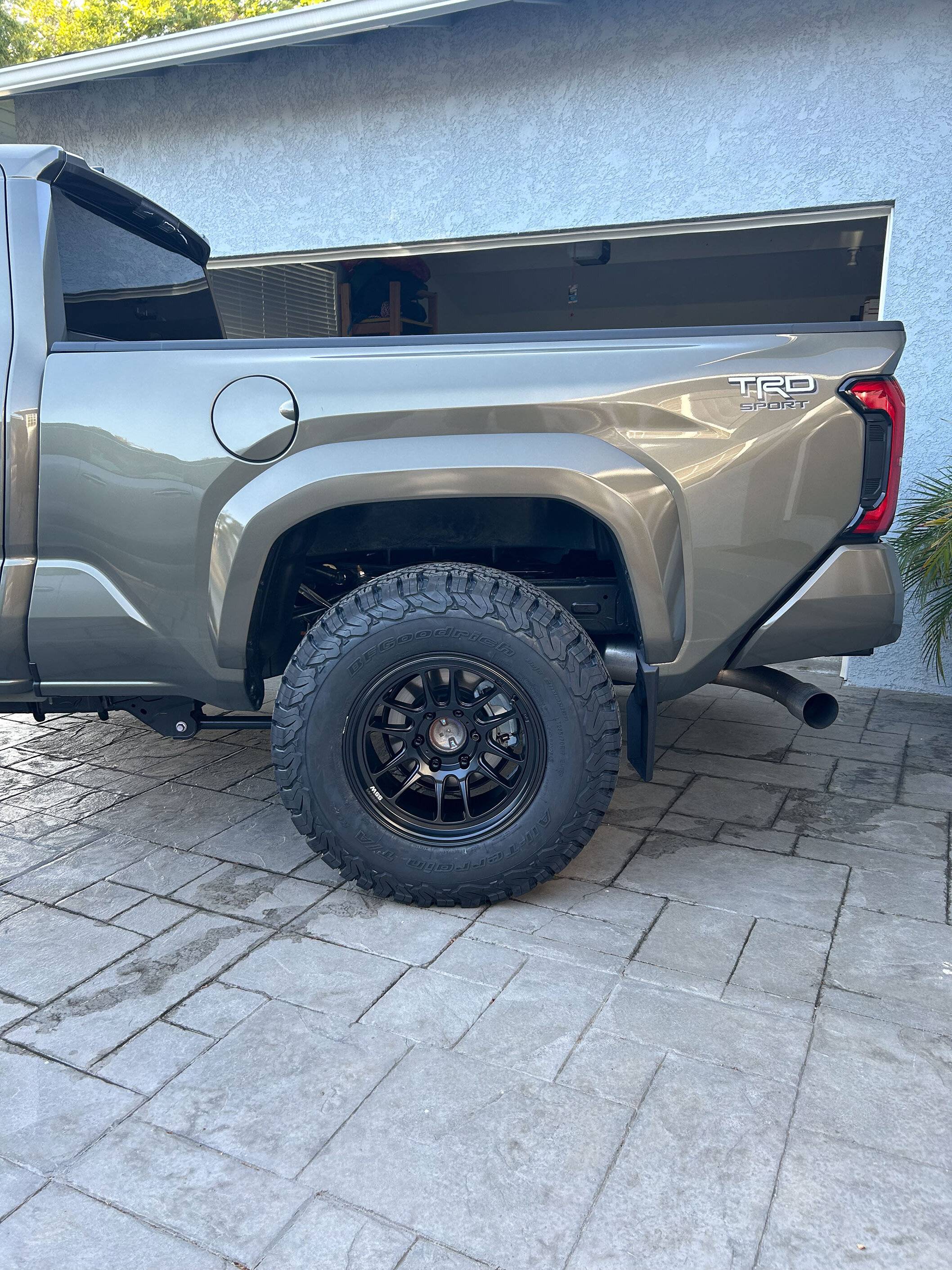

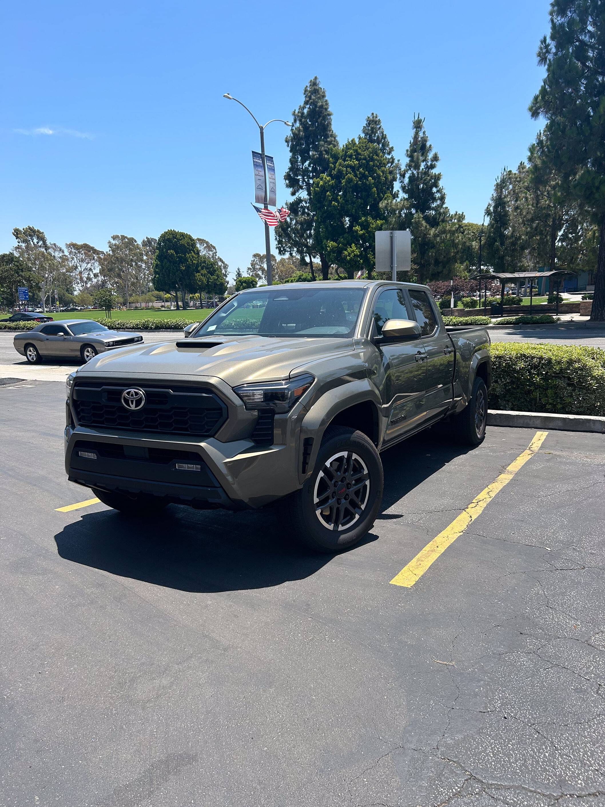

Placed a deposit at my local dealer in February and it finally came in May. Previously had a 2nd gen but excited to be back in a Tacoma.
Instantly had to remove the air dam as soon as I got home and been in love with the Bronze Oxide since. Went with the 4x2 because although I appreciate it, especially in California, I dont see the absolute need for a 4x4.
2024 Tacoma 2024 Oxide Bronze TRD Sport Long Bed - 17" SSW Raptor Wheels + BFG 285/70/17 KO2 IMG_3974

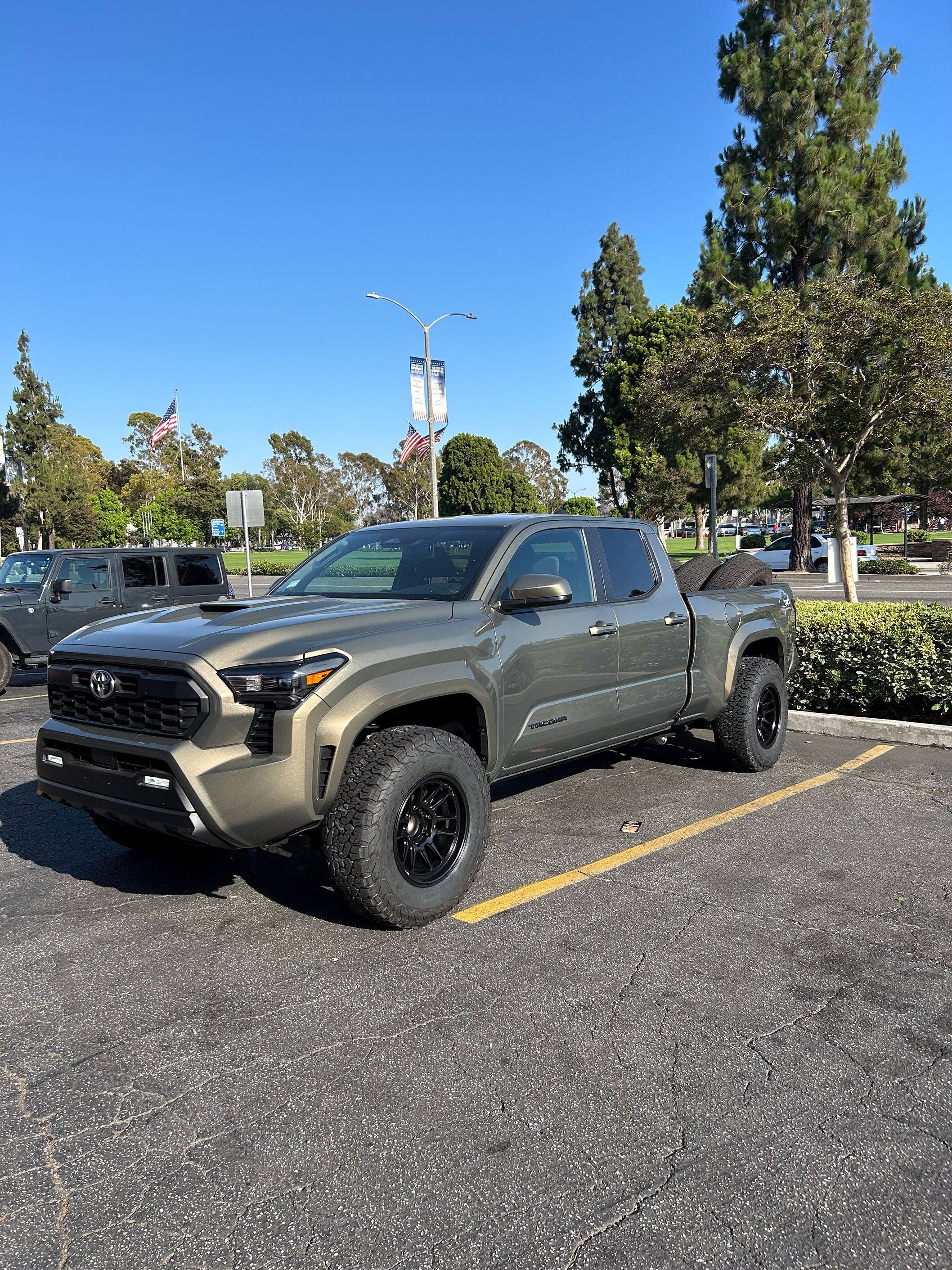

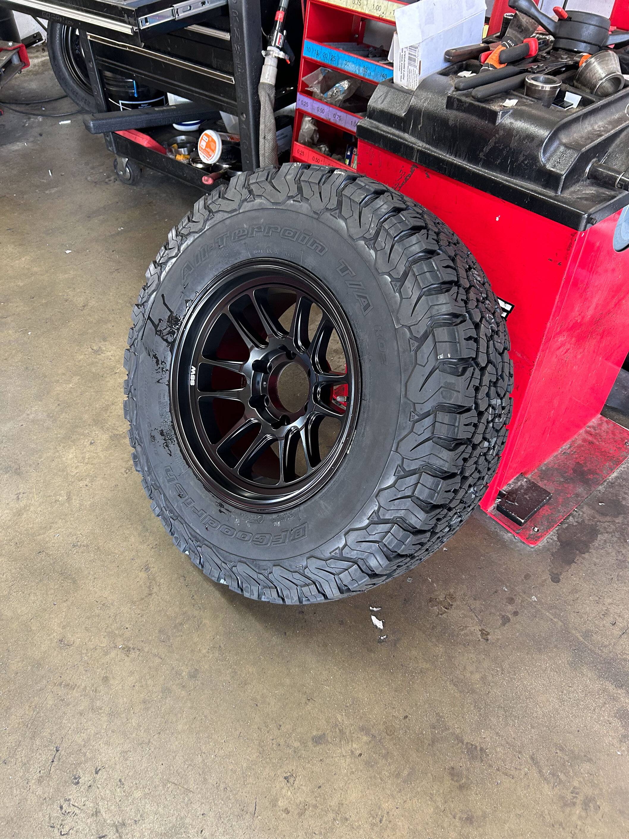

Recently got SSW Raptors 17X9-12 wrapped in 285/70/17 BFG KO2.
Overlooked this setup and didn't realize the width of the wheels and now im rubbing on wide turns :facepalm:
I've got the Westscott Preload Collar Lift Kit on the way so there's hope.

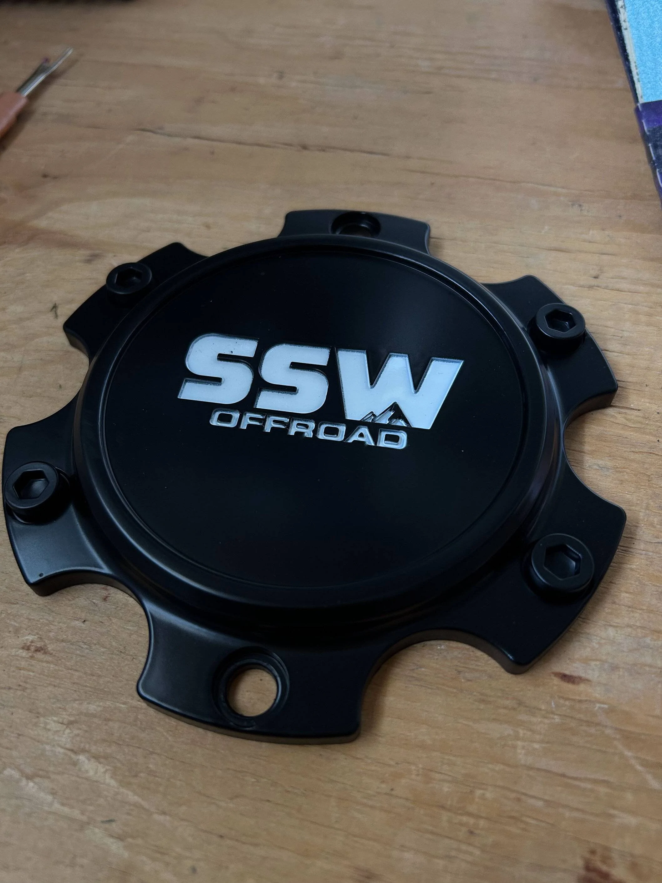

Also to not go with the SSW Center Caps but now it just looks unfinished. Was considering placing vinyl to cover the logo or just spray painting it black to call it a day. Anyone have any other suggestions/recs?

Sweet looking ride. The Westcott preload collars will eliminate scrub with those great looking wheels. A word of caution, if you travel gravel you’ll need to incorporate front mud flaps or your paint will pay the toll.

I thought 285/70/17 would fit without rubbing. Is it that combined with the offset or have i been misinformed about 33" tires ?
My calc says thats 32.7"
I would plastidip those center caps
It isn't the wheel width, it's your offset. 33" tires will clear by 2" in all directions unless you get an offset that hangs your tires halfway out of the fenders.
