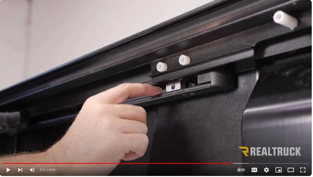

I installed my RetraxPRO XR last night. There were a few gotchas that made it take a lot longer than necessary, so hopefully, this post might save someone else some time.
First, don't follow the installation video for the 2022 Tundra that's on the RealTruck product site. Or at least, watch it, but also download the RetraxONE/PRO Tonneau Cover Tacoma iSheet instructions. At 5:11 of the install video, I realized that my kit did not have the white spacers that you see here:
2024 Tacoma Retrax Pro XR Retractable Tonneau Cover Installed on 2024 Tacoma 1728061267952-h2
That's when I realized these instructions aren't exactly the same as for the Tacoma, so I downloaded the instructions I linked above and found that I had actually needed to install a different aluminum spacer on the rails first before putting the whole thing on the truck.

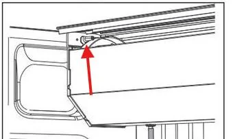

I made a second mistake where I didn't extend the cover far enough when attaching the side rails, and I only realized that after the assembly was on the truck and the cover wouldn't unroll. There's a small metal plate under each side of the retractable cover that needs to extend past this bump stop before you screw on the two side rails.
2024 Tacoma Retrax Pro XR Retractable Tonneau Cover Installed on 2024 Tacoma 1728068992201-o5
Anyway, the third time's the charm, and I finally got it all installed and am very happy with the cover.
