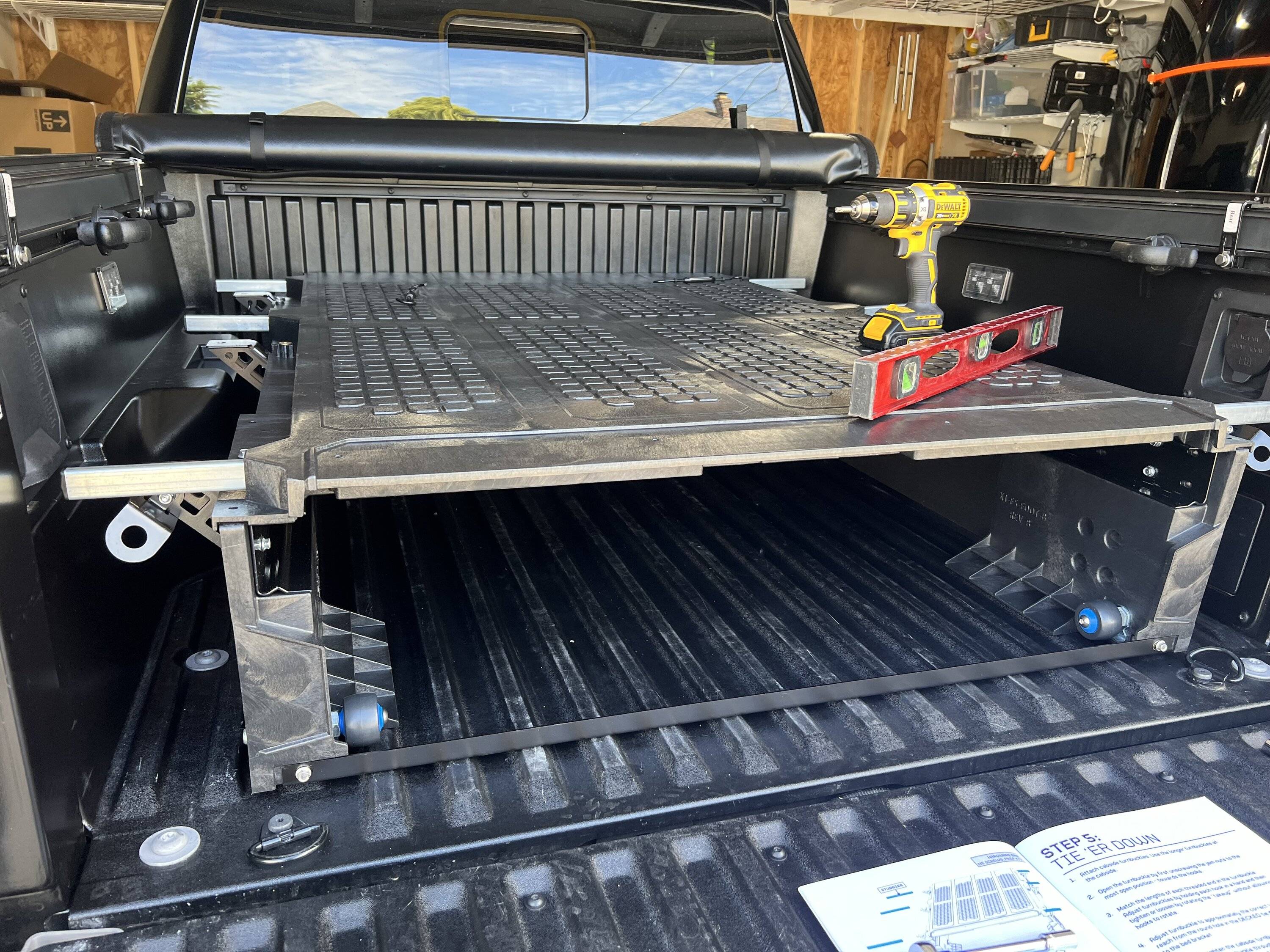

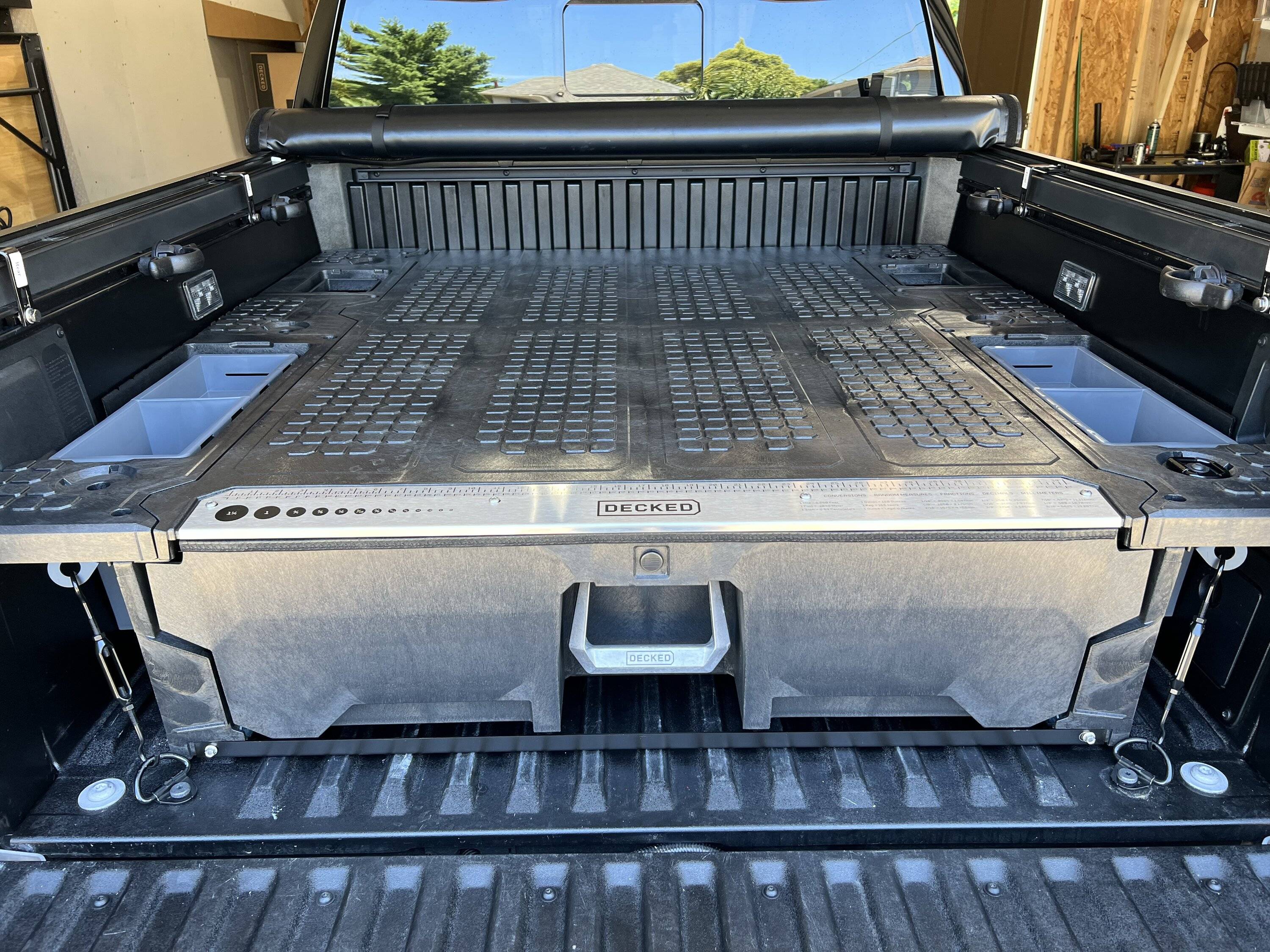

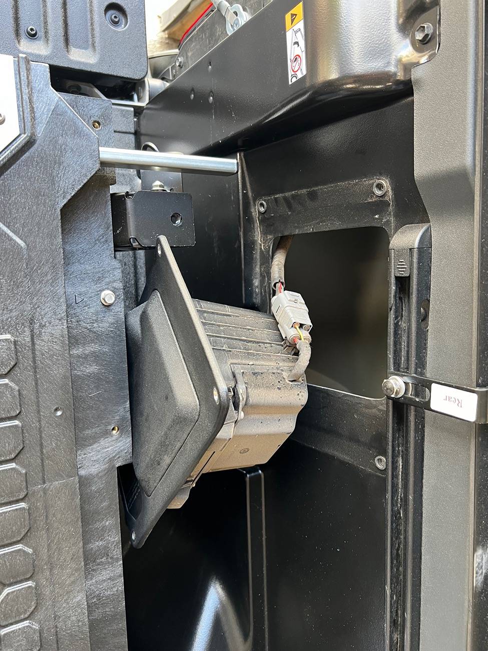

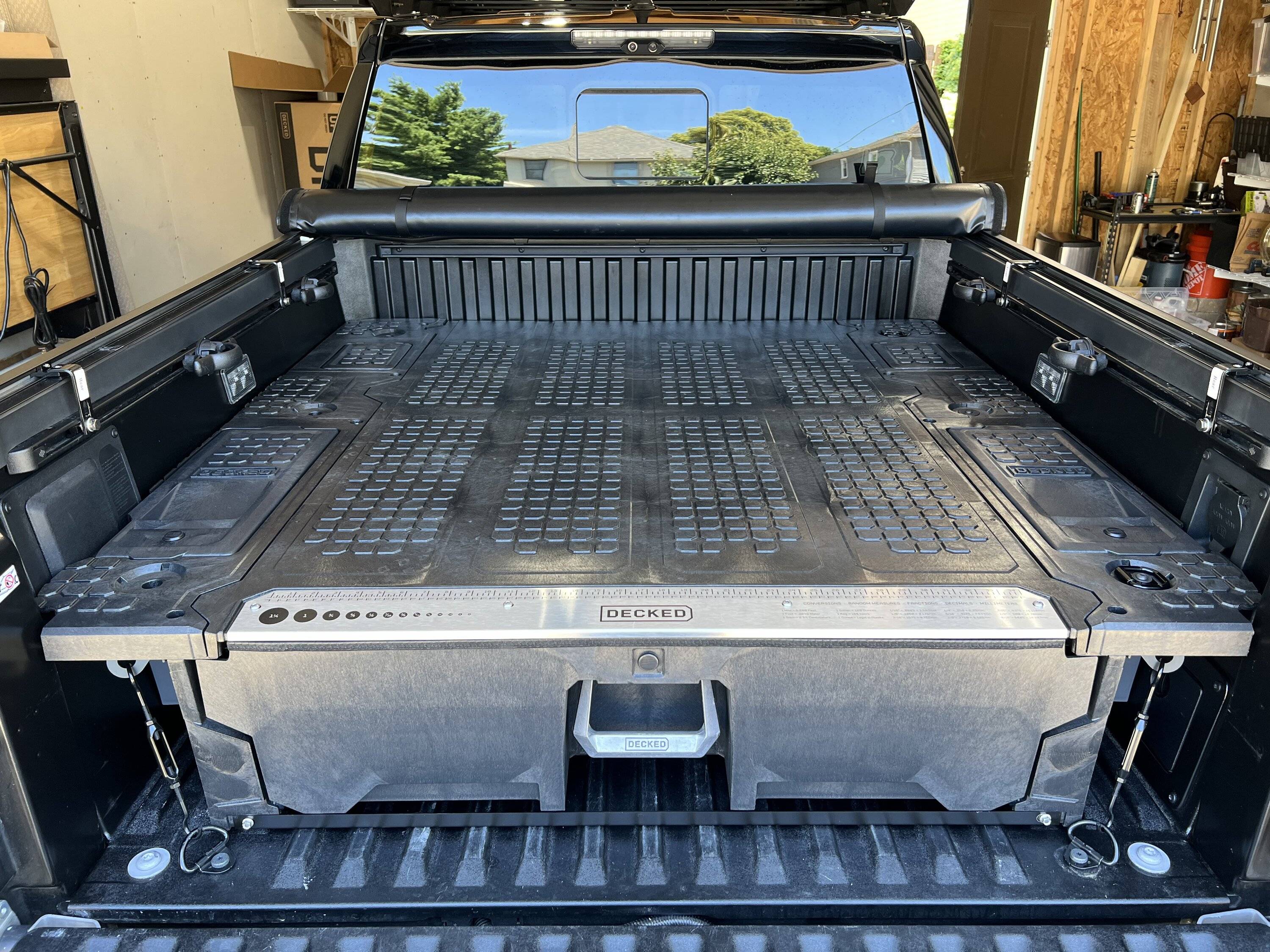

Today I installed the Decked Midsize drawer for my TRD ORP. I really like the larger drawer and storage bins that come with purchase. I can access the power outlet on the right, but need to modify the USB ports on the left to get access with the decked installed.

This is specifically for the 24 Tacoma with Power Bed Accessory. The instructions included have you buy some magnets and glue to modify the cover to the USB ports so I can access them. The deck has a cut-out on the right side so the plug door can open freely with no issue or modification.
I read Decked's instructions for modifying the USB port, and it looks relatively simple, but I won't know until I start taking everything apart. I'll capture some photos and post my thoughts.

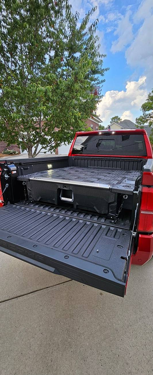

Is this the version specifically for the 2024 Tacoma or did you use a version for the previous generation? I ask because Decked told me the 2024 version isn't available yet because they're trying to resolve the USB access issue.
YT9 is the model for the 2024 Tacoma with the Power Bed Accessory. We installed ours today on our Sport Premium model.

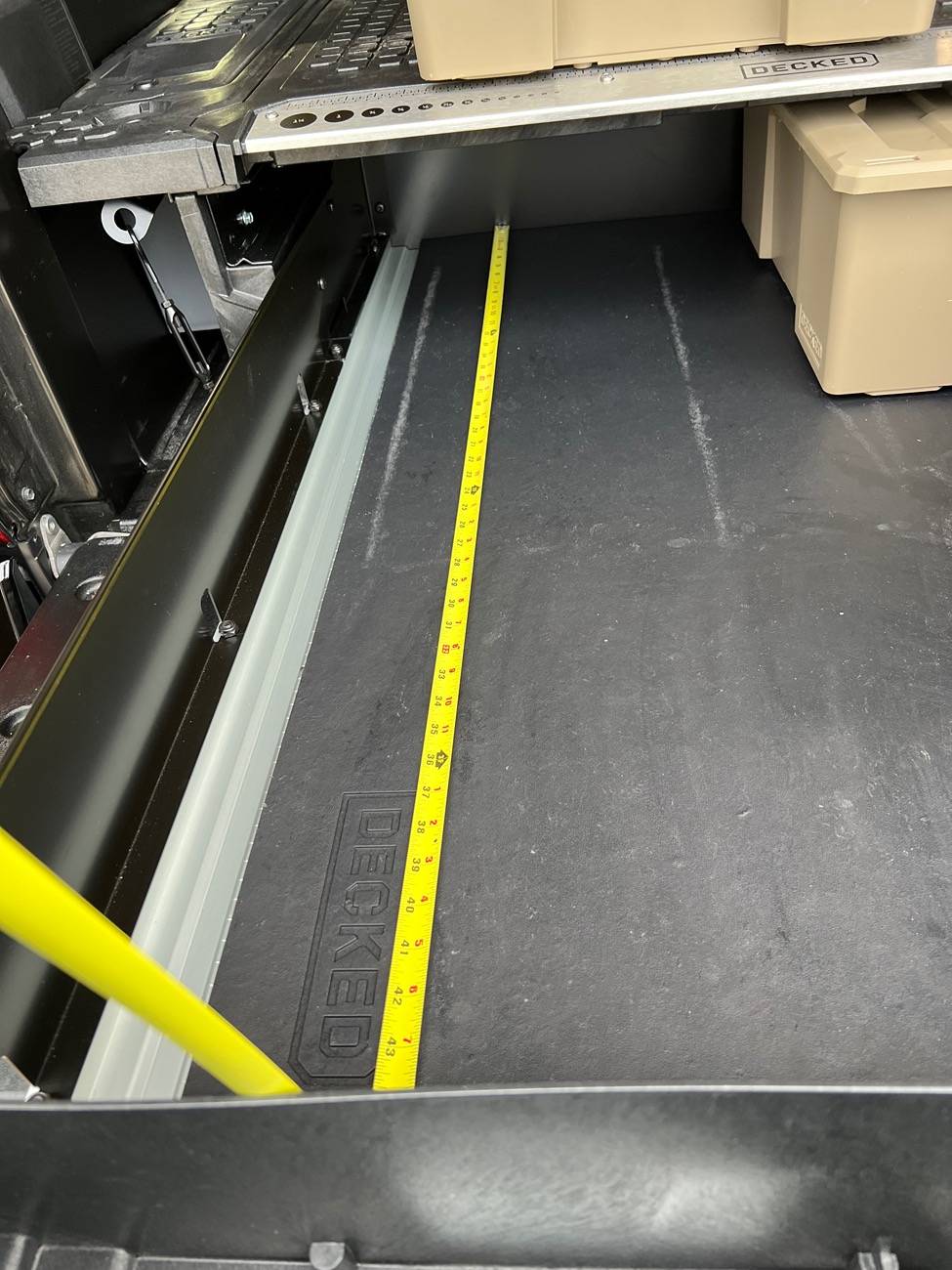

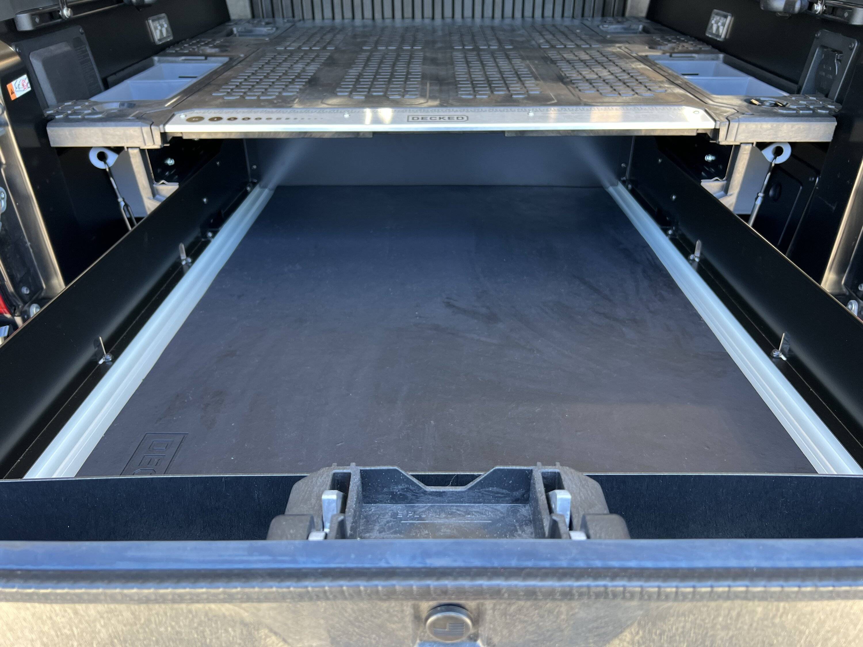

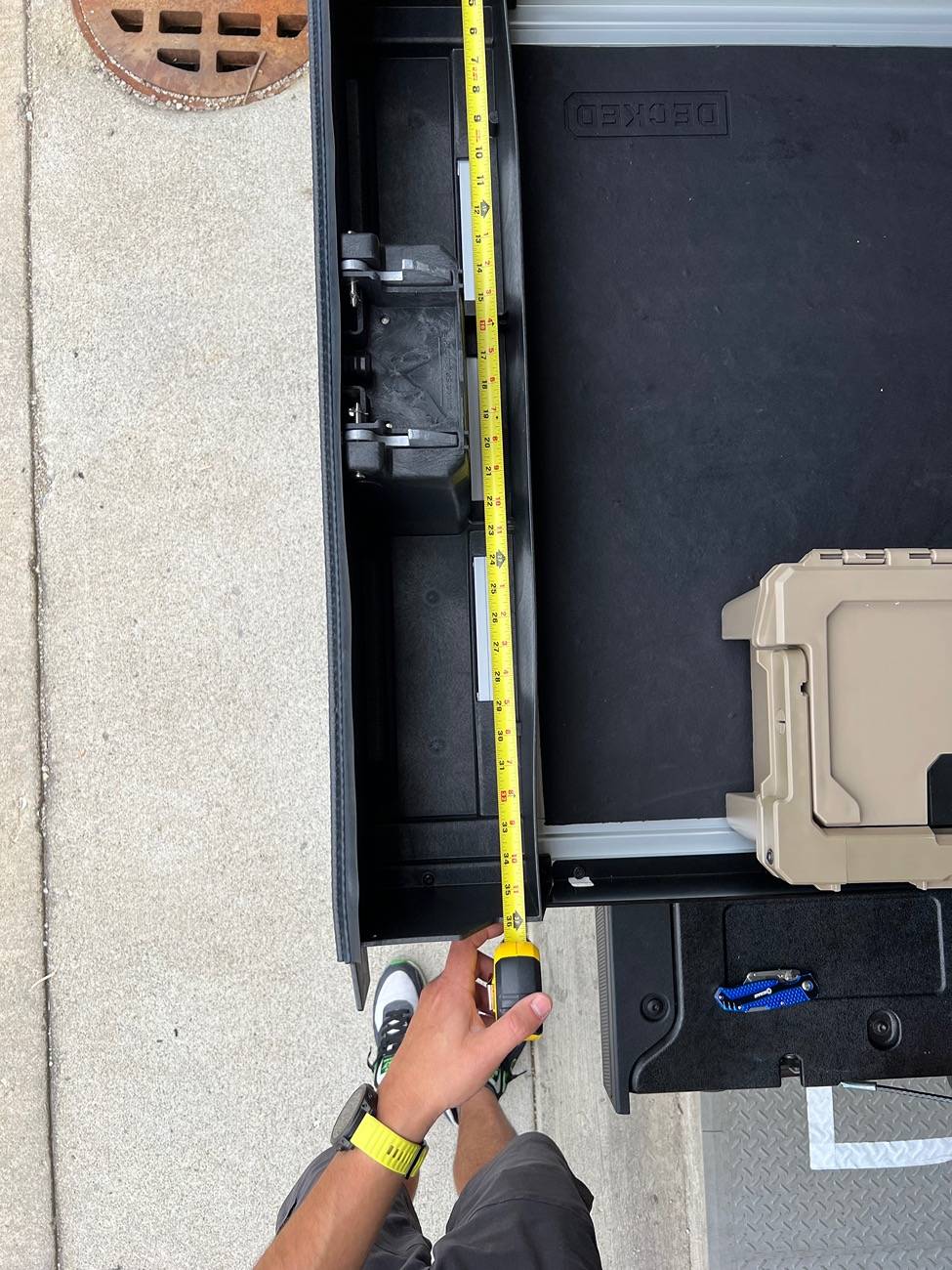

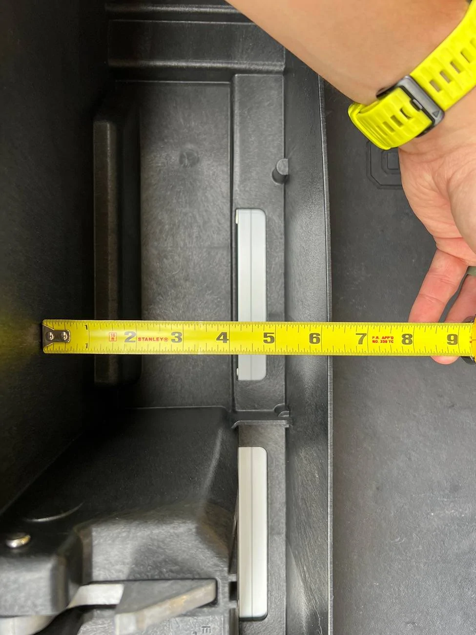

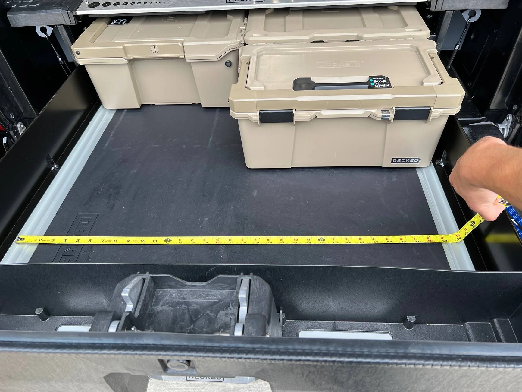

I have mine on order. Could you please measure the inside of the drawer from back to front when you get a chance and post it? Thanks for the info and great pics!
ok the midsize drawer is ~ 34" W x ~46" D x ~8" H. There is a little more width than what I captured here but the base where you can lay your storage bins flat is ~34".

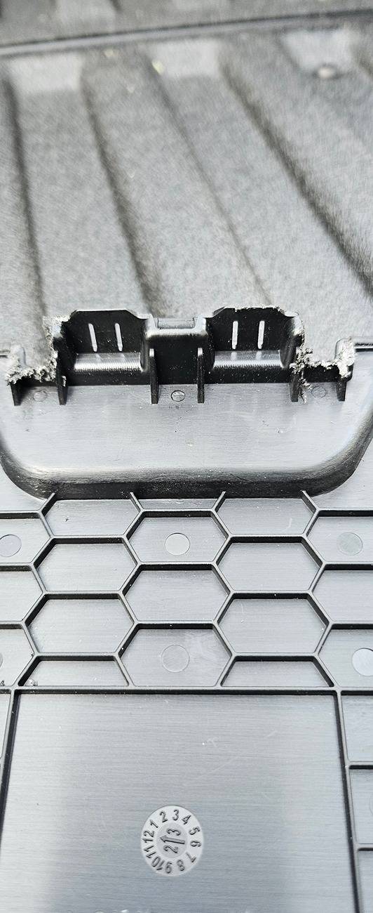

Hi all, Happy 4th! I hope you're having a good one.
I completed the USB/12V charger cover mod for the Decked system and wanted to just share some pictures. Overall pretty simple and straight forward process. I used a small hack saw to cut the cover, but think a Dremel Wheel would be a better tool. I also used 4 magnets on the cover instead of the 3 recommended by the instructions. Finally, I swapped out the D-ring tie downs with the Charvonia Designs ones, and swapped the handle on the drawer to black, to keep my "blacked out" theme going.
