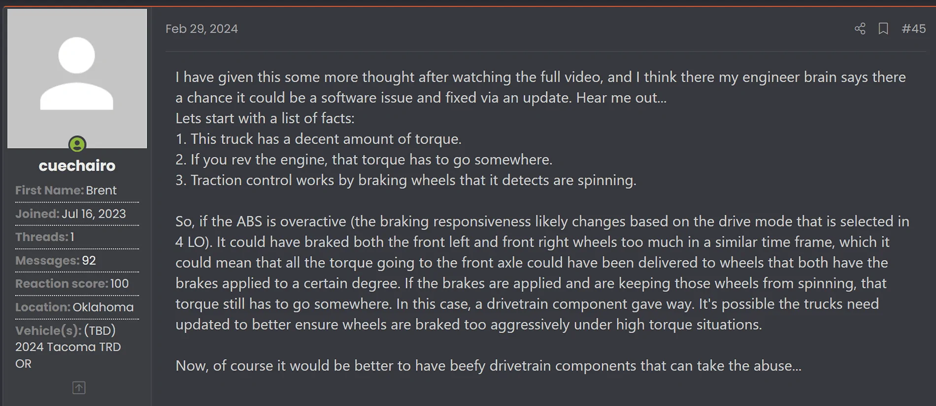

Well well, it looks like my theory back in February on what happened was correct (explained in the video around the 7:30 mark). TLDR, a combination of different factors led to too much torque being sent to that one wheel, and in that particular MTS mode, brake was applied too aggressively. Also as I expected, it sounds like they have a fix for this issue in software (12:50 mark), but it sounds like they do not have information yet on if it will be OTA or done at a dealer.
