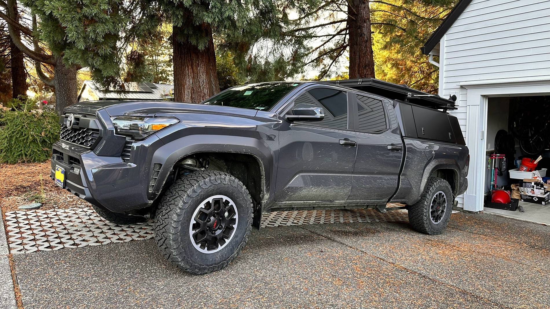

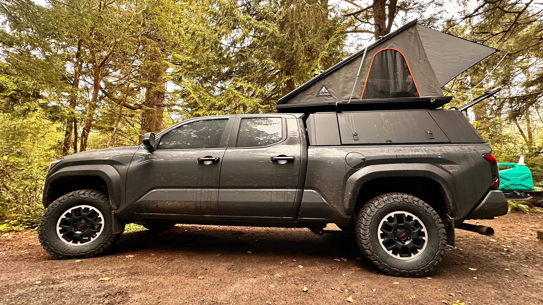

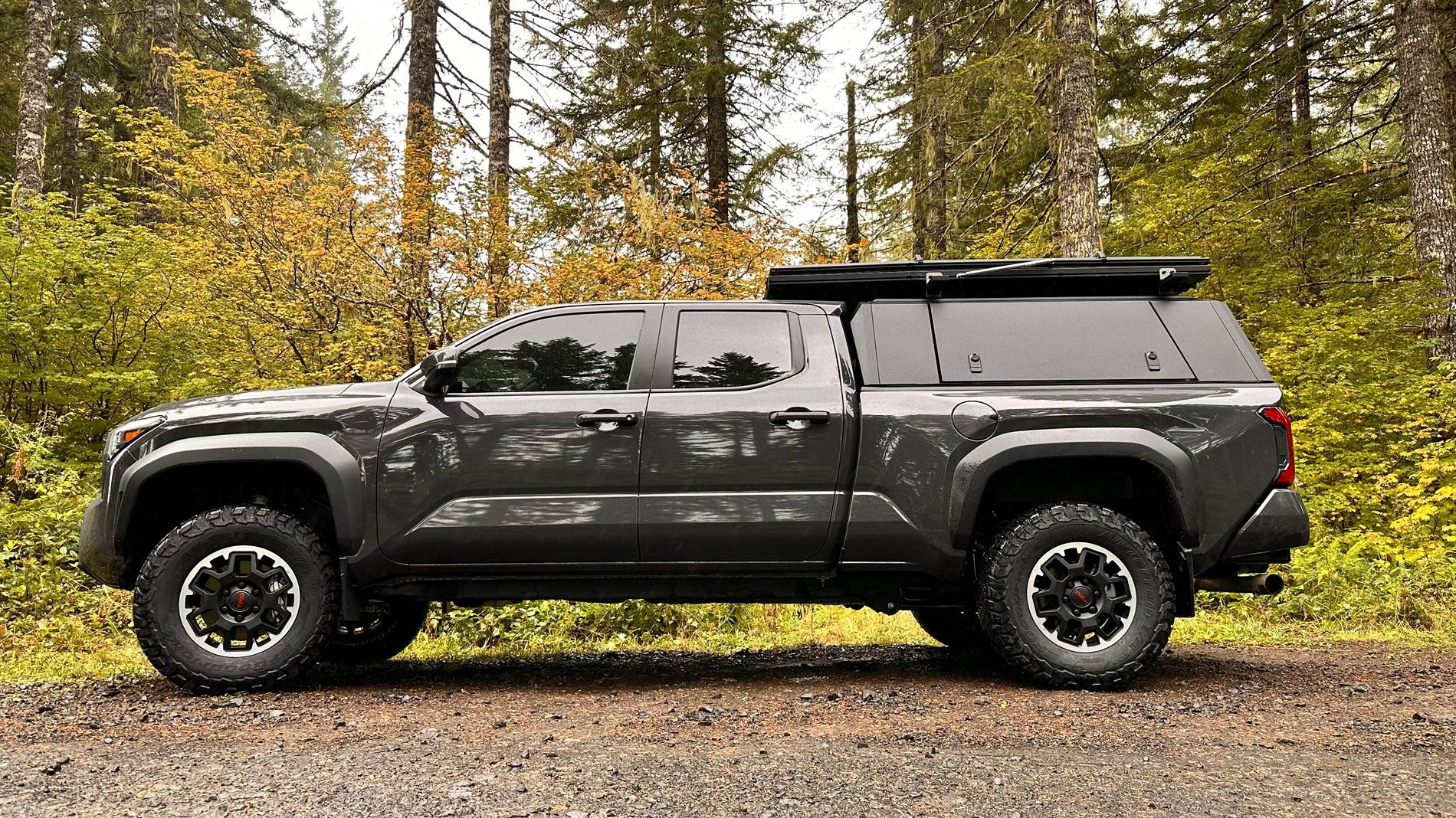

Got a little lift installed and slapped on some new shoes today.
Readylift 2.5" SST Kit: https://www.readylift.com/2-5-sst-lift-kit-toyota-tacoma-2024.html
BFGoodrich All-Terrain T/A KO3: https://www.bfgoodrichtires.com/auto/tires/all-terrain-t-a-ko3

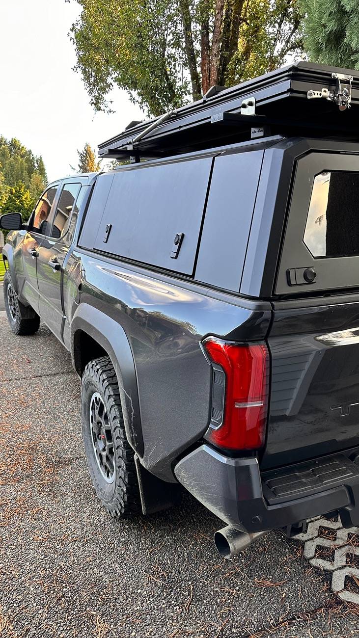

I wanted to add a little height, even out the stance and a little bit bigger tire. Overall I'm happy but with the Smartcap Evo Adventure and the rooftop tent there's a little bit of sag from the factory rear coils and it's a little nose-up.
I ordered up some heavier load rear coils from Dobinson's that we're putting in when they arrive, that should help with the rear end and should be my sweet spot.
2024 Tacoma Installed Readylift 2.5" SST Lift and BF Goodrich K03 285/70R17 on stock TRD Offroad Wheels IMG_7726
add the timbren bumpstops in rear and the peak design 1 inch coil lift... problem solved!
RandomGuyInPNW
Sep 25, 2024
Tualatin
2024 Tacoma TRD OR
I got the Timbren TORSEQ3 bumpstops but haven't put them in yet. The Readylift kit has a 1" coil lift in the rear.
I didn't think the Timbren added any physical height, just a softer bump and support when you have a load in the bed, no effect on your daily drive setup.
