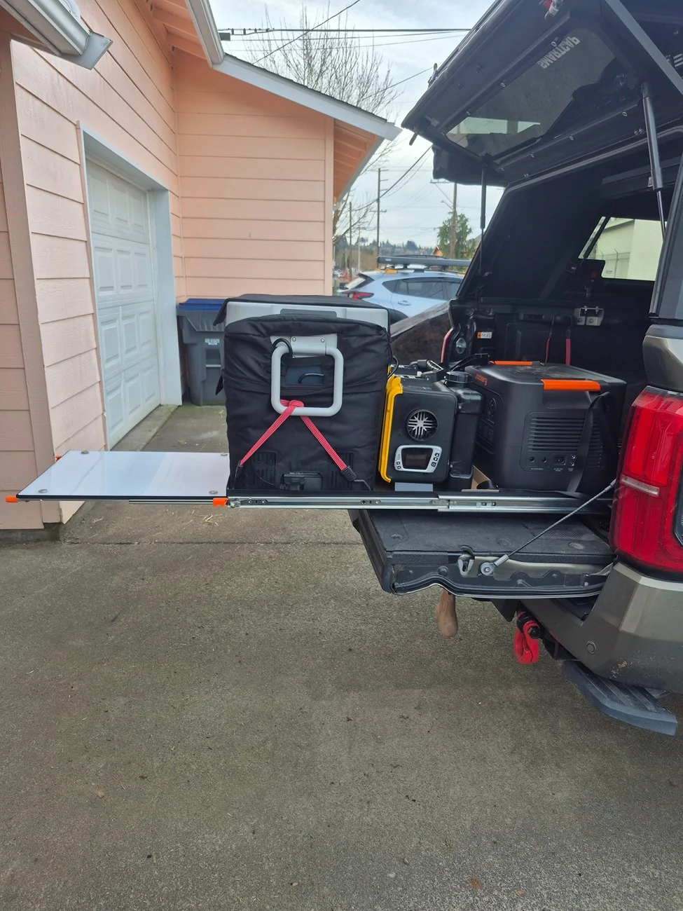

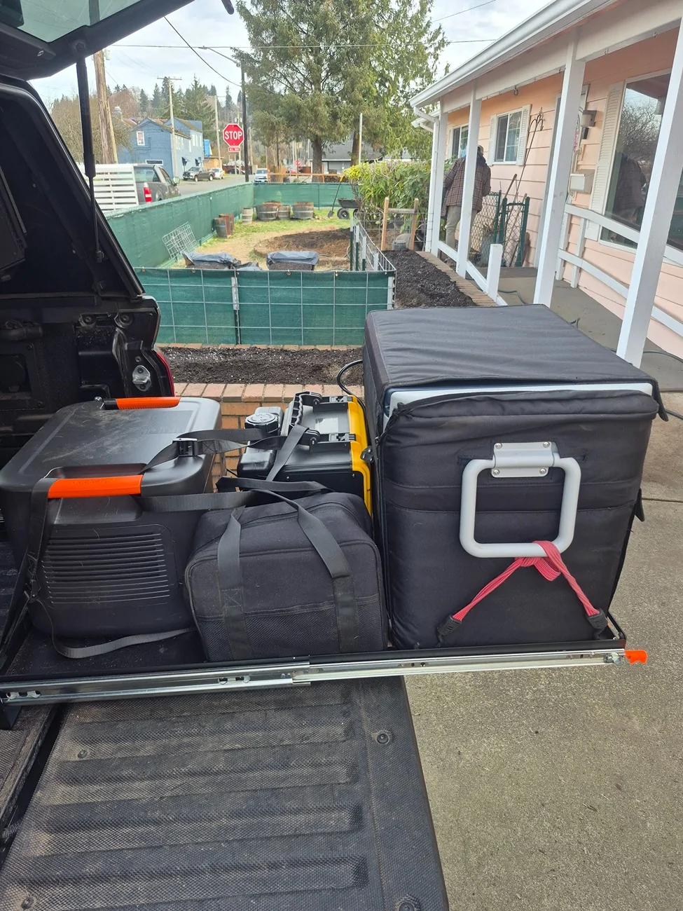

Absolutely love my new modification.
XL All Top bed slide with cutting board.
Mounting hardware was included, but I went a different direction since I dont have arms long enough to try and put nuts and washers on underneath while holding the bolts on top, lol.
I marked the holes and drilled them out to the appropriate size for a 1/4" split riv nut with 1/2" grip. Install the riv knuts and then mounted the bedslide, took me a couple hours, but I'm O. C. D. I'm sure it could be done much faster.
