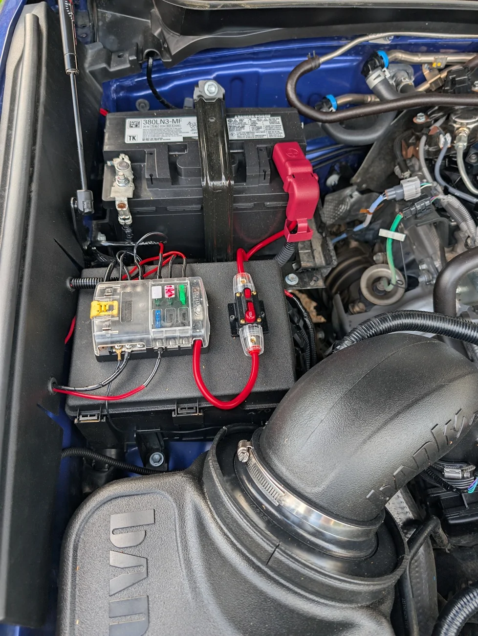

And you ran all that to the battery ?

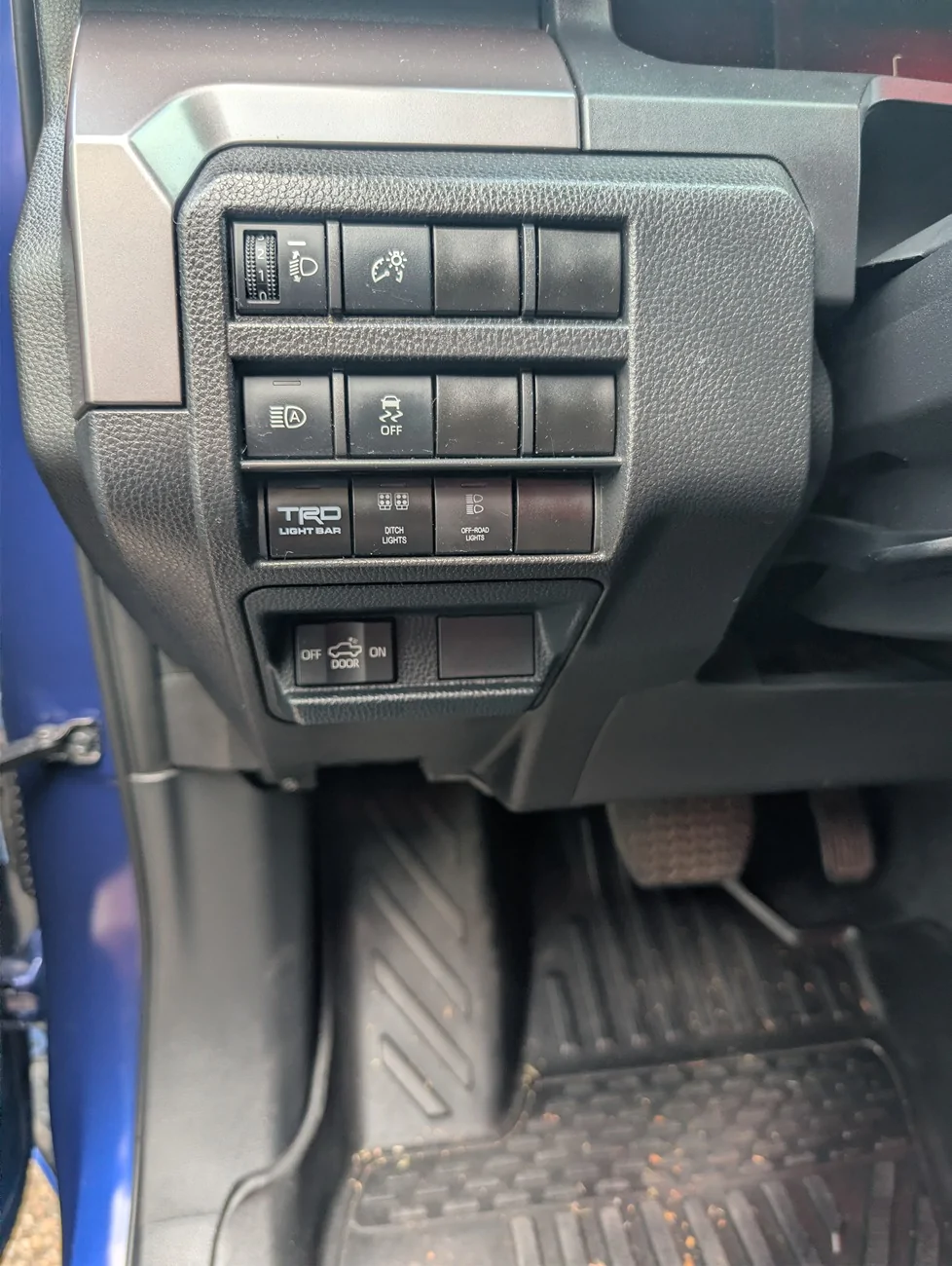

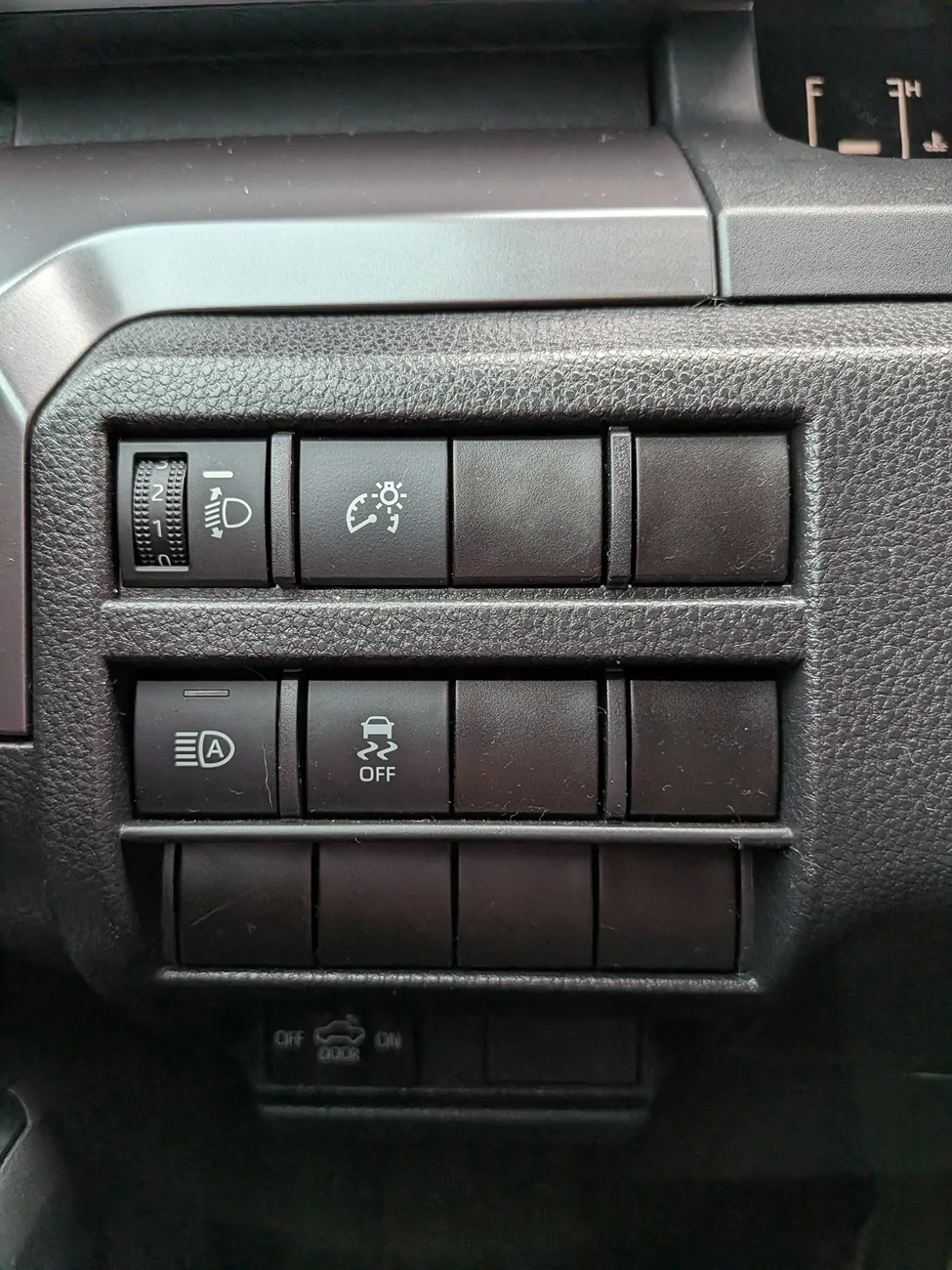

Do those factory squares for the button on your SR5 just pop out from the back ?

I'm running a power distribution block, secured on top of the passenger side fuse box, with an inline isolation switch. I have a single heavier gauge power from the battery and a heavier gauge ground from a factory ground located on the passenger fender.
All of my accessories, including the sub, are ran through the isolated distribution block, all fused independently.
The blanks near the steering wheel all pop out pretty easily but you need to pull that whole panel to access them. You can also use the blanks by the gear selector.

Pro level install!
I want to do that because it looks clean and safe. I wonder if I need it with just a sub and Lightbar ?
Thanks for sharing man! I appreciate this.

Thanks amigo - wiring could be cleaner but I'm not done adding/removing yet so I'll clean it all up in the future.
I'd go ahead and set up the distro block now just in case you add additional powered accessories in the future. Just keeps everything manageable.

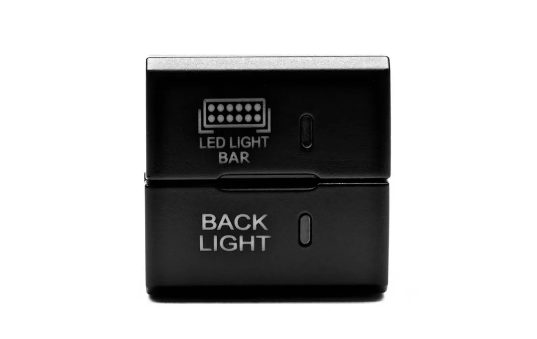

The other thing I'm wondering, for those more knowledgeable than me, since the diode Dynamics harness comes with a 3 position rocker switch (I'm assuming LED, Backlight, Off) then would the replacement switch need to be like this ? Or just the standard TRD Grille square and then you cycle through ?

Unless I'm missing something, looks like they moved to a 20" ? I guess it doesn't actually say in the specs, but found a post by them for a "new 20 inch Lightbar" on the forum and when I click it, it's the same bar I was looking at
maxx075
1,021
1,209
FL
Looks like they may have updated the light bar, I believe they used to have an 18" that fit, but the next size up may have been a little too long and required some trimming of the sides. The one I see on their site now looks like it fits and has the brackets as well. Provided I'm looking at the same one.
