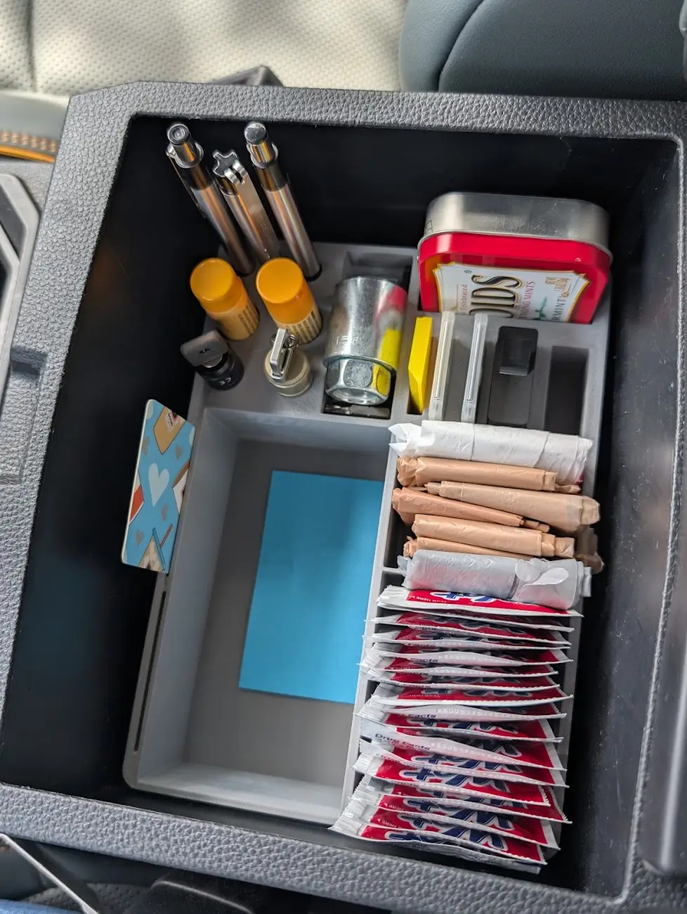

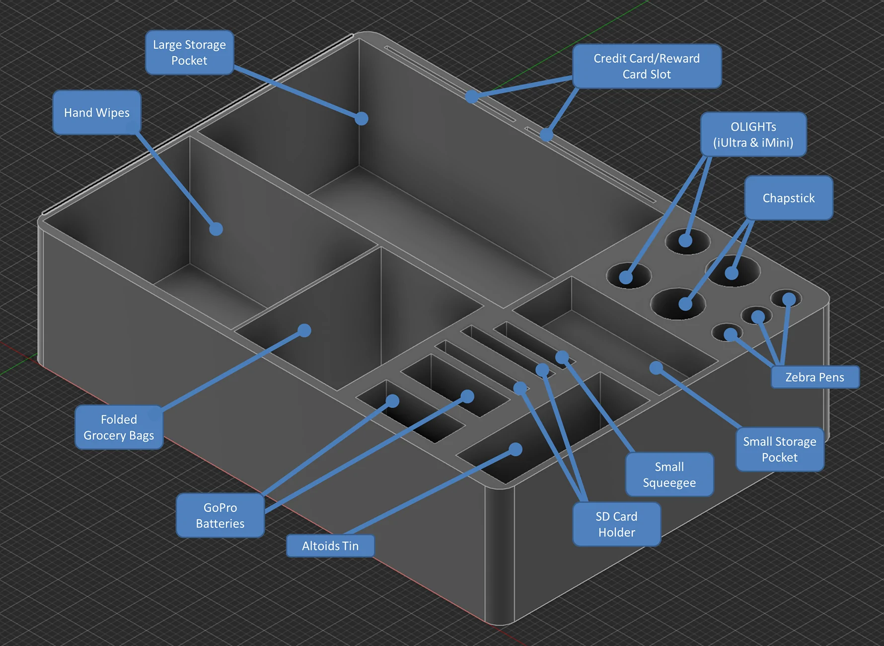

I finally got tired of an unorganized center console and figured I would do something about it. Idea is pretty simple, I took out the things in my center console, measured them up, made a holder for them in Fusion 360 (STL file attached), put it through a slicer, and printed on a 3d printer. (Many libraries in the US have 3d printers if you don't have one yourself) Feel free to take the STL file and modify it however you would like. Ideas for potential future editions, AAA/AA battery slots, remove the OLIGHTs and put in a larger flashlight, remove GoPro battery/SD card slots and put in something else (spare magazine?), longer horizontal slot (perhaps take out small storage pocket) for cell phone.
2024 Tacoma Center Console Organizer 3D Print DIY (STL included) 1789595038484-2s
The fit is ok... There is enough room on the side to store the longer tow hitch pin. Next project will be for the 'secret' compartment. I plan on having that hold the locking lug key plus a few tools.

Further improvement could be chamfering the bottom edges of the large and small storage areas and raising the floor of the chapstick area about a quarter inch... But after several iterations, I'm happy with what the result is (for now)
But thanks! The design was about storing as many things vertically as possible to avoid wasting the limited floor space as much as possible. Taller items further away from driver seat to be easier to grab from that position
