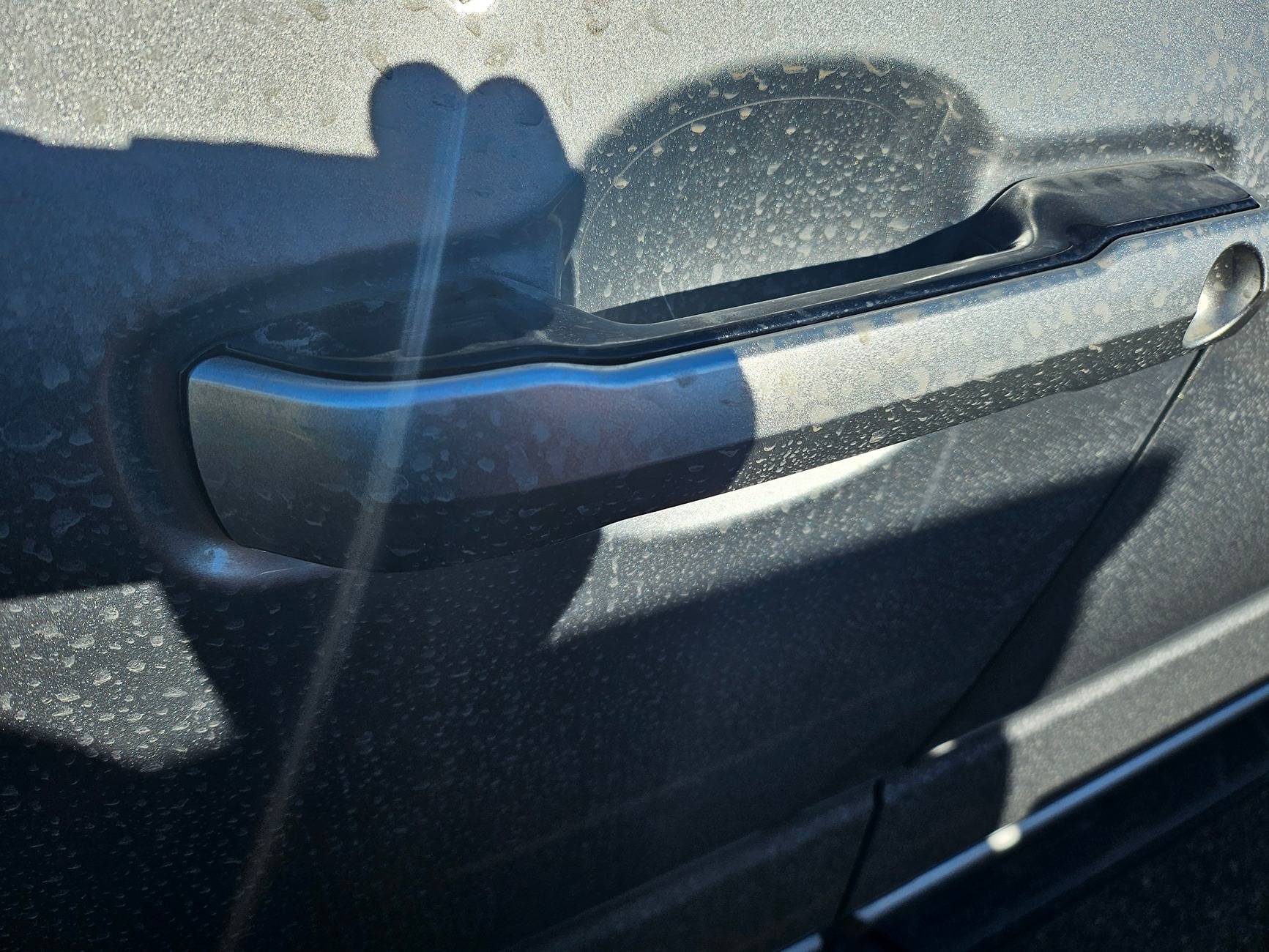

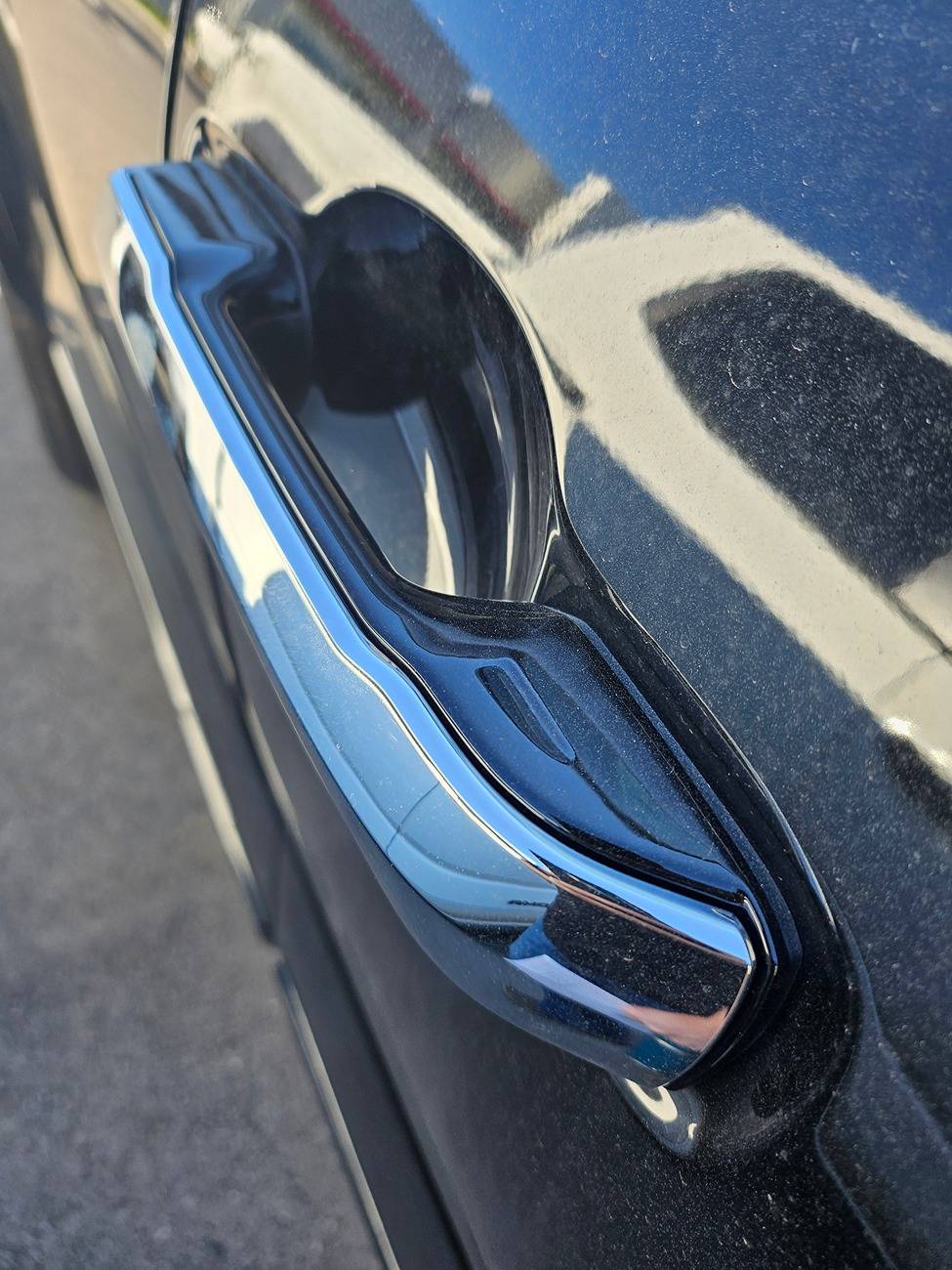

Hi. Has anyone figured out how to swap the limited handles out for body color OEM handles?
heat , hair dryer , heat gun (but b careful over kill) stock covers are held in place with a hot glue substance
Rave has them in gloss black plastic & u can have them painted in any Tacoma color .
heat & pry off , leave the glue the new covers come with 3M adhesive stripes like the badges do & stick to the glue , easy peasy
the Rave look exactly like OEM Toyota parts right down to how they are packaged and probably are from the same manufacture

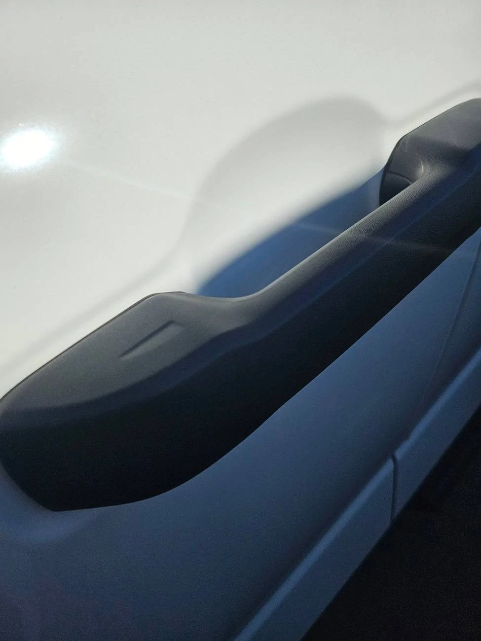

i had my wrap guy pull my silver ones & stuck on the new black ones . I was there when they did it
couldn't see how they just covered the stock silver as the new blk Rave & silver stock were exactly the same part except for color . thick & formed
not like a thin logo badge black cover either
again they look like the exact OEM door handle part

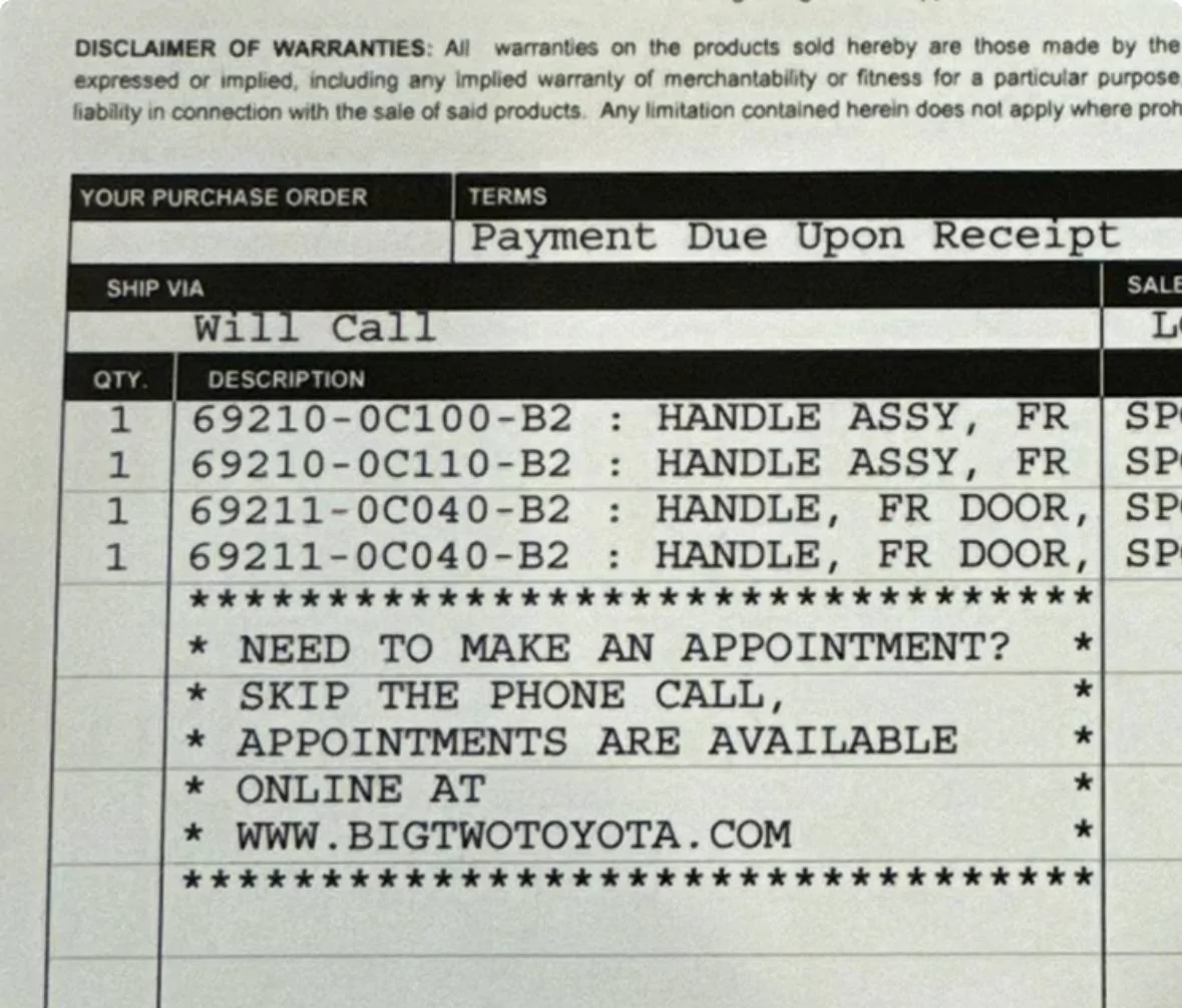

Did you end up swapping the door handles? If so, what were the part numbers for all 4 door handles?
