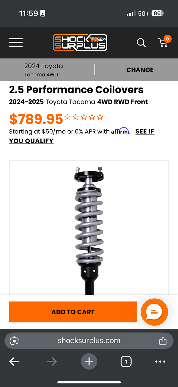

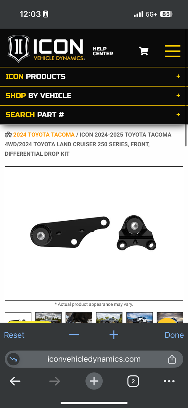

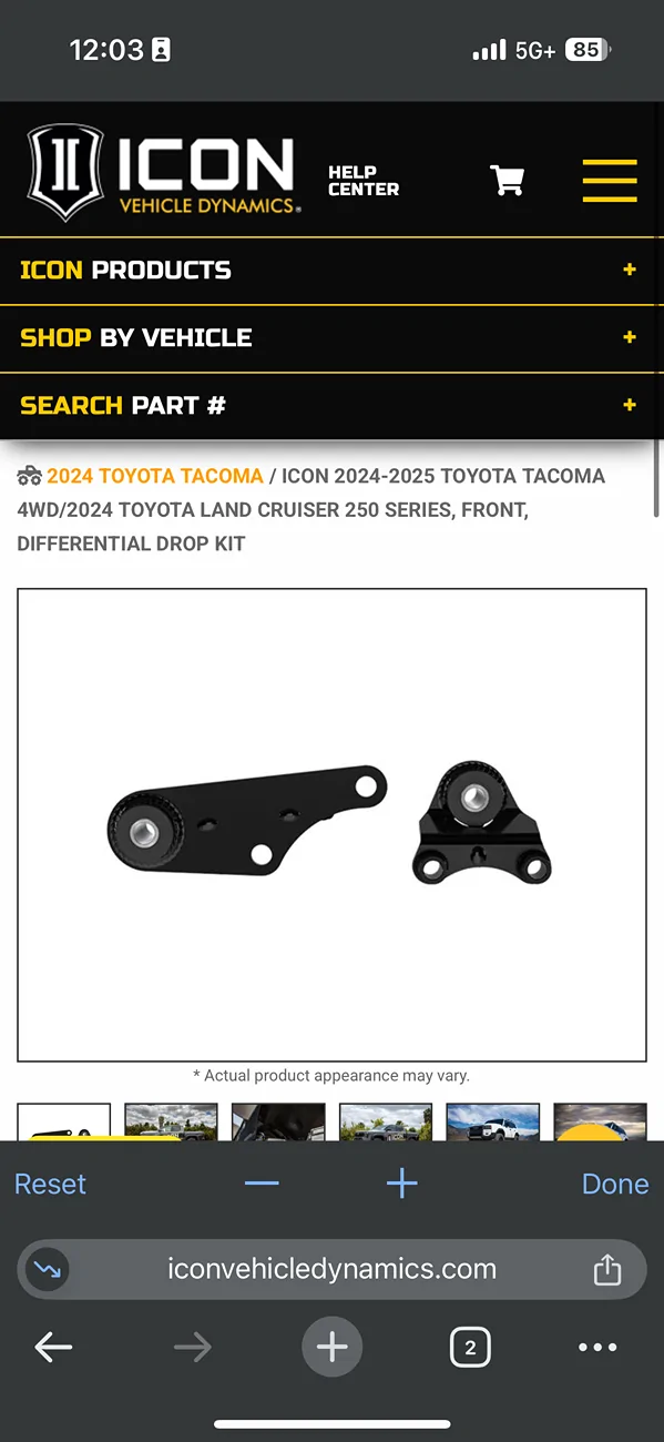

I want to level out the front 1-2” with longer fox 2.5s. Do you think the diff drop kit from icon would be necessary to reduce needle bearing stress with the cv axles? Also are UCAs needed as well?
No need for the diff drop, also there have been several member that installed the Icon diff drop and had to uninstall it because it caused vibrations.
You should consider the ECGS needle bearing delete kit when installing the lift. You can do it later but you’ll save time doing it while installing the coil overs.
https://www.tacoma4g.com/forum/threads/front-vibrations-from-lifts.13261/#post-165767
