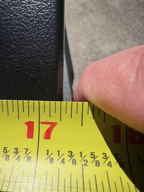

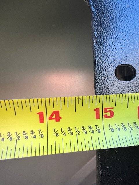

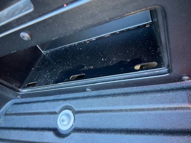

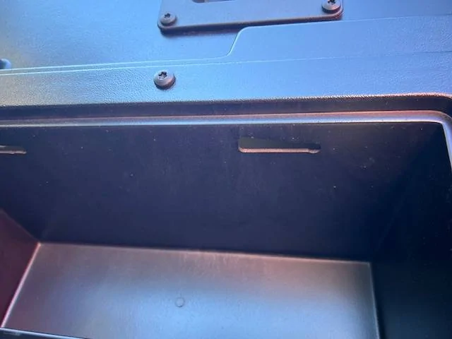

Here are the measurements for the storage compartment (if equipped) , keep in mind that the top and bottom depths are not the same. The cover measurements also shouldn't be used as there's a ridge it sits on unless you plan on cutting the box out.
Let me know if you require more precise measurements and I can great a jig to fit in there.

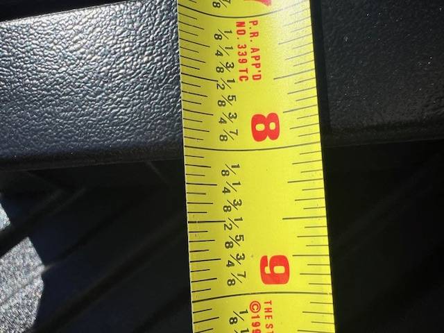

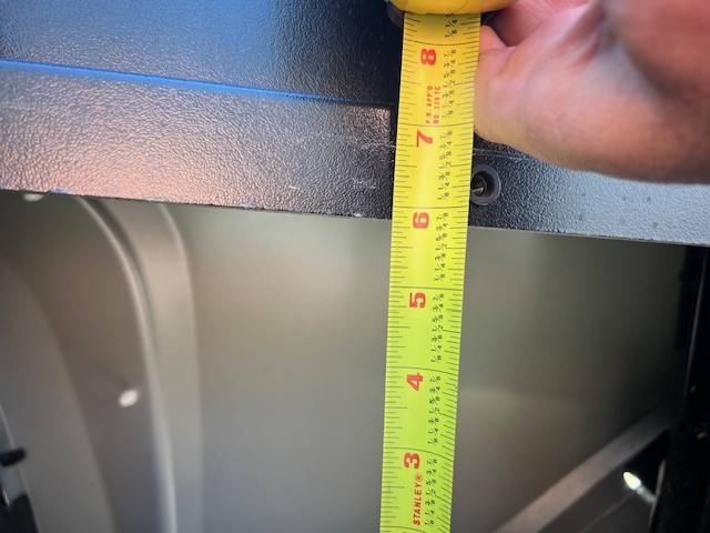

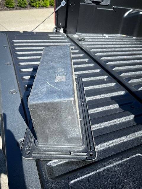

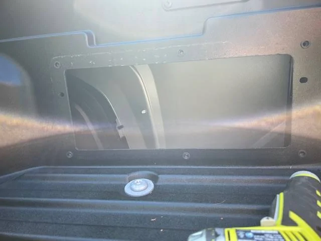

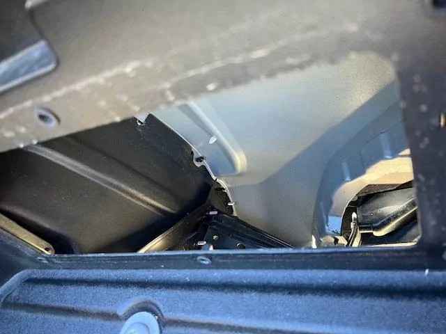

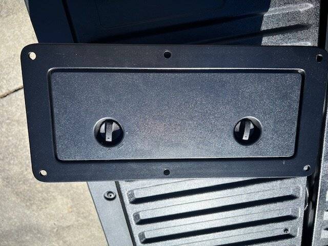

Here are some more pictures with the box removed. The last couple are measurements of the edges of the unit.

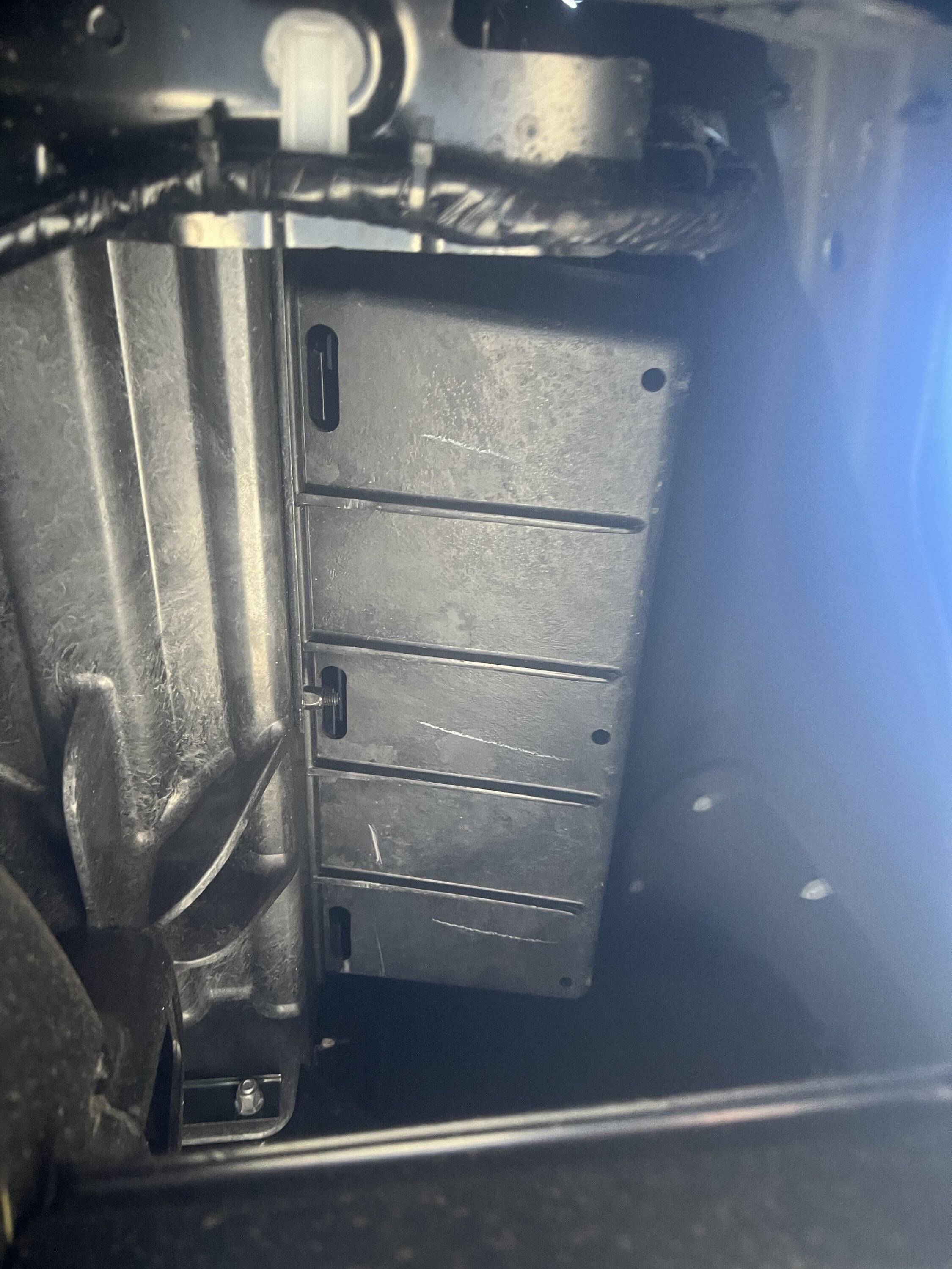

I agree, you could probably install one pretty easy using nutserts as long as you don't mind cutting into the bed. Don't forget to check the other side to make sure that there are no wires back there.

Haha. Ya good point. Would be just my luck that the main can-bus runs there or something stupid- lol . I think you can look up there from the bottom. I'll have a look before I get the Sawzall

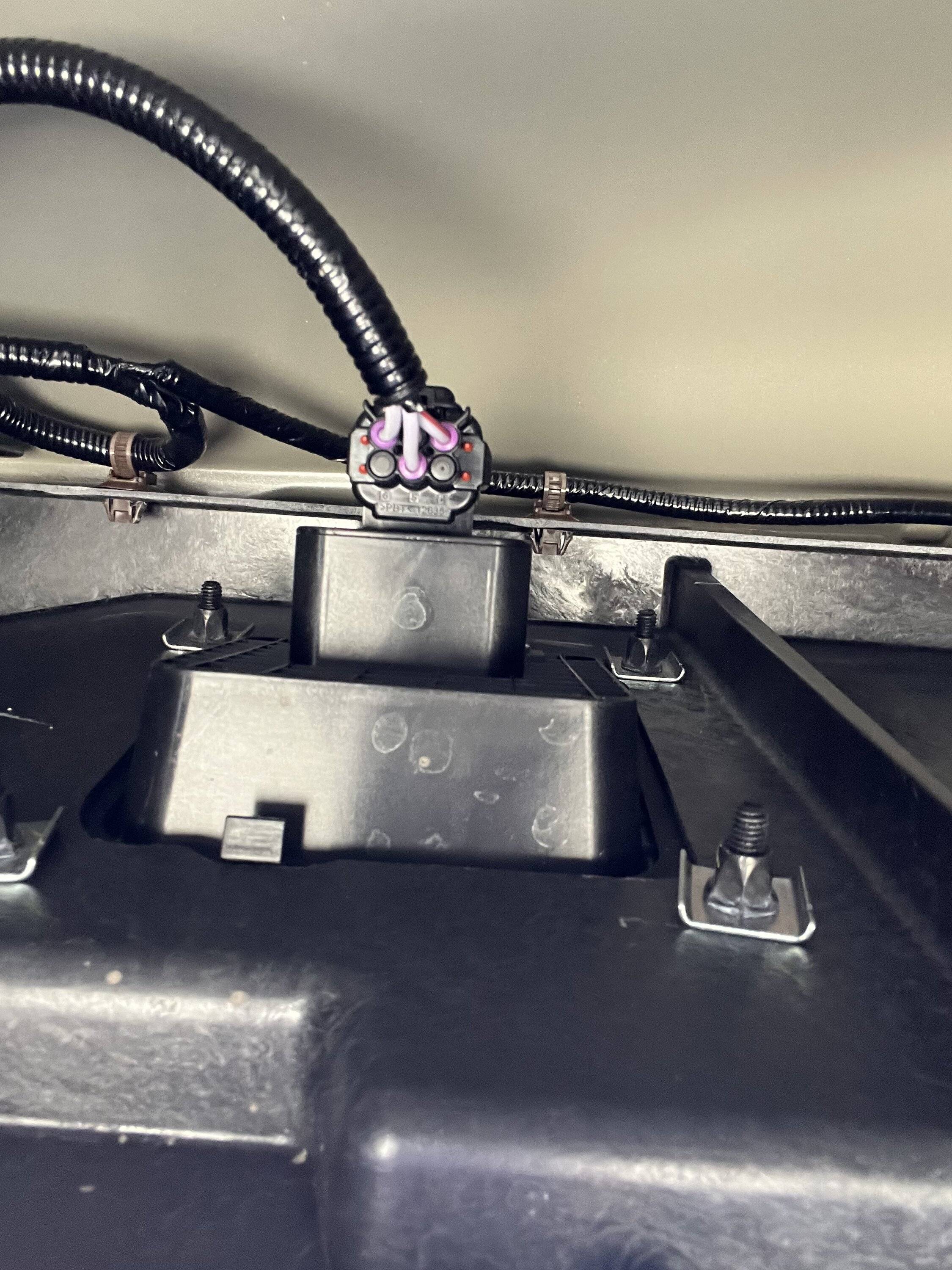

The picture of the connector is the back side of the AC outlet.
