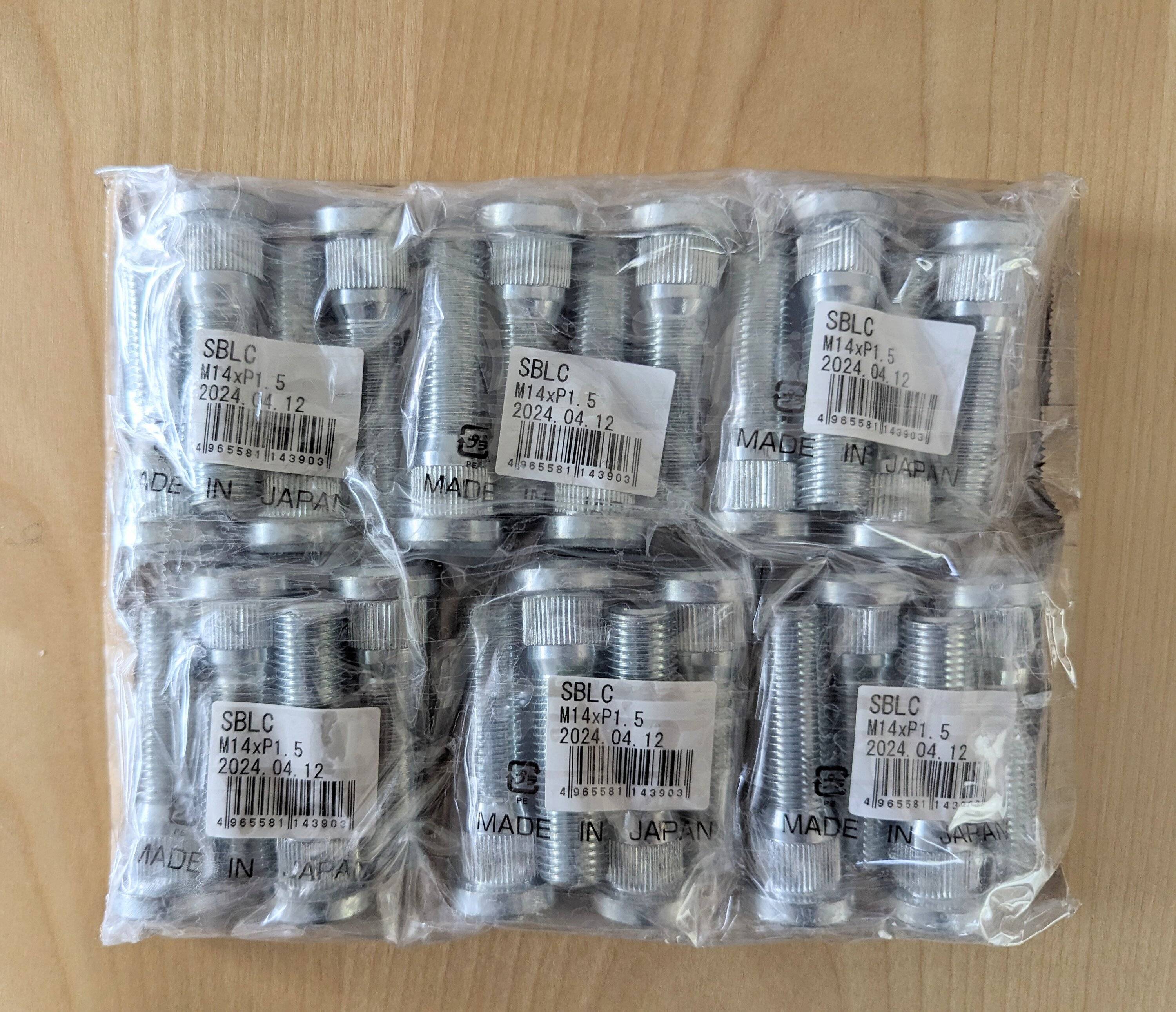

KYO-EI extended studs came in today. Plan on mounting them tomorrow, I'll post some pictures. But they look to be pretty nice quality. Hopefully the fitment is identical to the Tundra, I expect that it will be.
2024 Tacoma Extended wheel studs PXL_20240603_194028653
Any follow up on the wheel stud install? I’m wanting to do the same
