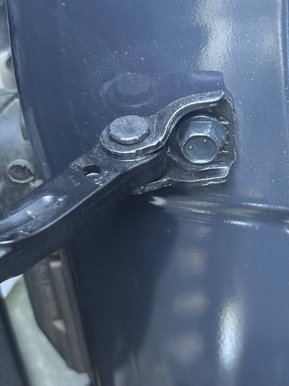

Does anyone else have an issue with clicking noises when they are opening or closing their doors? My 24 TRD ORP makes multiple clicking noises that sound like it's coming from inside the door when opening or closing and it's something that's started in maybe the last month or so. Just wanted to check on here before I talk to the dealer about it.

Yeah, I would bring that to the dealer's attention immediately. If I had to guess without seeing it, I'd assume something is really messed up with the door check strap (the plastic arm in the middle of the hinge area that moves in and out of the door as it opens and closes to prevent damage from over-extension.)

My wife’s RAV4 had a similar noise, these bolts were not tightened properly.

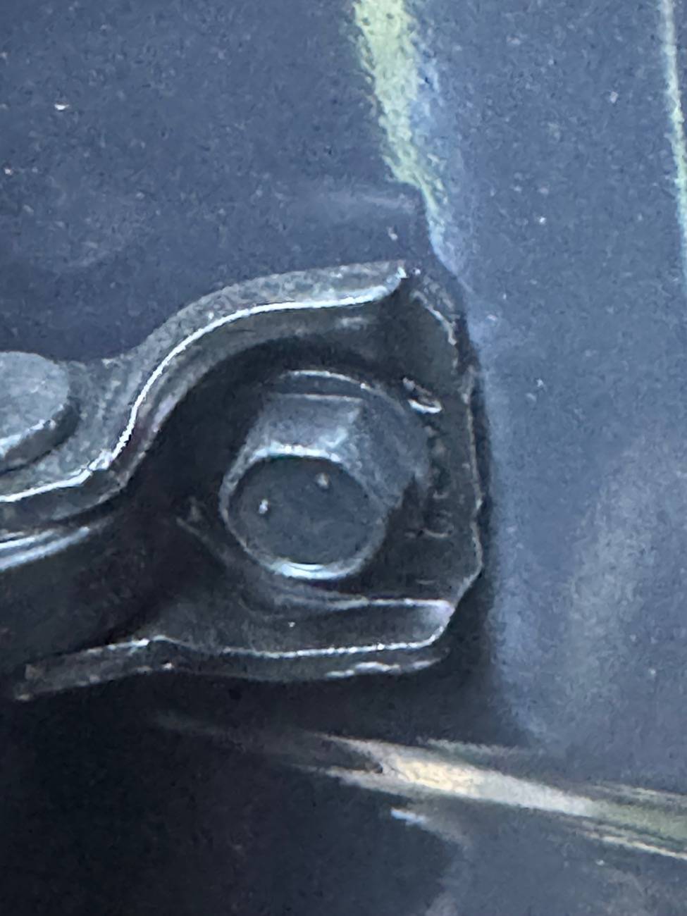

It ended up being the bolts on the door side of this arm. Shocking how loose it got in only 6 months.
