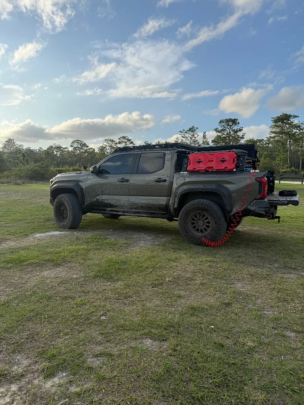

2025 Tacoma Trailhunter
The TH has the stabilizer disconnect, I raised it an additional inch on new springs and no issue with the stabilizer. Also avoided the diff drop from the bad stories I heard with the diff drop.
