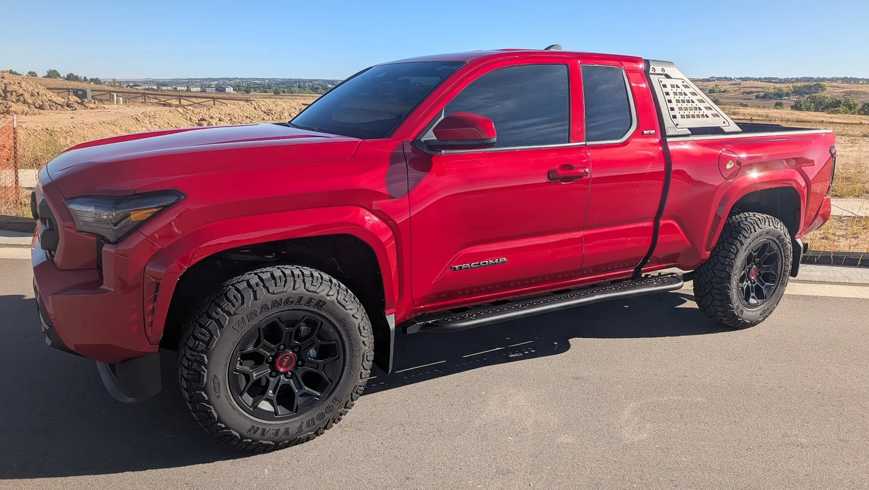

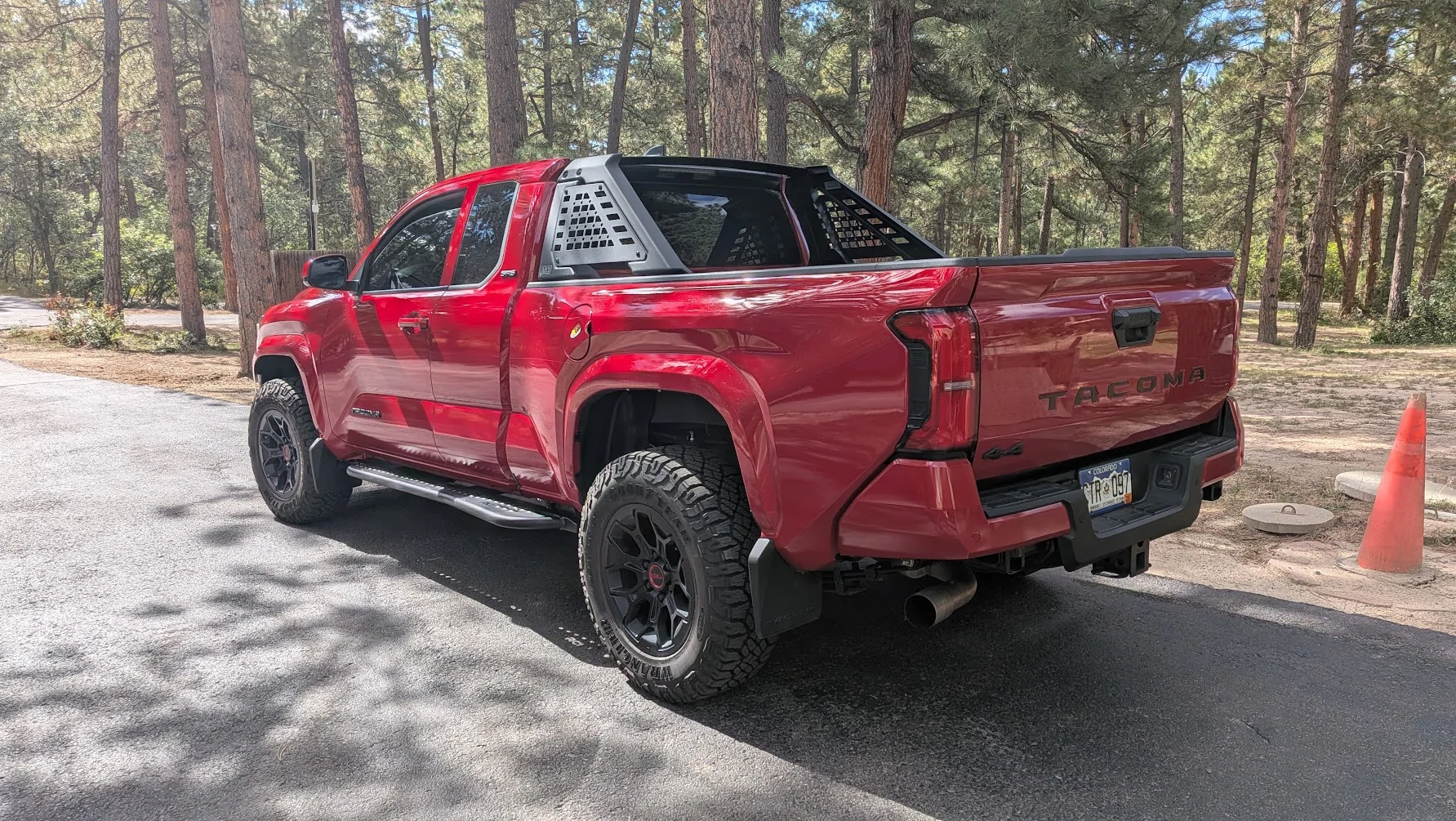

First, what everybody wants to see, the finished result:

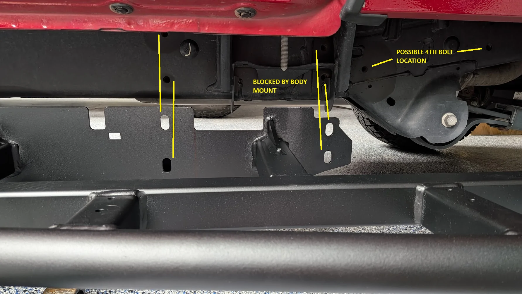

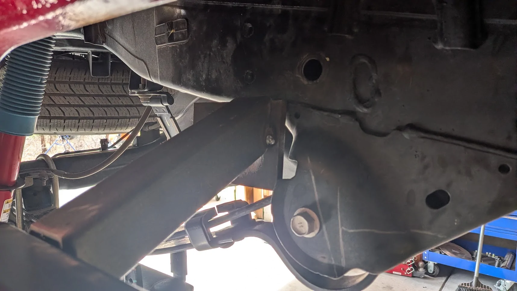

I got the sliders as close as possible to the existing mount holes to verify alignment, front half (driver side):

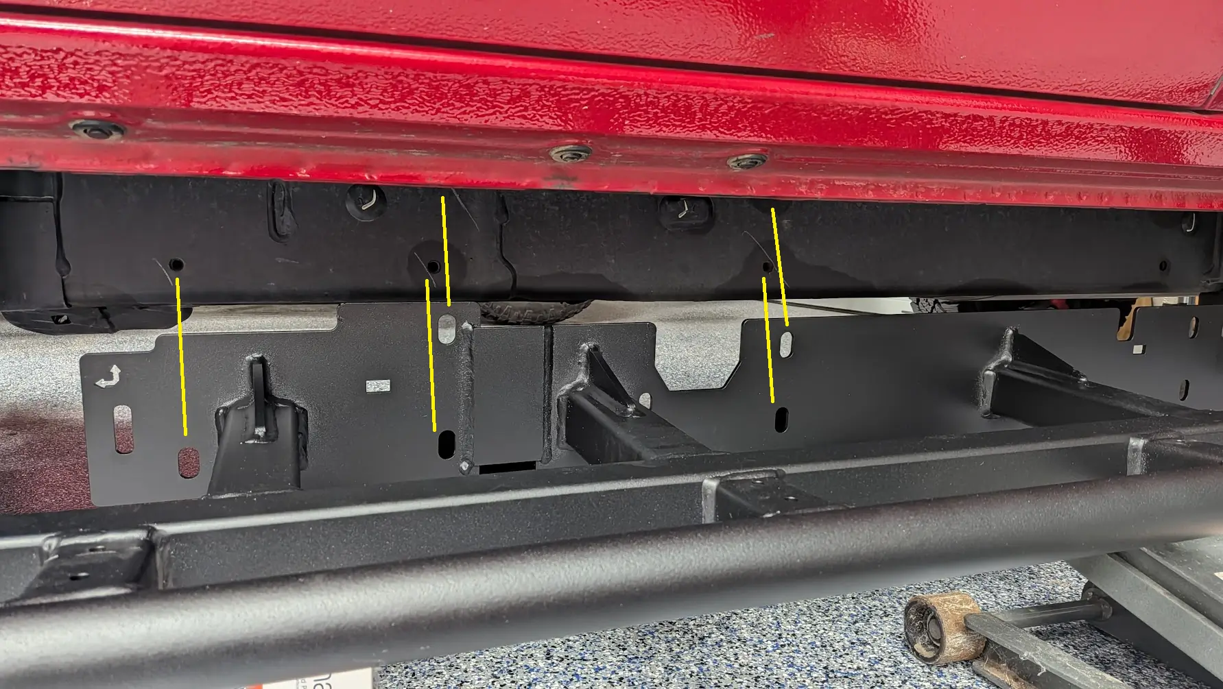

And rear half:

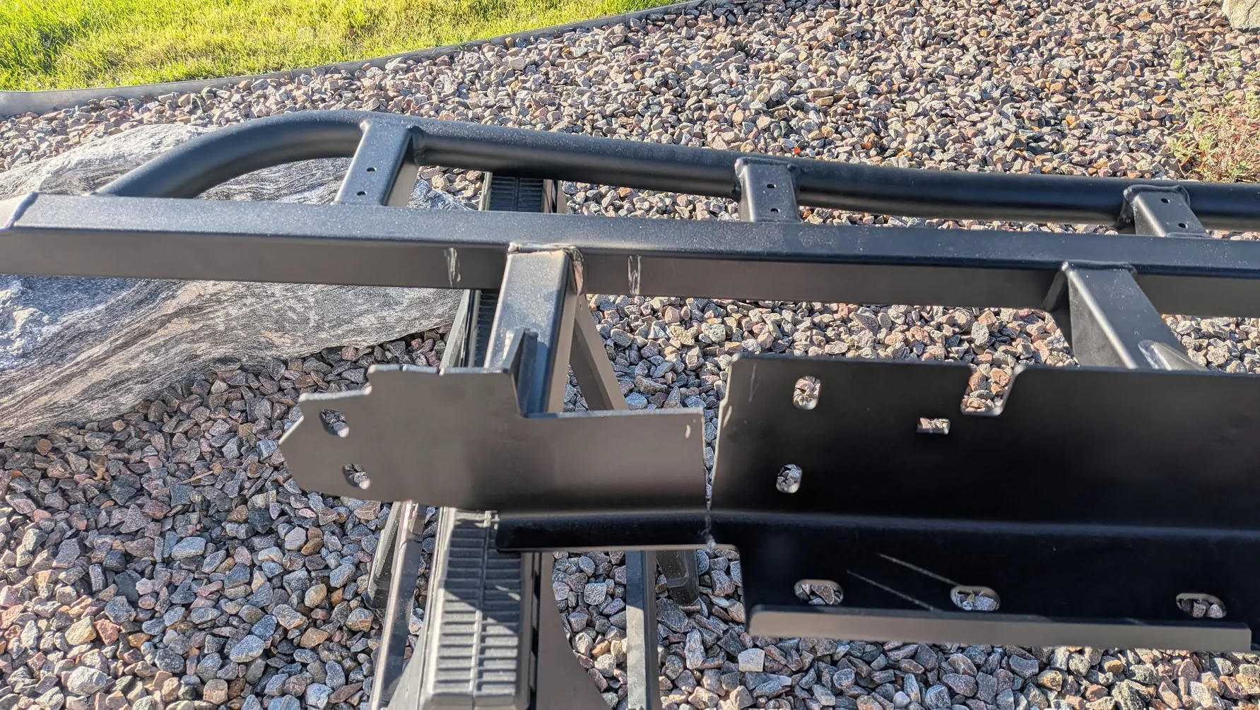

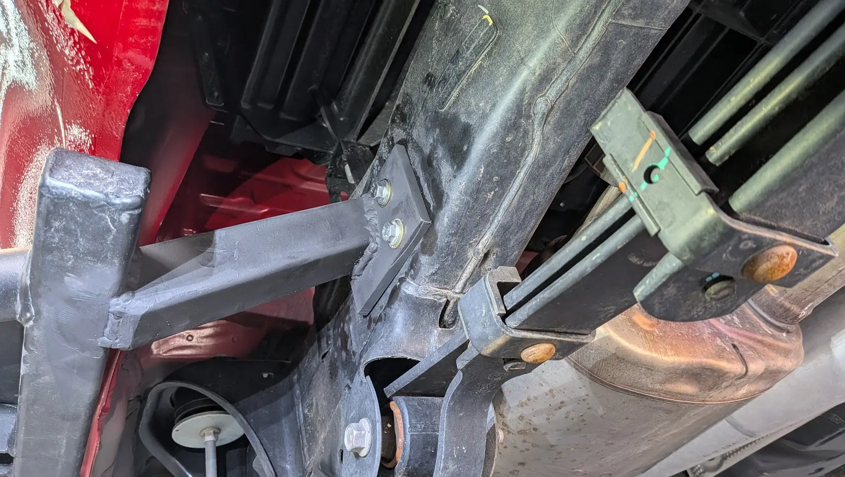

Having marked the cut line above after the last viable bolt location, I proceeded to remove the back part of the slider mounts:

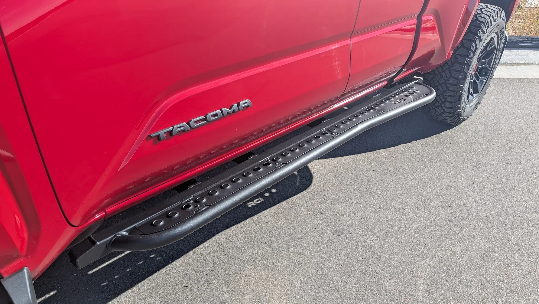

And they bolted right up into what you see in the first photo above.

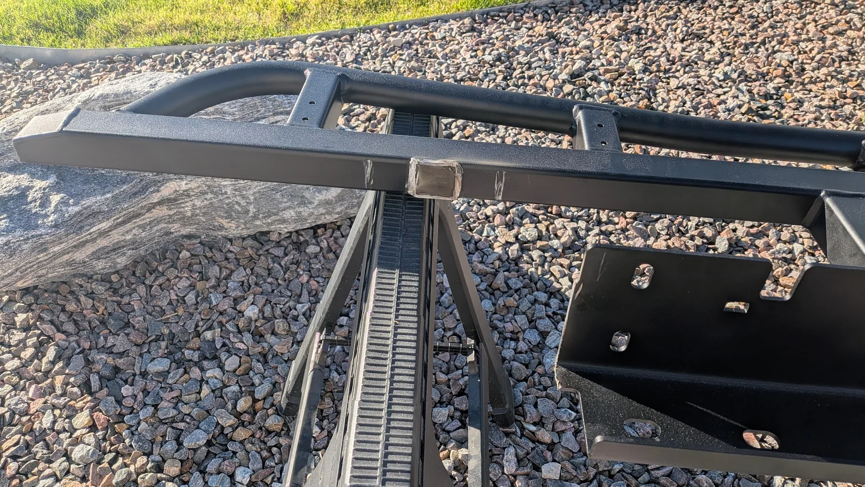

This undeniably reduces the weight holding ability at the rear of the slider. I do not plan to offroad this truck, however I do plan on having a friend with a welder re-use the 4th mounting point to bolt to one of those alternate mounting points identified above. Once that's done I plan on priming / rustoleum for the shiny parts. I'll share those photos in this thread when done.
And rear half:
