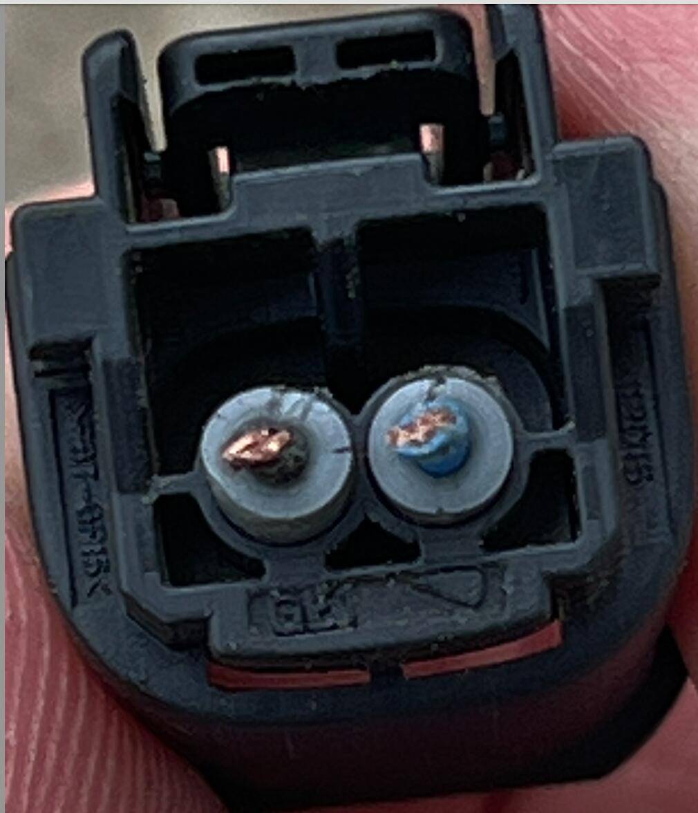

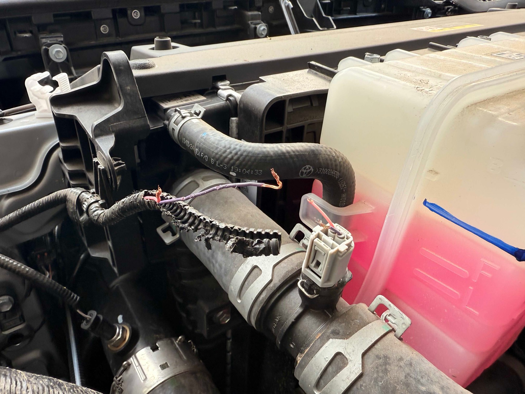

I had a rodent chew a coolant temperature sensor wire and I lost the plug. I'm having a hard time finding the part number to both the plug and wires. Anyone know where I might find it? There is actually 2 of them that are exactly the same one on the coolant pipe and one on the engine near the center drover side ish area close to the firewall.

FYI, the part number listed in the link is for the sensor; but the part they’re selling is the plug. Given how almost every modern Toyota uses this sensor, you might be able to go to junk yard and cut off the connector plug.

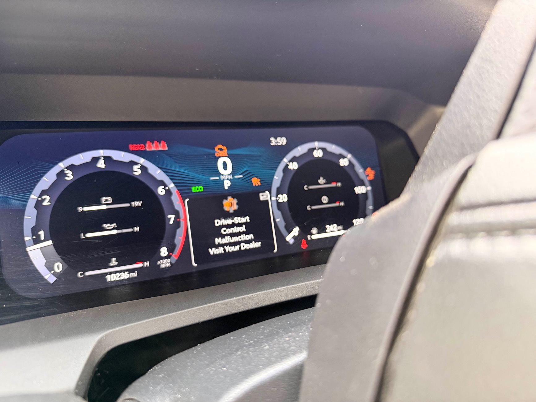

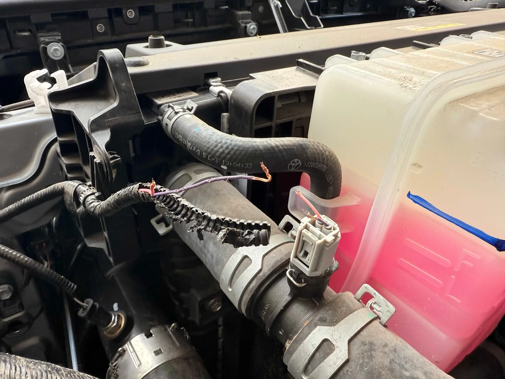

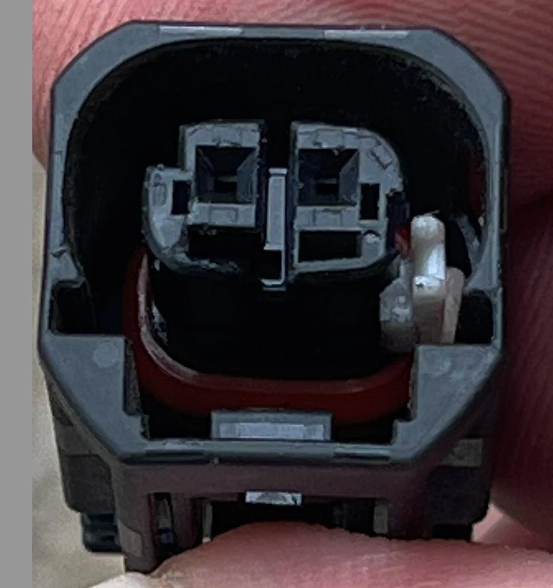

I had this same thing just happen on my 2024 Tacoma.
When you replaced this, did you just splice it into the existing wires? What is the best way to clear the error message?
