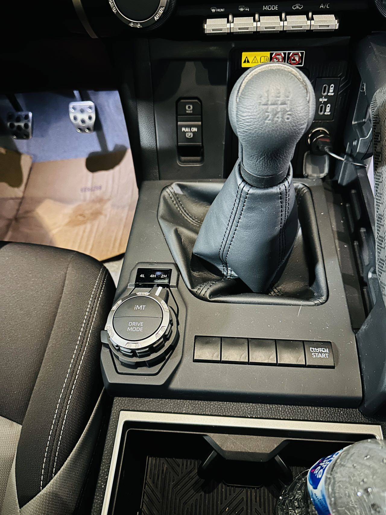

I've been driving my 2024 trd sport manual transmission for a week now, today I tried to switch from 2H to 4H, since it is recommended to do once a month by user manual. everything seems alright, until I slow down to make an downhill right turn around 10km/h in 2nd gear, it feels like the gear is locked up and slows down significantly, also very hard to make a right turn, almost stopped in the intersection.
Then I went to a parking lot, tried to make several 90 degree left and right turn in 1st and 2nd gear, every single time it feels like something jerking in that transmission and makes turning very uncomfortable. then I switch it back to 2H, suddenly everything went back to normal.
I am wondering if anybody with manual transmission had this situation, there could be something malfunctioning in the front differential, I will keep it in 2H until I take it to dealership this weekend.

I alsodrive a manual transmission rare drive BRZ and a full time AWD audi Q3, it's my first time drive a part time 4wd vehicle, is this something normal for part time 4wd?

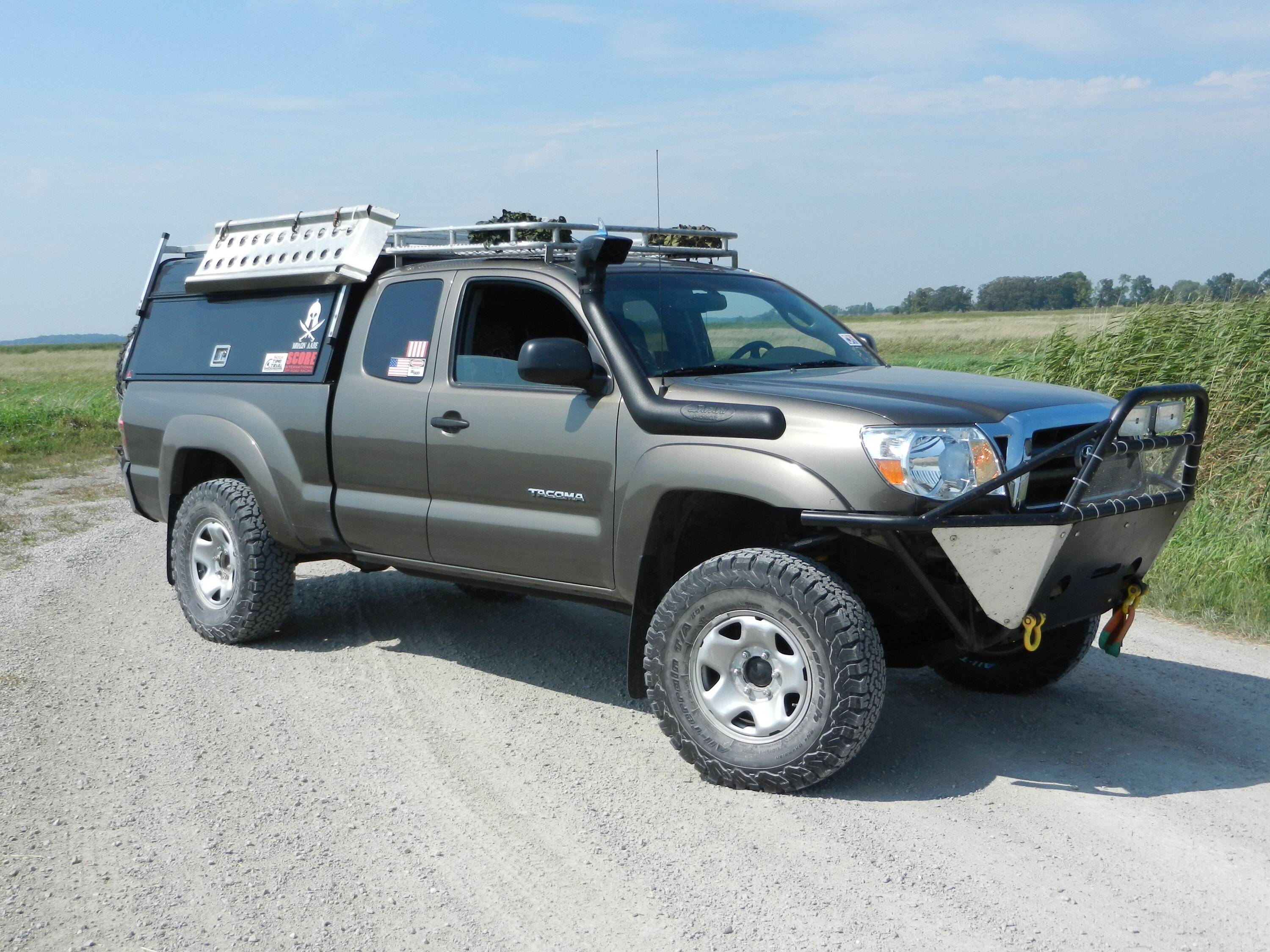

Are you doing this on pavement?
If so, I would not be doing this. The front diff needs loose traction to slip to perform at its best. Pavement will bind and grenade the front diff.
With my old Bronze Oxide 2010 SR5, it was a 5-speed manual, I had a Rustic Road that I used to cycle the front drive, worked well for me in the image below. Find a gravel or dirt road to cycle the front system.
