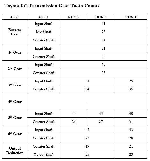

I’ll add this for anyone interested. Credit goes to Jeff Lange on TacomaWorld. Dude is a former Toyota parts wizard that has helped figure out the details on all these transmissions and many other various aspects of Toyota vehicles.
RC60F - Hilux 2.4L diesel (and now 2024 Tacoma 2.4L Turbo Gas)
RC60J - same ratios as above, cable shifted version for HiAce van, 3.5L 7GR I believe
RC61F - Hilux 2.8L diesel
RC62F - ‘16-‘23 Tacoma 3.5L 2GR-FKS
RC60x:
1 - 4.784
2 - 2.423
3 - 1.443
4 - 1.000
5 - 0.777
6 - 0.643
R - 4.067
RC61x:
1 - 4.784
2 - 2.423
3 - 1.443
4 - 1.000
5 - 0.826
6 - 0.643
R - 4.067
RC62F:
1 - 3.982
2 - 2.017
3 - 1.321
4 - 1.000
5 - 0.848
6 - 0.713
R - 3.385
As you can see, they all share the same R-1-2. The difference that makes the 60 & 61 different from the 62 is their reduction gear set. For those who don’t know, the reduction gear set is the relationship between the counter shaft and whichever shaft it’s fixed to. On older transmissions like the R15xx 5-speeds, the input shaft is very short and tied to the counter shaft. Therefore, those transmissions have input reduction gears.
The Aisin RC family (all of the transmissions listed above) have output reduction gears. So in this case, all 3 transmission models have the same R-1-2, and the 62 model has a different output reduction gearset than the 60/61. So the 60/61 have the same final drive in all 3 of those gears, while the 62 is taller. But, the proportional spacing between R-1-2 is exactly the same on all 3.
3rd gear is the same on both 60/61, and is taller on the 62.
4th is direct drive, it locks the input and output together for a direct connection. Lubrication is still provided by the output shaft driving the counter shaft which slings up gear oil.
5th is different on all 3, for whatever reason Toyota wanted the 2.8L to have a lower 5th gear. Maybe for better towing in 5th, I don’t know.
6th is the same on the 60/61, and is shorter on the 62. My guess is that the gas diesels and now the turbo gas, they know those have the torque to maintain speed at low ish (2000) rpm. The gas motor doesn’t work so well there so you end up with a shorter final drive at higher rpm (24-2500ish).
Overall, you end up with a wider box in the diesels and new turbo gas engine, while the NA gas engine gets a closer ratio box. Which for the most part makes sense, although I’ll say some of those ratios of the 62 are no fun in a stock 4.30 rear end gas engine configuration.
