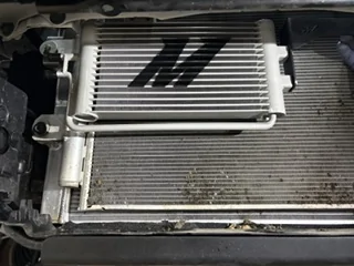

I am in the process of installing the Mishimoto Ultimate Bundle and AFE cool intake system on my 2024 TRD Off Road Tacoma. Due to the scope of the work involved in completing the entire installation it was necessary to stage the installation.

The technician who completed the installation of the radiator and intercooler parts managed to complete the install without taking the front grill off which I didn't think was possible, but he did it.

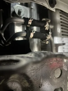

The next stage will be completing the installation of the transmission cooler unit which is going to take an entire day to complete.

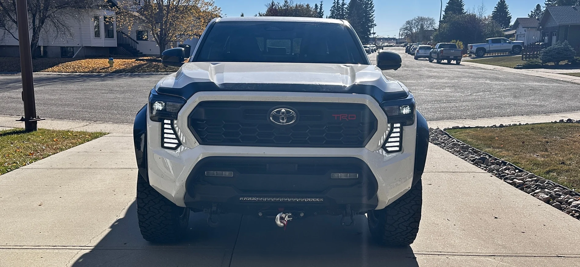

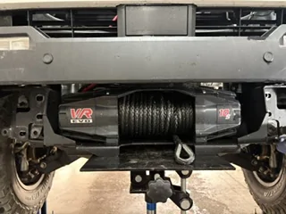

The only challenge that I have at this point is I have previously installed an Addictive Desert Design front bumper and winch so I am not sure if I am going to have the necessary space to mount the transmission cooler.
Long story short....... I wondering if anyone has completed the installation of the Mishimoto Transmission Cooler with a custom front bumper and winch I would greatly appreciate any wisdom on completing a similar installation.
I was planning on assessing the installation space during the first stage of the install which involved the installation of the new Mishimoto radiator and intercooler unit, but the technician completed the installation without taking the front bumper off so I am not sure if I am going to have the necessary space to complete the install.
