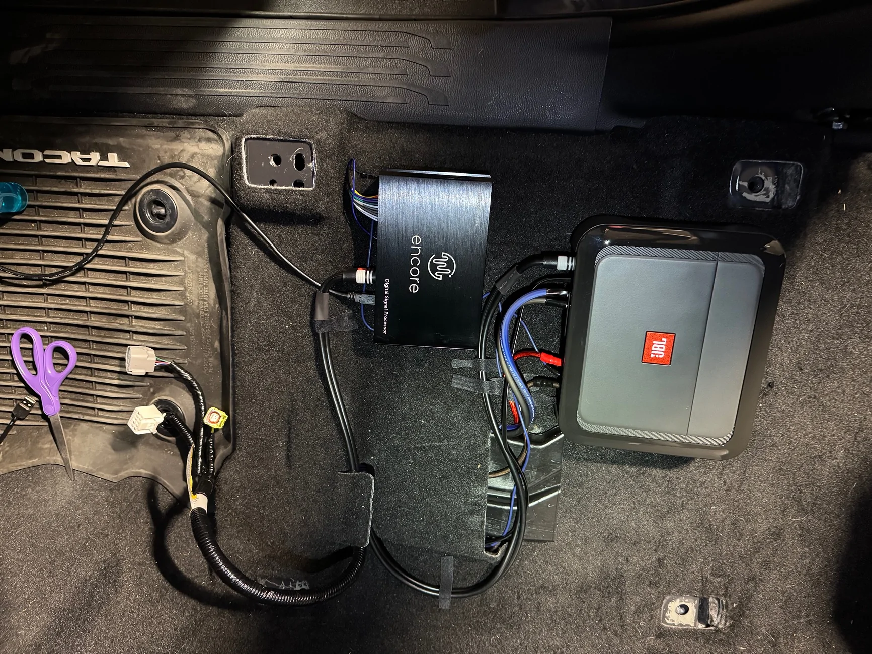

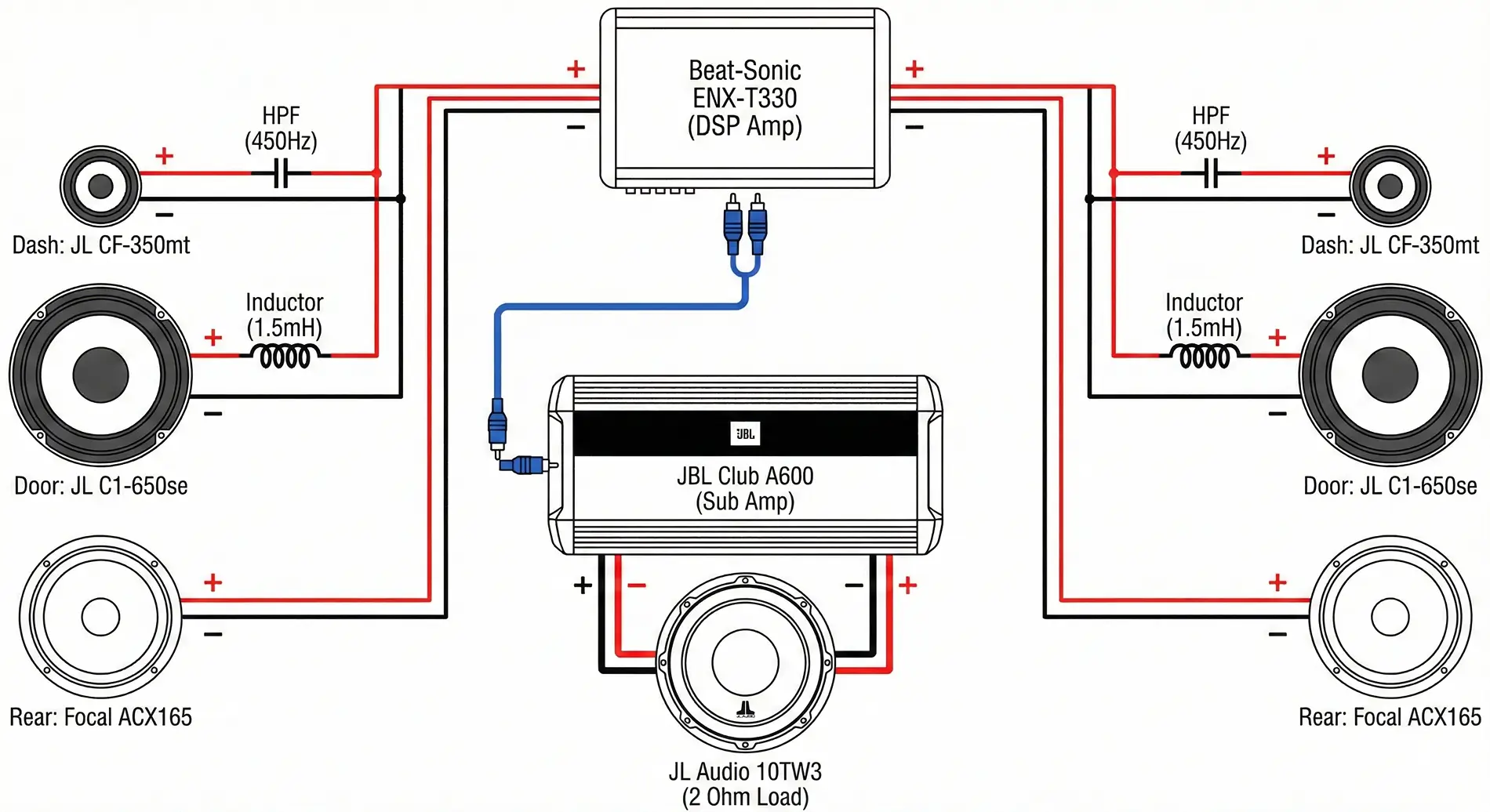

I went with beat sonic’s DSP amp because it came with a harness that connects everything at the head unit with plug and play harnesses, and is long enough to route below the passenger seat.
I’m working on relocating the JBL amp to the rear, after sound deadening it
