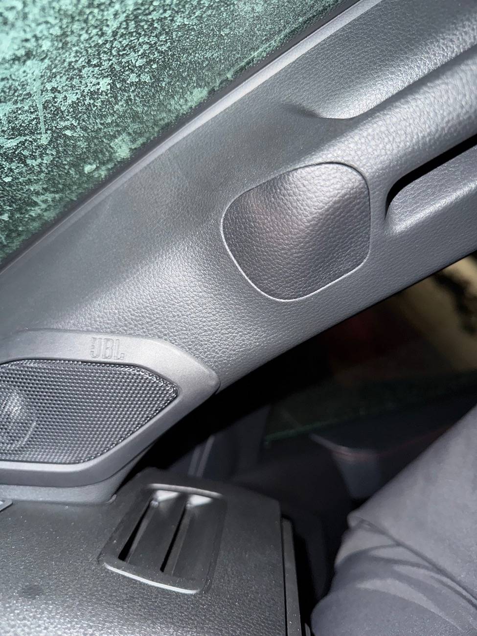

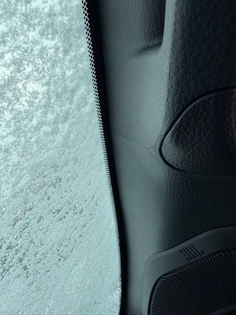

Has anyone noticed any cracks around the passenger grab handle on the A pillar?

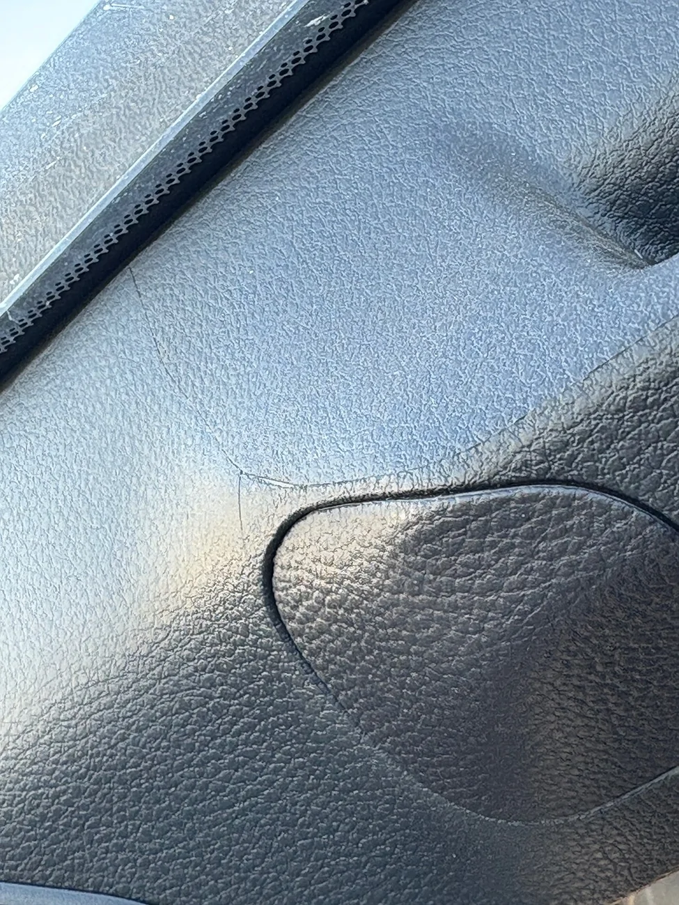

So I just looked at my 24 TH and I see that I also have the same cracks?? I never have passengers in my truck so it’s not like the handle has been used. Seems cracked only on the lower end not the upper seam?
Looking closer, it seems like it’s just the one tear to the lower left rather than any cracking along the “curve”, which may just have poor joinery from what I can tell. It seems like there is a top layer/coating that is pulling away.

Looks like either a weld line from the injection molding process or a stress concentration from a sudden change in plastic thickness. Regardless, it's likely covered under warranty.

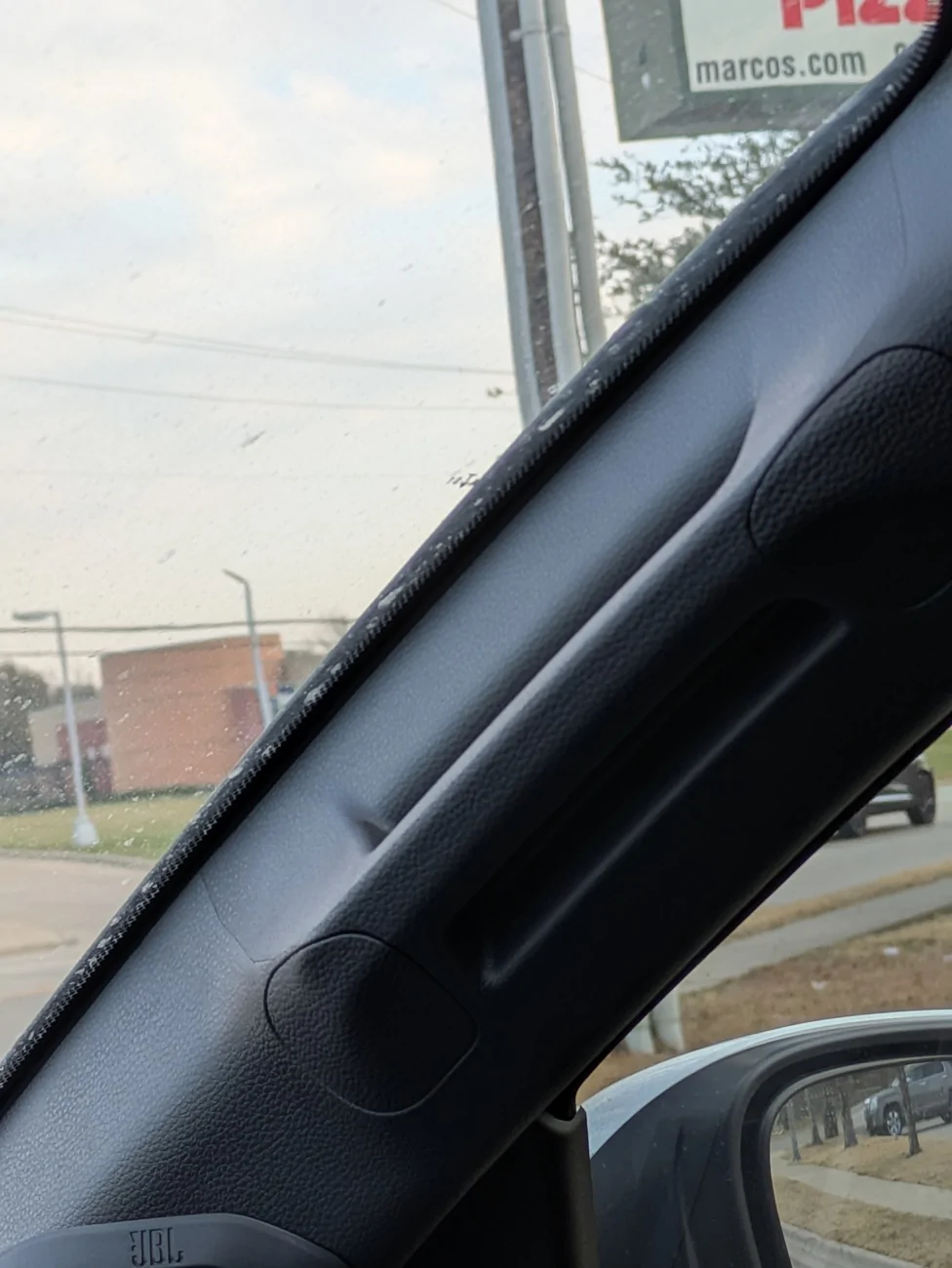

I noticed this on mine today. I looked more closely and it's how Toyota intended. These are split line areas for the cover to separate at if the airbag ever needs to deploy. They are design features, not flaws or damage.
