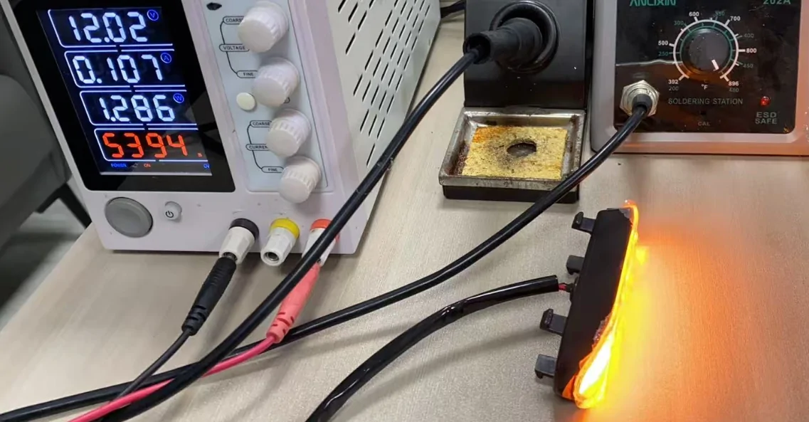

Mabett
Apr 21, 2026
216
138
LA
www.facebook.com
2026 Tacoma TRD Sport
It operates at 12V and 0.1A (ONE PCS)
