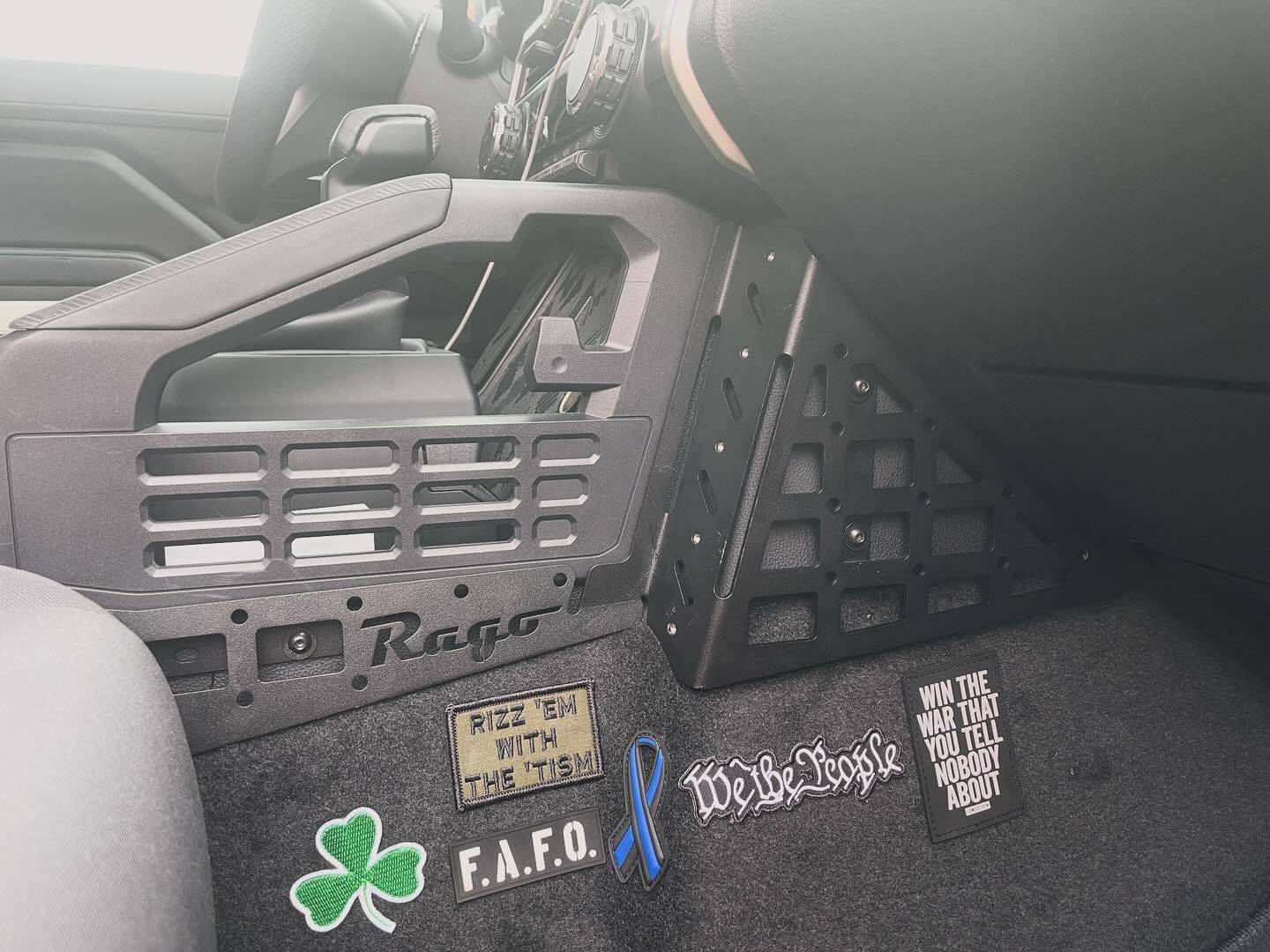

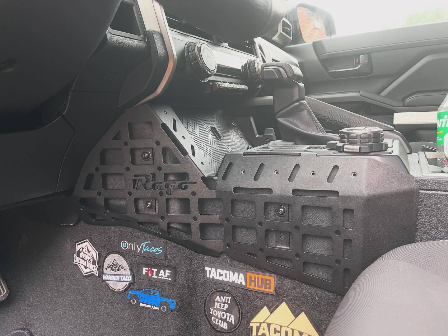

Curious to see if you install anything with an arm, such as a phone holder using the threaded holes on the passenger side, if you have any flexing. I’ve noticed this, seems like it could be remedied with a third rivnut and bolt to the right of those two bolts that it seems to flex a bit from. I’ve reached out to Rago.

Does it flex like that under regular driving over bumps or only when you grab it and wiggle around? I plan on mount my phone on the left panel and a mobile radio on the right panel.

Yes it causes a good bit of vibration and movement. The driver side one is solid.
