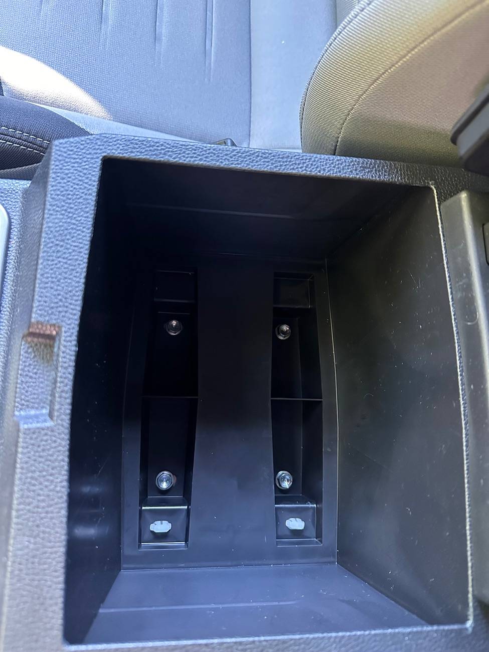

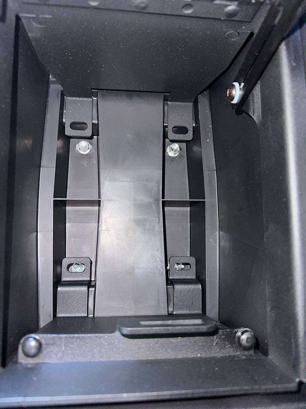

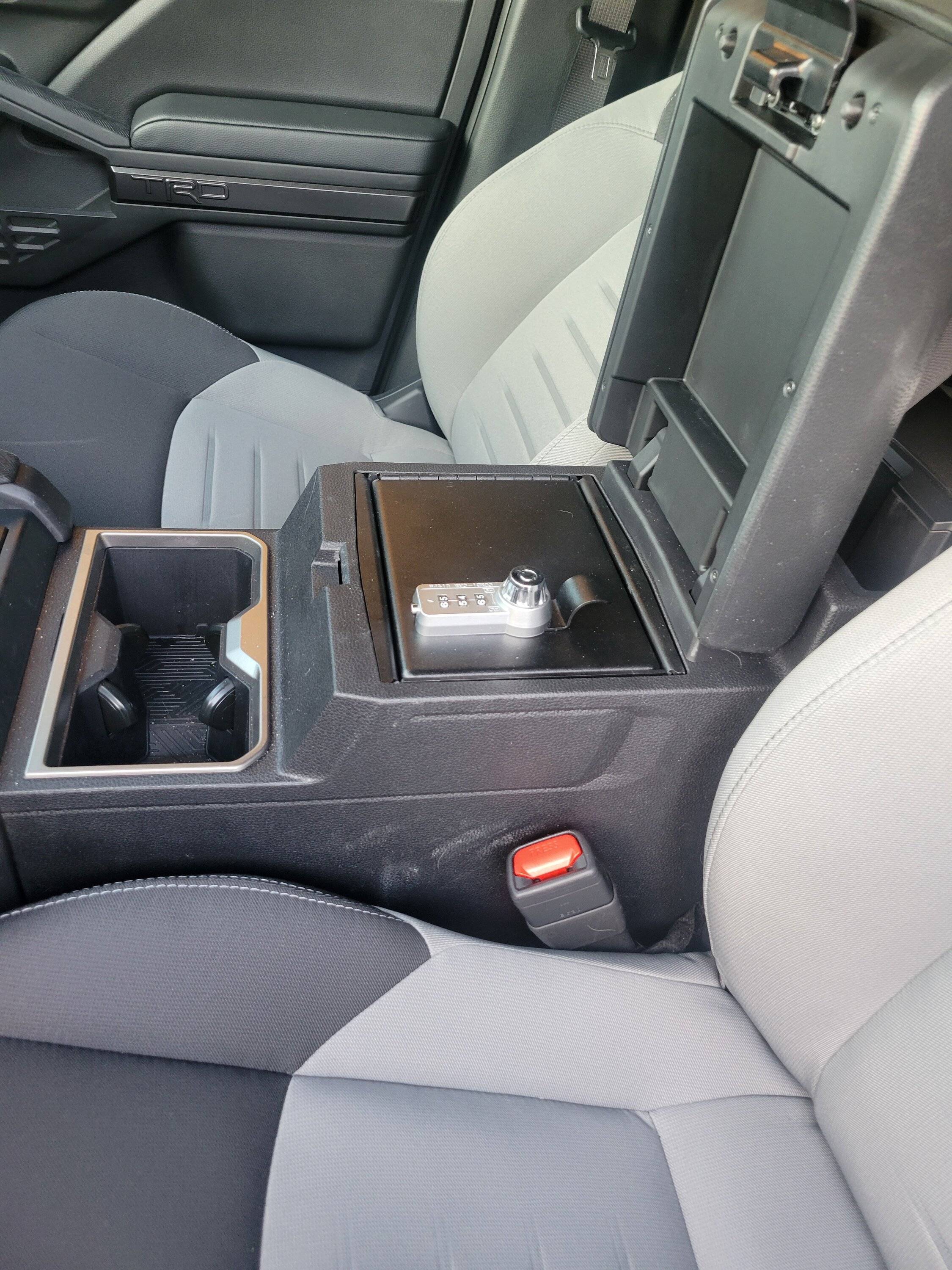

Got the vault from dealership. Took 4 mins to install. It uses the four factory bolts under the console floor mat. 10mm head. unscrew all four, drop in the vault and put back in the bolts and done.
Part Number # PT971-35241

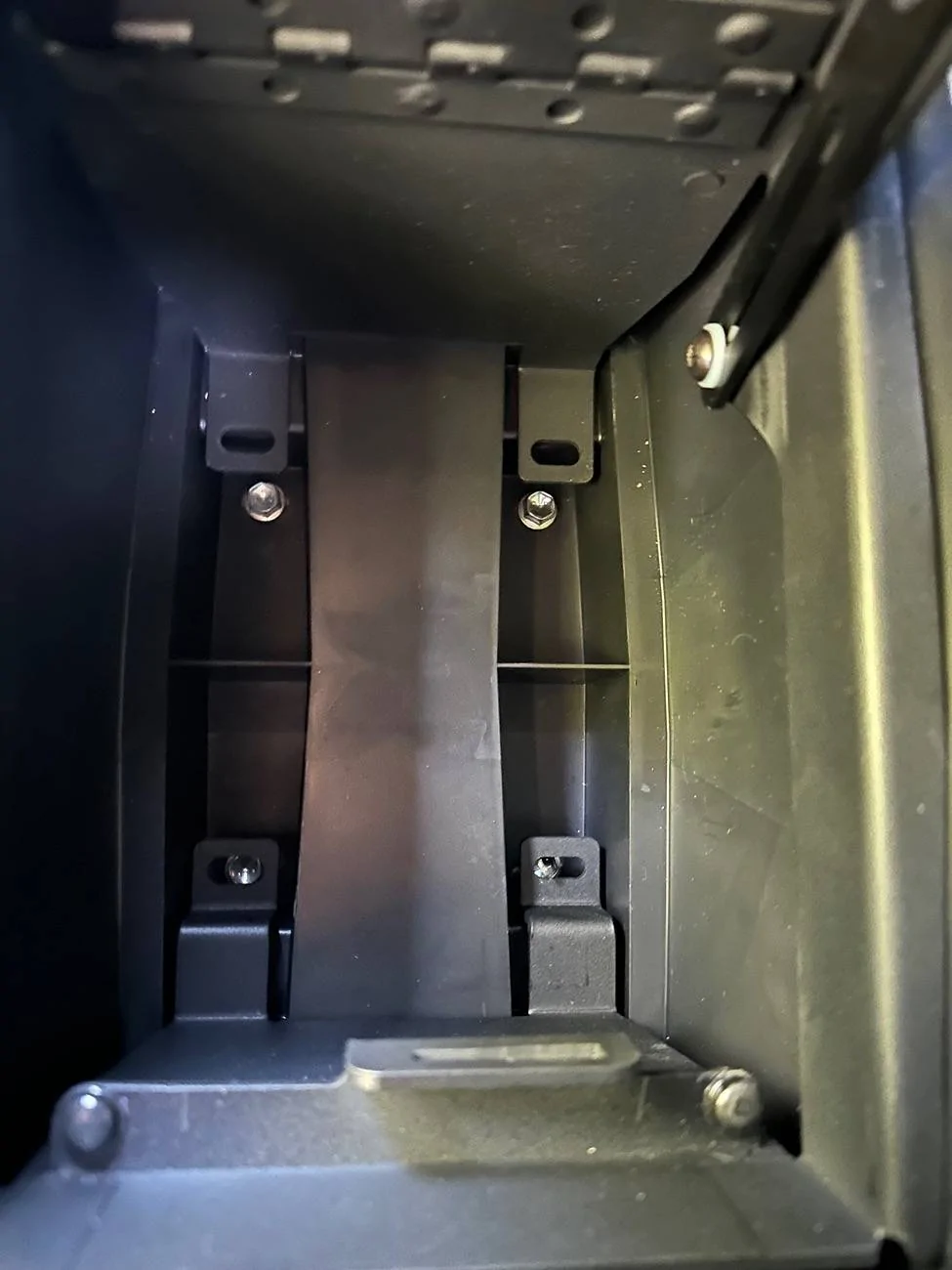

Thanks for the pic. Can you take some photos of it open too - so we can get a look at how much space it has internally?

Instructions, those get tossed with the box. It uses the four factory bolts under the console floor mat. 10mm head. unscrew all four, drop in the vault and put back in the bolts and done.
