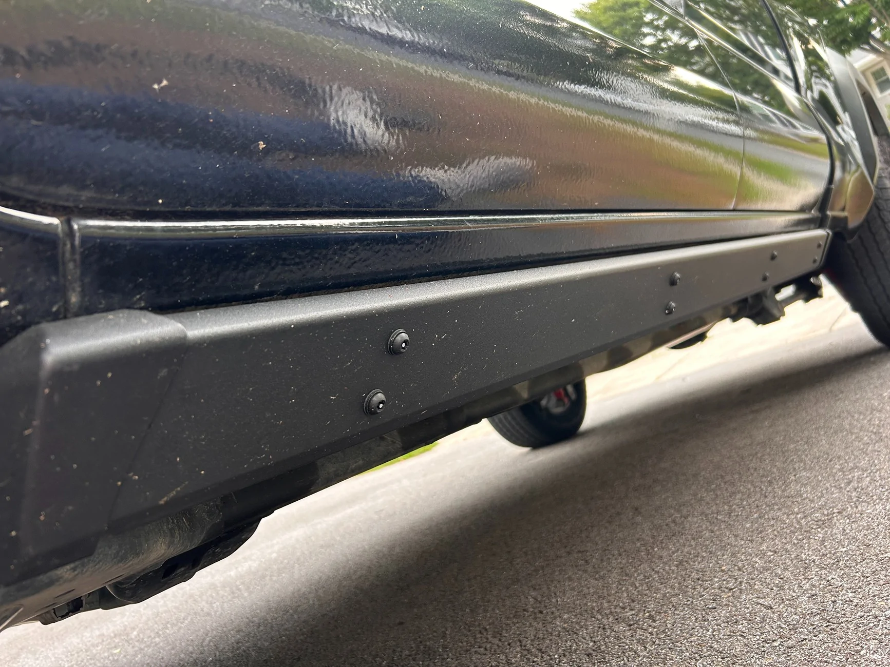

This led me to end up finding out that some rocker protectors (Apparently the TRD Pro ones only) had bolts in them, they looked like they would perfectly be placed to add a step (if I could find the steps) but while I googled, I couldn't find any reference of them nor any pictures of removable steps, UNTIL I saw a Facebook post with just the separated step. This got me interested again, as I knew I wasn't crazy, and I ended up finding one of those TRD Pro rocker protectors on Facebook and bought it. Then, after some searching and random lookups on the genuine parts store, I stumbled upon the part # for just the steps and the tool to put them on the specific rails. This number is #PT925-35246

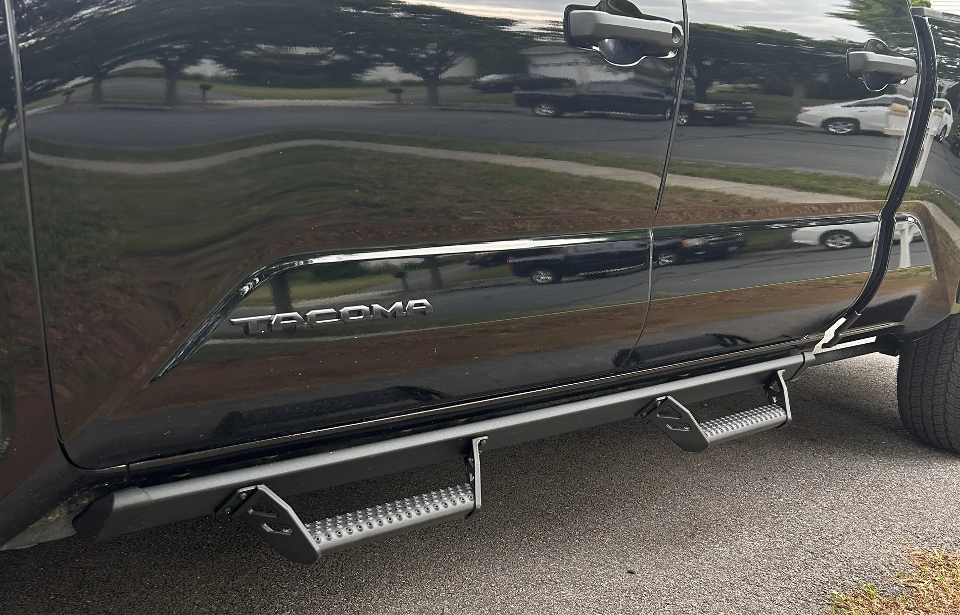

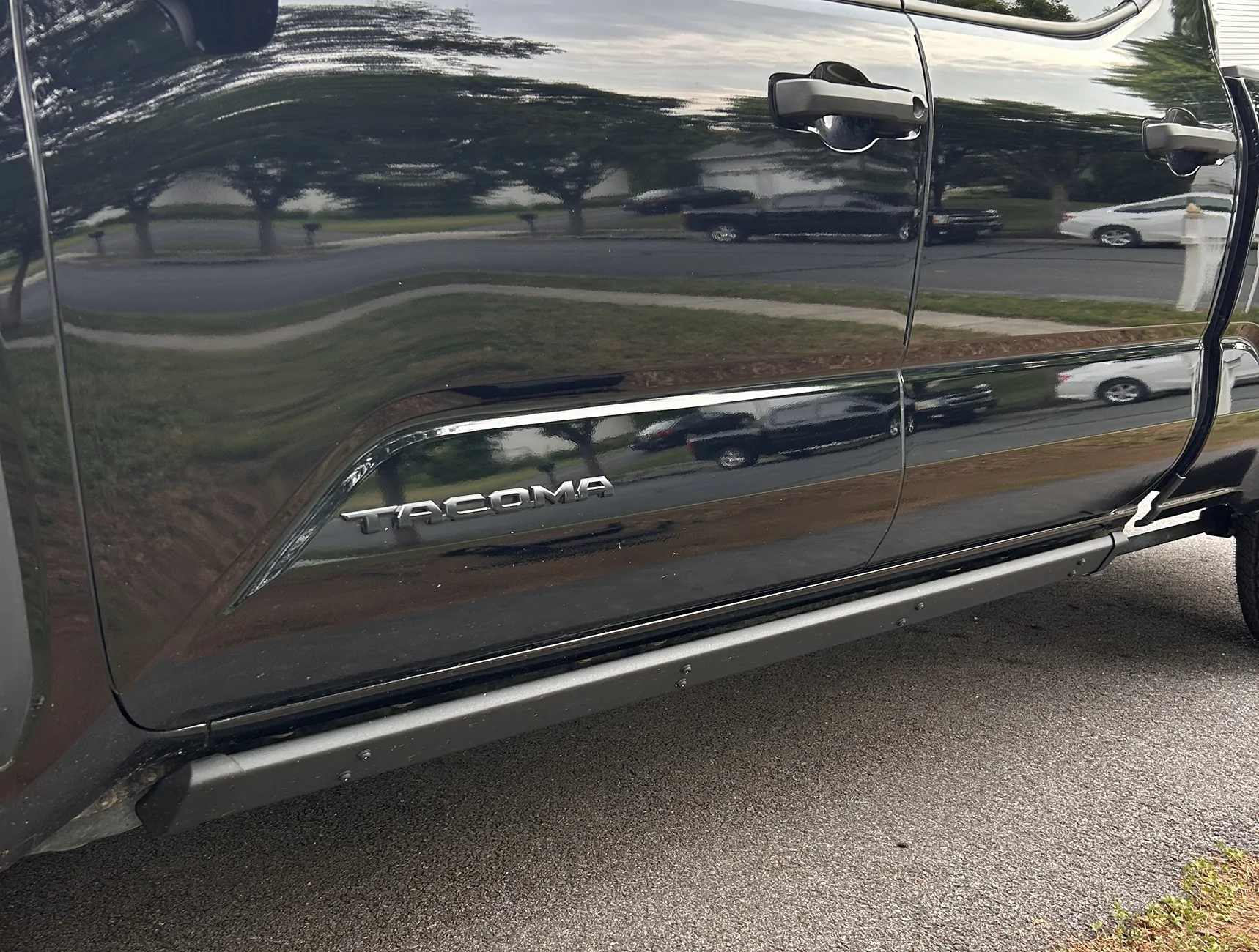

Now, I still don't know the part number to buy the rocker protector itself. As I have said, it's NOT the normal rocker protector rail, but I have heard the specific rail you need is a TRD Pro only, so try and look on Facebook for people selling theirs, as I did. But once you have both pieces, the install is really easy. The rails themselves are just a few bolts that are already on the bottom of your truck, easy to install with an impact to just take them out, put the rocker protector on, and bolt them back in. Then, for the steps, you simply use the tool given with the kit, take off the bolts, put the steps on, and put the bolts back on. It takes maybe 5 minutes to do all 4 steps once the rocker protector is already on.
I think this is the perfect in-between for functionality, cost, and style. When you need the max clearance, you simply take off the step portion, but when you are just on normal day-to-day roads, you can have them attached.
Here it is with just the protectors :
And here it is with the steps on :
