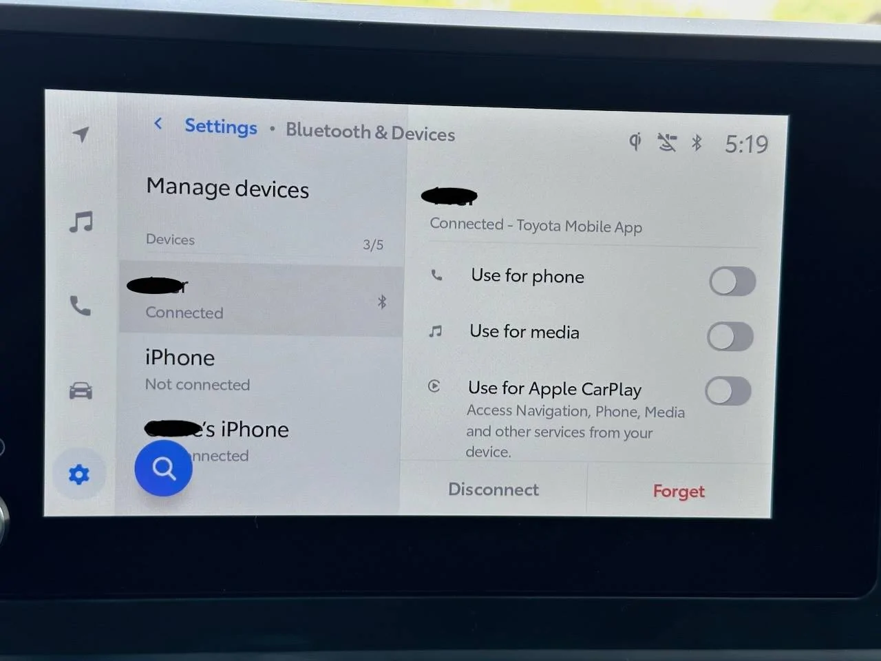

At this point my discovery sure seems to be a bug. I've applied professional level troubleshooting methodology. What I mean there is my job includes managing devices and wireless at scale and at a high level.
My pickup loses the ability to tap to or start in CarPlay. I've absolutely made sure full startup and all screens are up before trying. I've tried this with 3 different iPhones all this and last year models. Tried the phones pre and post the recent updates - versions 17.5 and 17.6. I've deleted the devices from both phone and the truck and started over.
The frequency seems to be about 20% of the startups. I'll watch that closer now that I know I have not tried it too soon and have been through the other steps. It has also occurred where I can't just re-enable use for CarPlay. It has also occurred when I cannot slide to re-enable.
Finally, I also know you have to use for CarPlay, and I've disabled send to Toyota for privacy. With the latter I still have the it works sometimes. All these same phones do not have same issues with other CarPlay vehicles in the family. Those are VW and Acura. My phone didn't have it in a recent Jeep rental.
Thank you for any input and consideration here. If I'm not alone I suggest we agree on what's going on and expedite it with Toyota.

What occurs (what I meant in the post) is the bottom choice in the screen shot where Bluetooth settings go from "Use For Apple CarPlay" on to off. What preceded the screen shot was I drove to work with CarPlay working displaying map while playing an Audible book. When I got in the vehicle to drive home it would not work again. Yet another time the answer was drilling into Bluetooth settings to see the slider move as the screen shot.
Per that blue sticker what was on the dashboard I do have the connected services turned off. That because I have no intention of paying Toyota the monthly fees and more importantly do the data sharing disclosed by Toyota.

The main thing I hope to establish here is if others see what I posted in the screen shot. You start the vehicle, give time for all the electronics to boot, the AA or CarPlay work, and then you restart the vehicle having to go back into Bluetooth settings to enable it.
If we have what may well be a bug or fix needed, my hope is folks can confirm same issue and keep any other sound system gripes a separate matter because this is not occurring with the other CarPlay vehicles we own or use often.

Yes, my Tacoma about half the time when i restart it i have to go into settings on Bluetooth to switch CarPlay back on for my primary phone. Seems like the truck could remember your setting and keep CarPlay on for primary phone. Only takes a couple seconds but irritating in 2024 for that not to be automatic.
