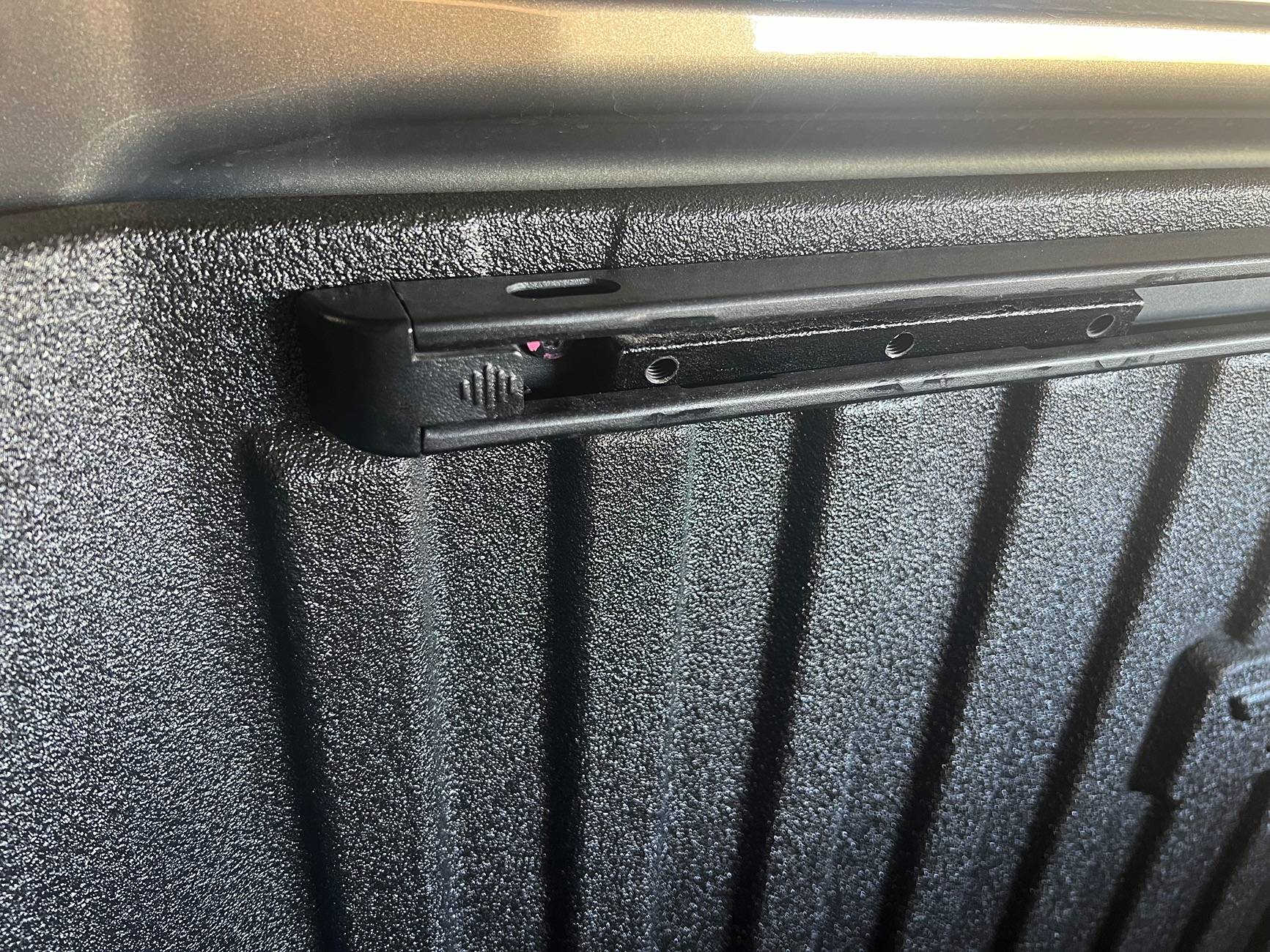

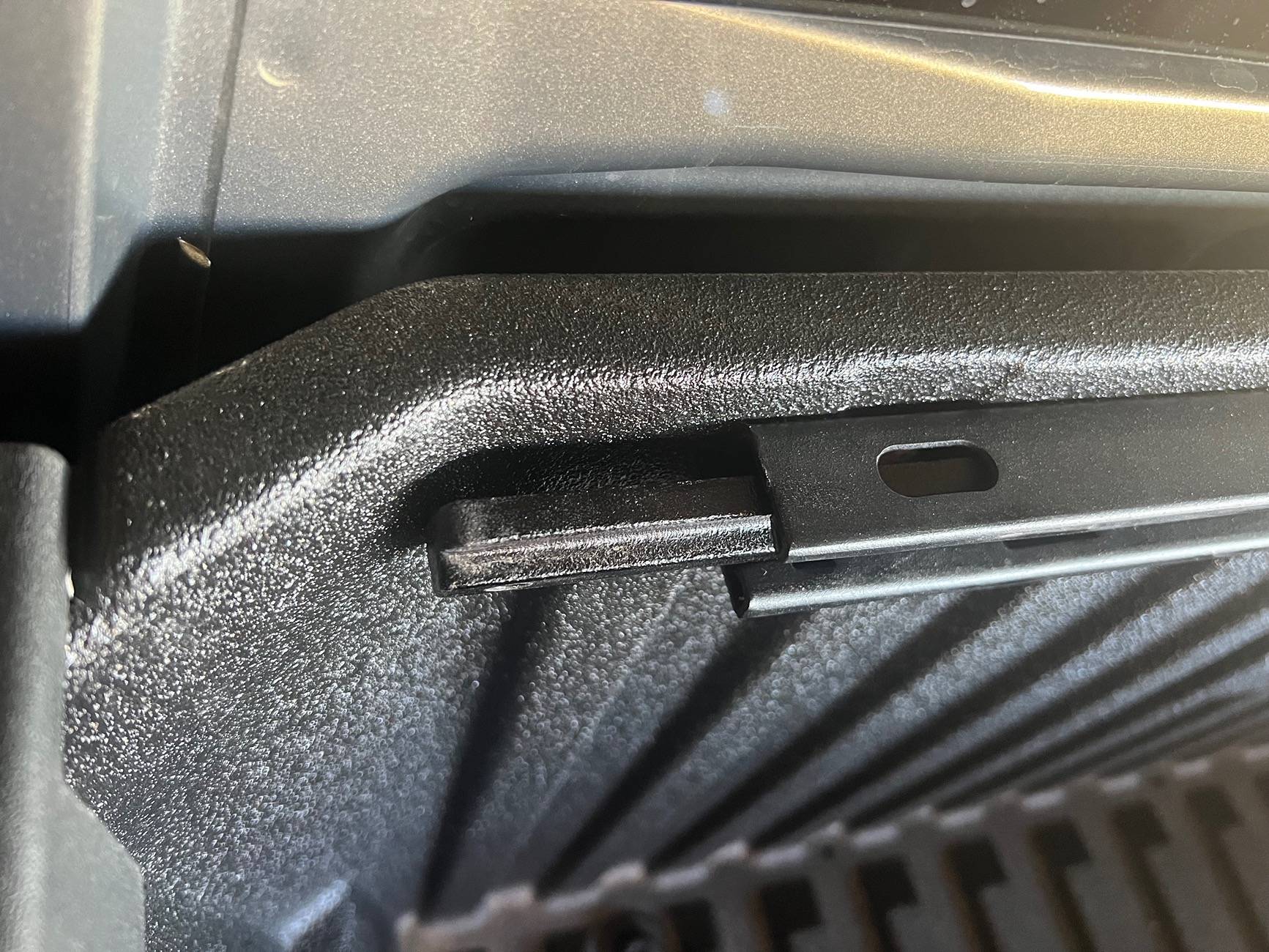

To remove sport bar hardware from fore bed rail. Need to remove rail from bed? To get enough room to slide hardware from within rail? Seems like Not enough room to simply slide the track hardware out with rail installed?

I just removed my ARB Sport Bar and I did remove some of the bolts in the rails to be able to remove them. I didn’t remove all the bolts, just enough to be able to move the rails an inch or so.

I had to remove all the rails completely in order to remove the ARB sport bar rail brackets.
I want to see video of someone backing out the rails just a smidge and get those metal bricks out. There’s a guide grommet on the bed’s side rails too. Show me how you can partially do it. If you can, you were a champion of the board game ā€˜Operation’ in the 80’s

Torx T40 to remove the rack and Torx T30 to temporarily remove the bed rail in order to slide out the mounting hardware for the rack. Super easy.
