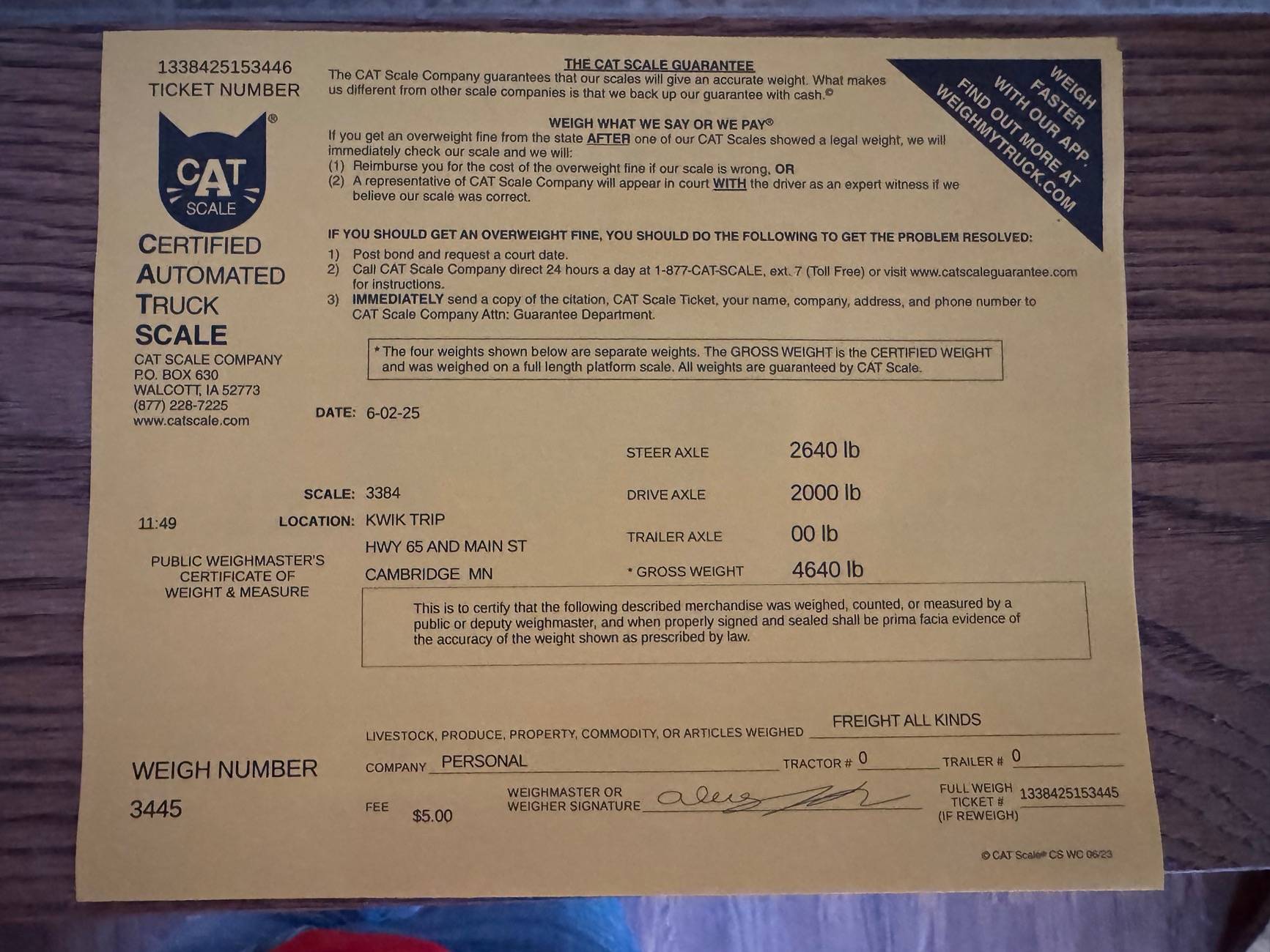

That got me thinking…how much headroom do I have on my rear GAWR? It’s rated for 3,000 lbs, and I had no clue how close I was getting when I hooked up the trailer. I couldn’t find a F/R weight distribution or axle weights online, so I hooked up the trailer and drove to the truck stop to find out.

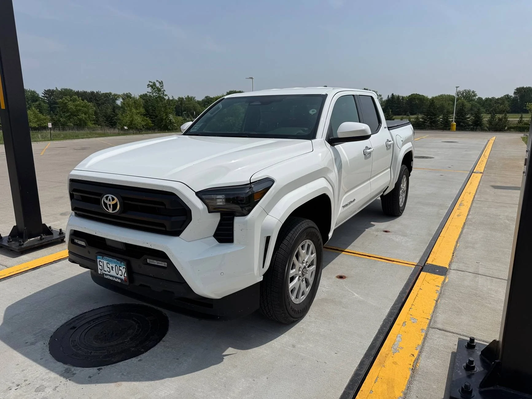

This is my SR5 DoubleCab 4x4 with the upgrade package. Full tank, about 30 lbs of gear, and no driver.
