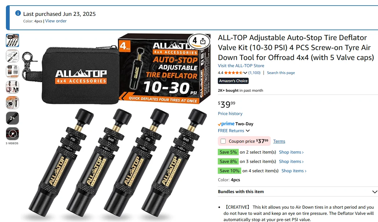

i run my KO3 in 285/70/17s at 32 psi for everyday usage, airing down as needed for offroad... 22ish is the general go to I have these set to:
2024 Tacoma Stock tires PSI for Tacoma Off Road? 1766816524721-21
... but can go down to 12-15ish if needed for soft sand, etc.
