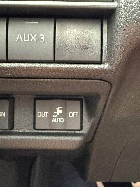

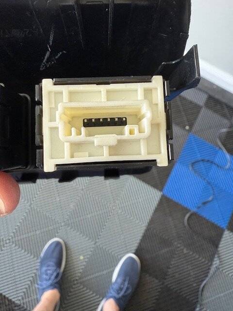

Looking for some help to find a wiring diagram or pin out for a specific switch. This switch is actually for a Tundra with factory power steps.
However I want to use this switch for my Rough Country power steps that I got installed to make it a cleaner factory look. It has 6 pins and I am just looking for a diagram to tell me what pins do what.
Any help would be great.

I am looking to do the same running board install with the factory switch.
Were you able to get the pinout sorted for the on off functions and if so are you able to share?
Does the switch illuminate like the others in the dash?
How did you connect the wires to the switch?
Thank you.
I actually bought a pigtail that plugs into the back from connectorexperts.com. It was expensive like $90 but I was not good enough to just solder to the pins. No I never got a diagram. I actually just started trying different combos until the steps deployed and retracted. I can possibly pull the switch and check if you actually go this route but don't want to unless you are for sure. It does not light up at night and it is only on or off. The third position does not work as that is not how the RC steps are wired. Their switch is just on or off.
