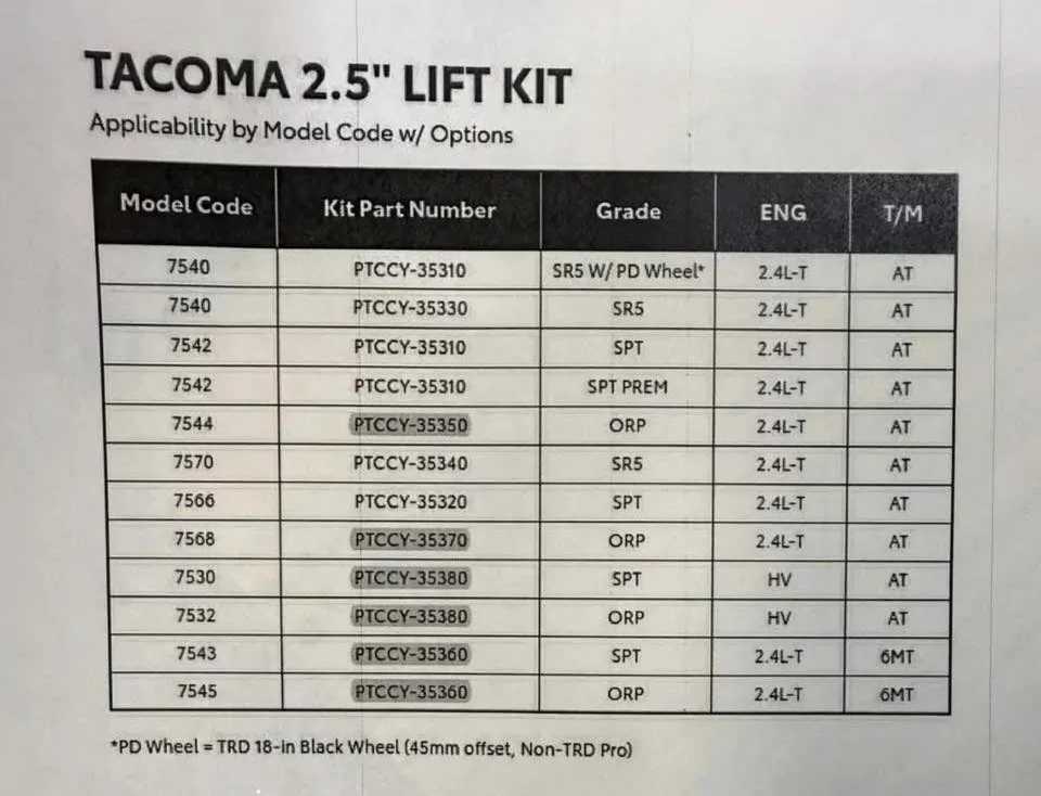

I have a 2025 Limited Taco and wondering which OEM TRD lift kit would be appropriate? Parts dept shows a few different variants of the OEM lift kit and which grade it addresses but Limited is not listed shown below. Does anyone know which one would be appropriate for the limited and what the differences are for each kit? Or is there a way to find a breakdown of what components are in each kit?

The Limited has AVS. I’m not aware of any lift options, yet?

Thanks for the reply MT! Are you aware if a simple spacer leveler would impact the AVS as well?

Fill us in what you hear, I don't mind the Limited suspension and ride height as I don't intend for this truck to be an offroader, but do wonder what average lifespan and weak points of these magnetorheological shocks are vs standard shocks should one die out of warranty.
