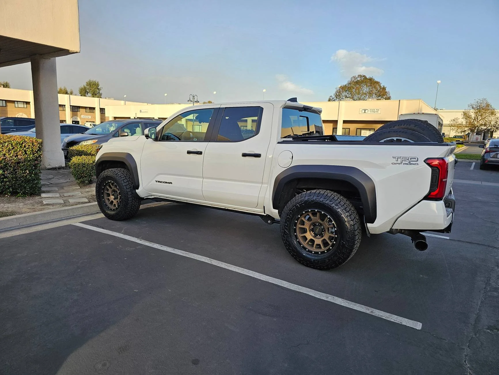

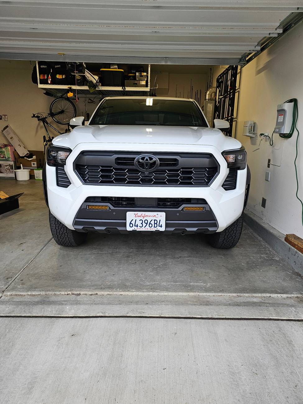

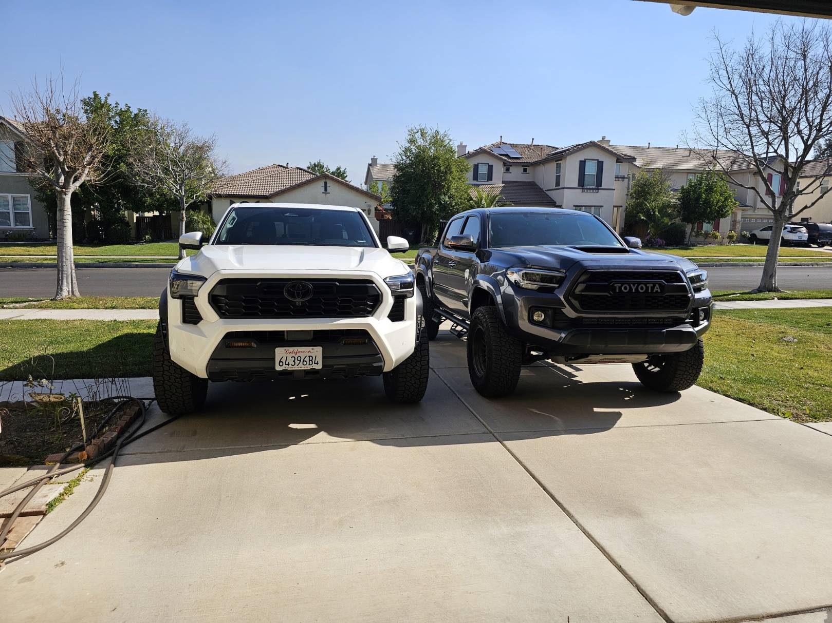

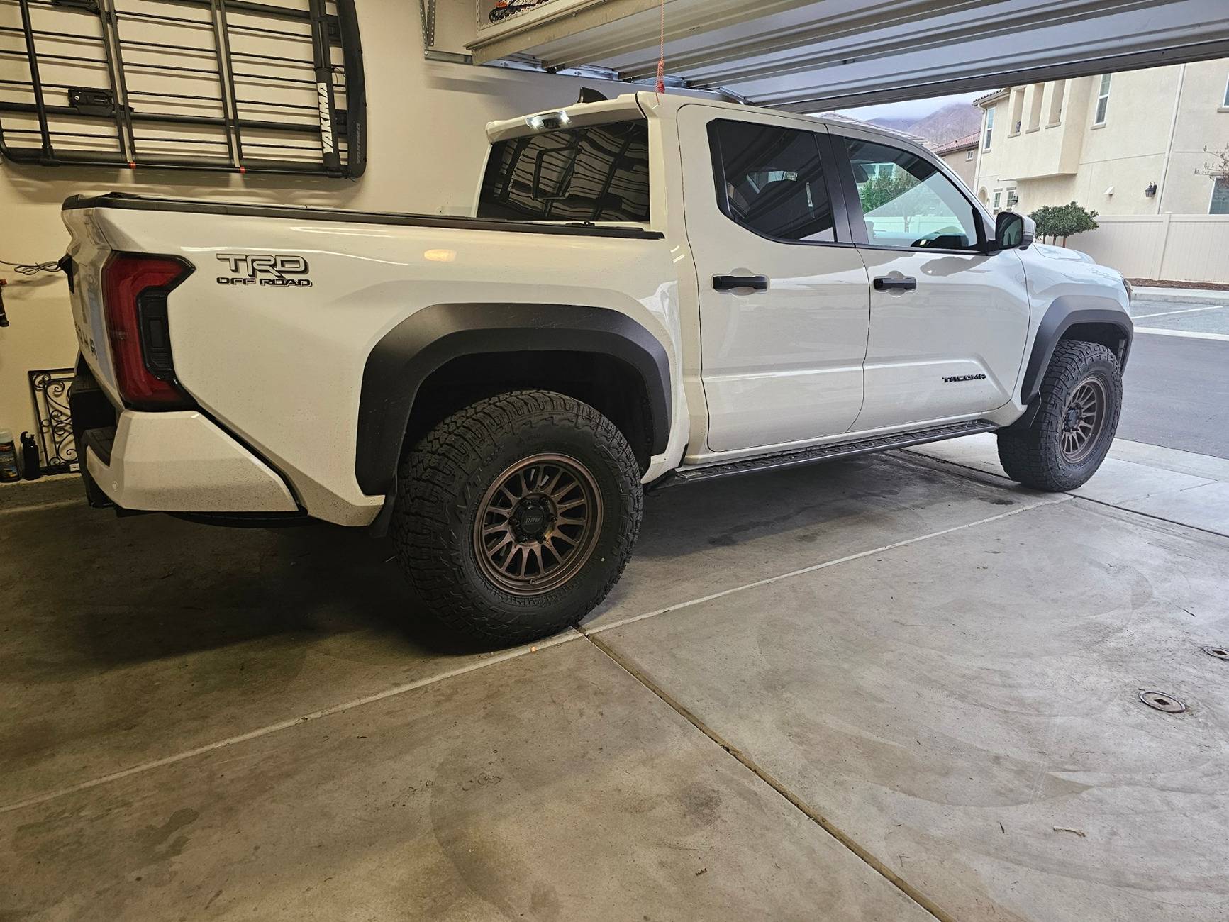

Hi All,
Bought my '24 Off Road Premium in October and been lurking around the forums.
This is my first truck, came from smaller coupes (Scion tC & Acura Integra). Told myself I wouldn't mod this truck but it didn't last very long!
My brother has a 3rd gen and gave me his old RRW RR5-V +0 offset rims and those started off the mod bug.. ran those rims for a bit but the +0 offset was too aggressive for me so I switched it out to the RRW RR7-S in a +25 offset.
Current Mods:
RRW RR7-S 17x8.5" +25 wrapped with 285/70 Falken AT4W
Musology CF interior trim
Rigid 37201 amber fogs
NYTOP sliders
Rough Country bed cover
Ark Microflares
Lasfit floormats + bed liner
Looking forward to making use of this truck for camping and fishing adventures. Was tough loading all the gear in my little Scion.

no lift or leveling kit? do you have any rubbing on your turns? and how much poke do you have, 1 or 2 or 3 inches? thanks! really nice ride you got there.

No lift or leveling kit and no rubbing at all. Little less than 1.5" poke.
I did remove the covers that are held on with clips since I rubbed on it when I ran +0 offset rims. Crash guard thing is still in place.
