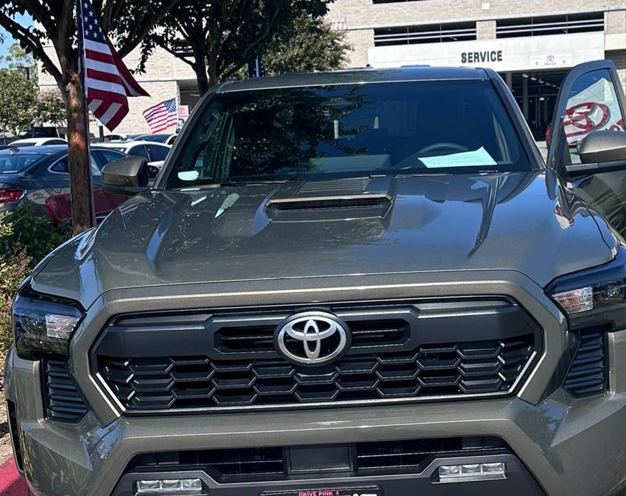

Someone else has this issue?
One morning I left my house, traffic was very fast on the avenue, I looked at a space and got in but I didn't imagine that my Tacoma would get stuck in second gear, I got nervous because the cars behind were about to cause accidents, and they almost hit me, It didn't change into third gear and on the next street I parked to see what was happening, but nothing could be done, it only ran in second gear.
In my case my tacoma 4gen it's not in the TSB VIN LIST.
What is the real problem with tacoma 4gen transmission? Any ideas?
