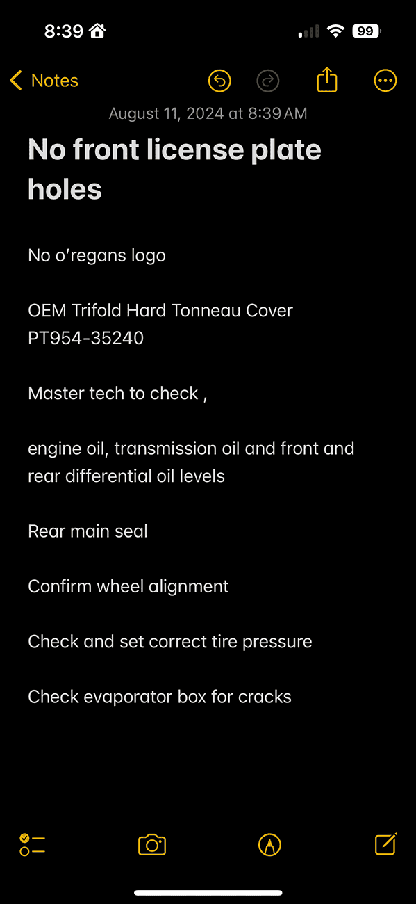

Does anybody have the Toyota procedure for filling the new auto transmission, in case the dealer gives me a hard time about asking to verify all fluids are where they need to be? I'm assuming it needs to be run to temp and added until it weeps from the fill hole
And edit, this is my current list, ignore the add ons lol
