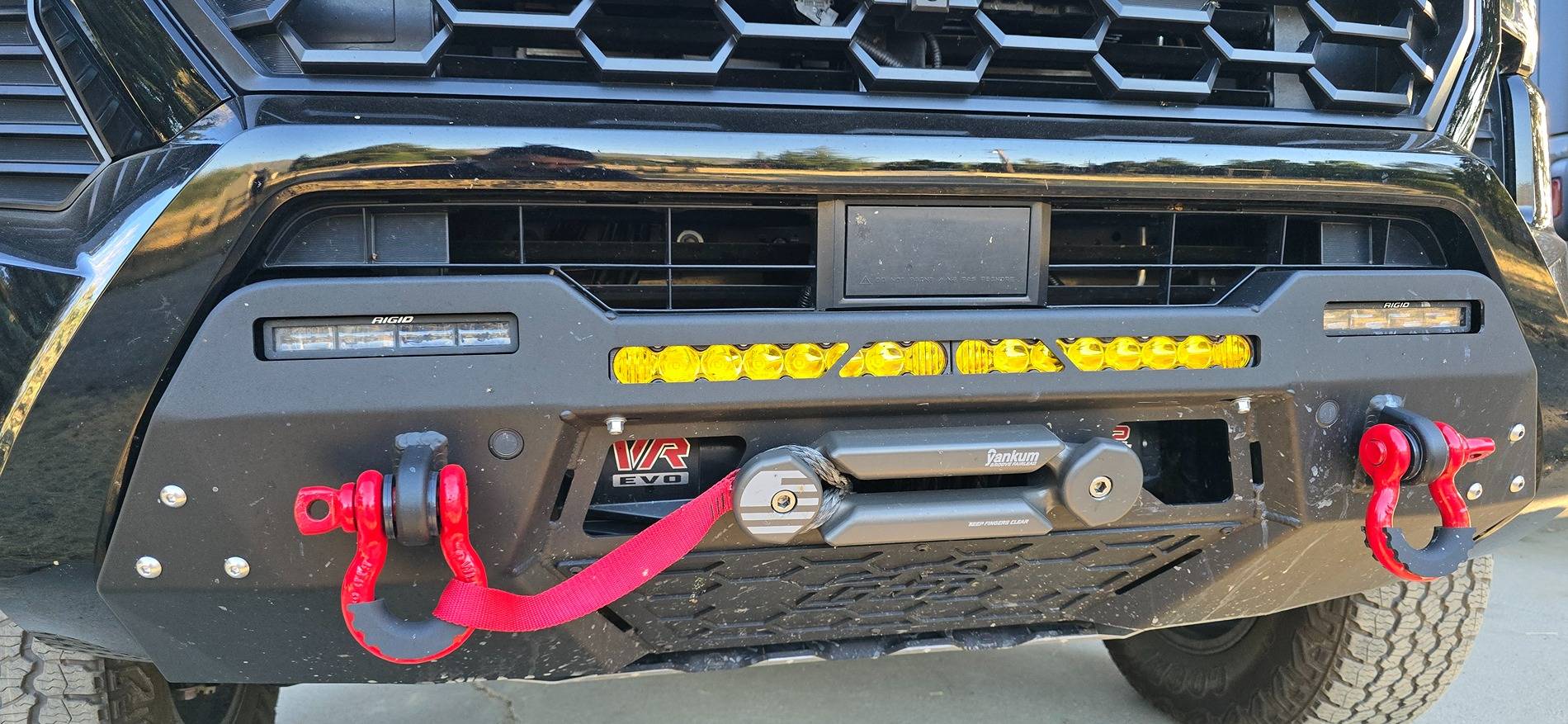

So I keep seeing people install these 11,000Lb rated recovery hooks... but no way this thin metal and small welds are rated for it? It actually looks ridiculous lol.
ChatGPT says " The front “recovery” (really tow) hooks on the 2025 Toyota Tacoma are not officially rated for vehicle recovery or retrieving stuck vehicles. According to Toyota and multiple owner reports, they aren't designed or rated for load-bearing recovery use "
Is this true?

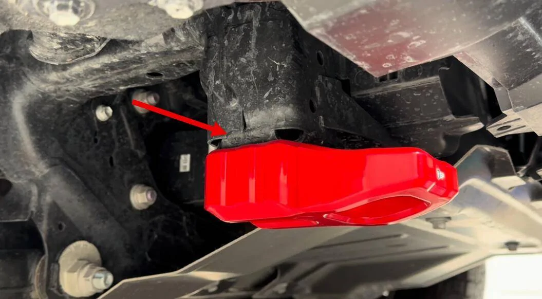

As typical with modern manufacturer's, they are just fine for winching up a wrecker.

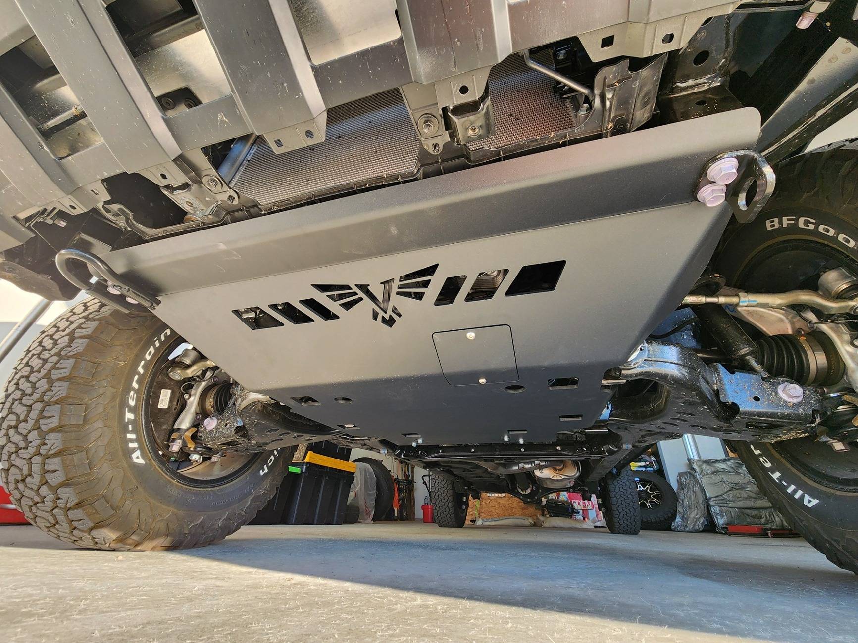

The red hooks can be rated to 11.000lb but that doesn’t mean the bolts or the welds are. The only way to calculate that is measuring the thickness of the material and diameter of the bolts and type of thread on them.
