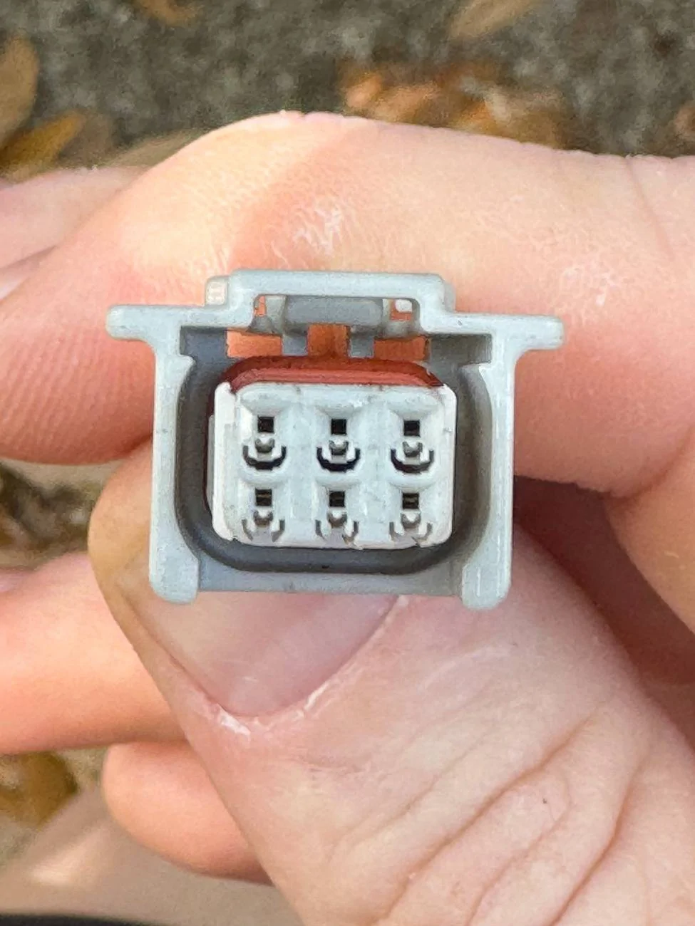

The Ironman bumper came with parking sensor extension cables, I'd look to see if you can find some for your install. They've got to be out there somewhere.
I ended up buying a 12k winch that is confirmed to fit my bumper. The weight and price difference are minor between a 9.5k and a 12k.
Is there a part number for those parking sensor extension cables?
