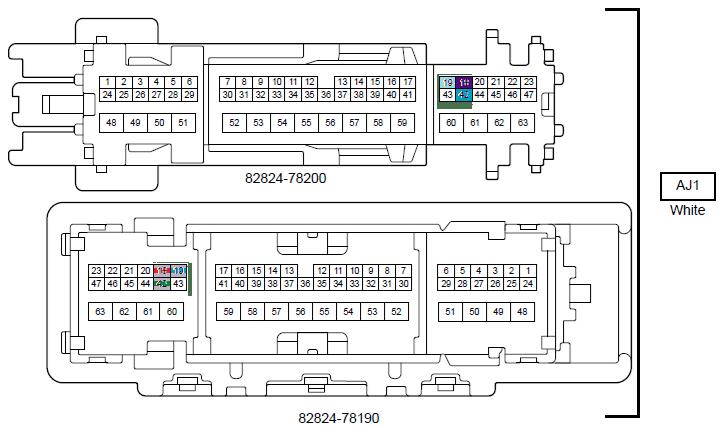

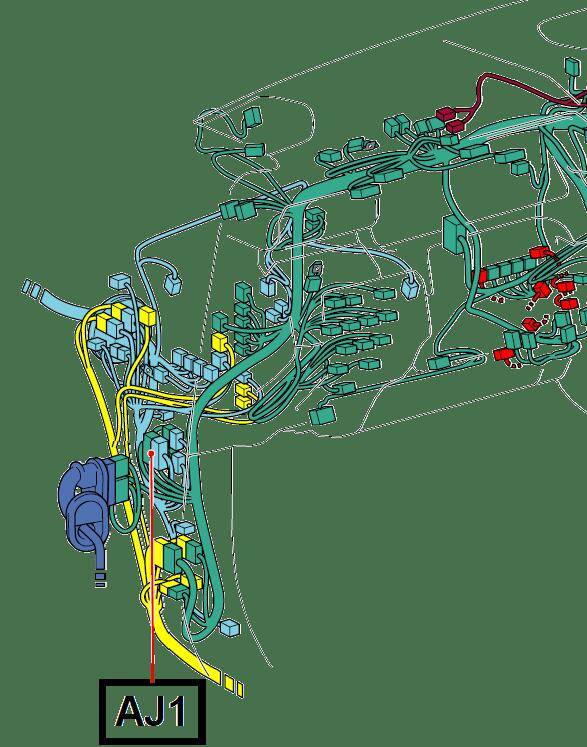

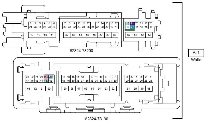

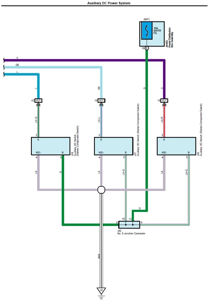

I am wiring in AUX switches and have everything sorted except i am wondering where i can tap off from J92. Does J92 run to any of the other switches in the panel like 120V or power tailgate?
just looking to slice and send power to my Caliraised switches. Thanks
