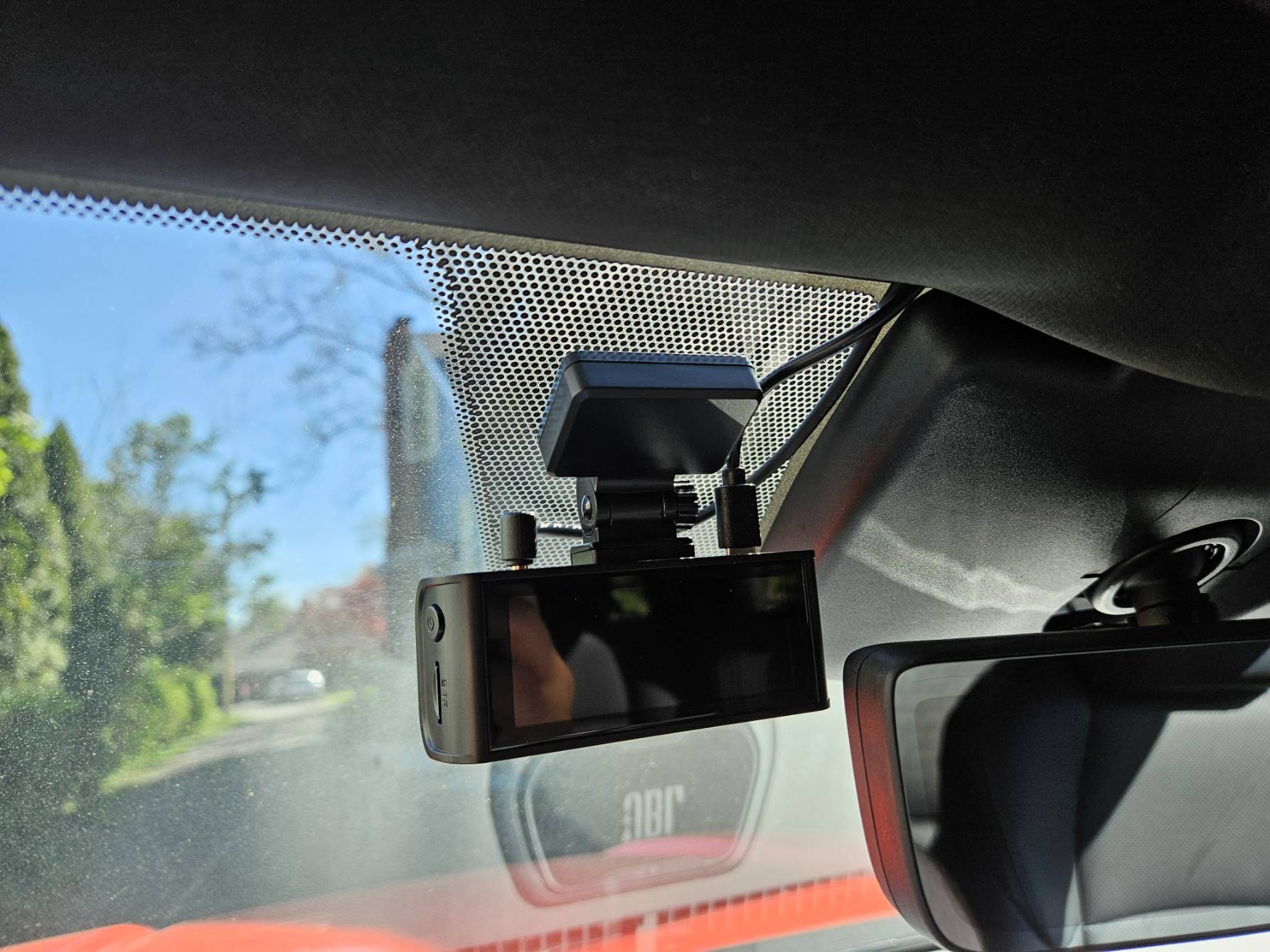

I know https://dongar.tech/ makes a solution but I wanted to make my own for less because I’m cool like that….
While I was waiting for my truck to arrive at the dealer, started doing some research. I wanted to find a dash cam hardwire solution. I found the new 4th GEN trucks are pre-wired with a pigtail to connect the OEM dash cam sold as an option for $500.
I ordered one part from AliExpress and another from Amazon.
I successfully hardwired my Viofo dash cam. Came out super clean.
2024 Tacoma Installed dash cam using factory pigtail connector IMG_3688

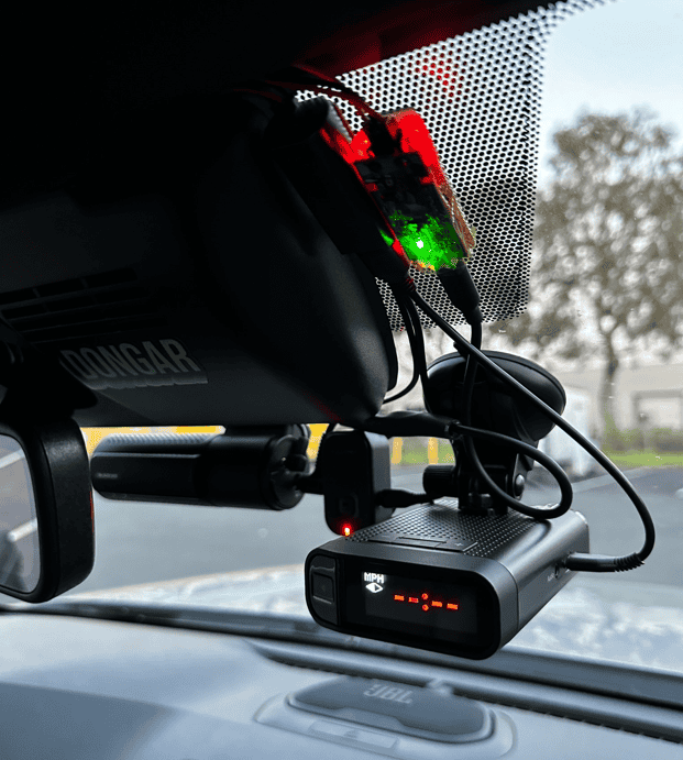

Do you all have any products to connect radar detector native RJ11 cords?
For our current product line, this works just fine in conjunction with our dashcam adapters: https://www.stickerfab.com/products...ne-uniden-radar-detector-power-cord-universal
For our upcoming USB-C products, you could use one of these: https://www.stickerfab.com/products...r-power-cord-universal?variant=44323500458303
I'd say though that since you have two ideal connectors both already at 12V (the 5-pin connector dashcam harness in the domelight, and the 10-pin autodimming mirror connector under the rearview mirror plastic shroud) it would probably be a quick DIY project to use a product from mirrortap or one of the many clones on Amazon. Their stuff has friction-fit pins that slip into the back of the connectors.
I'm somewhat a fan of the stuff from Radenso which performs well for $350: https://www.vortexradar.com/2021/08/radenso-ds1-initial-test-results/
Here it is running off a USB-A to USB-C cable + dongar dashcam adapter, powered from my autodimming mirror:
