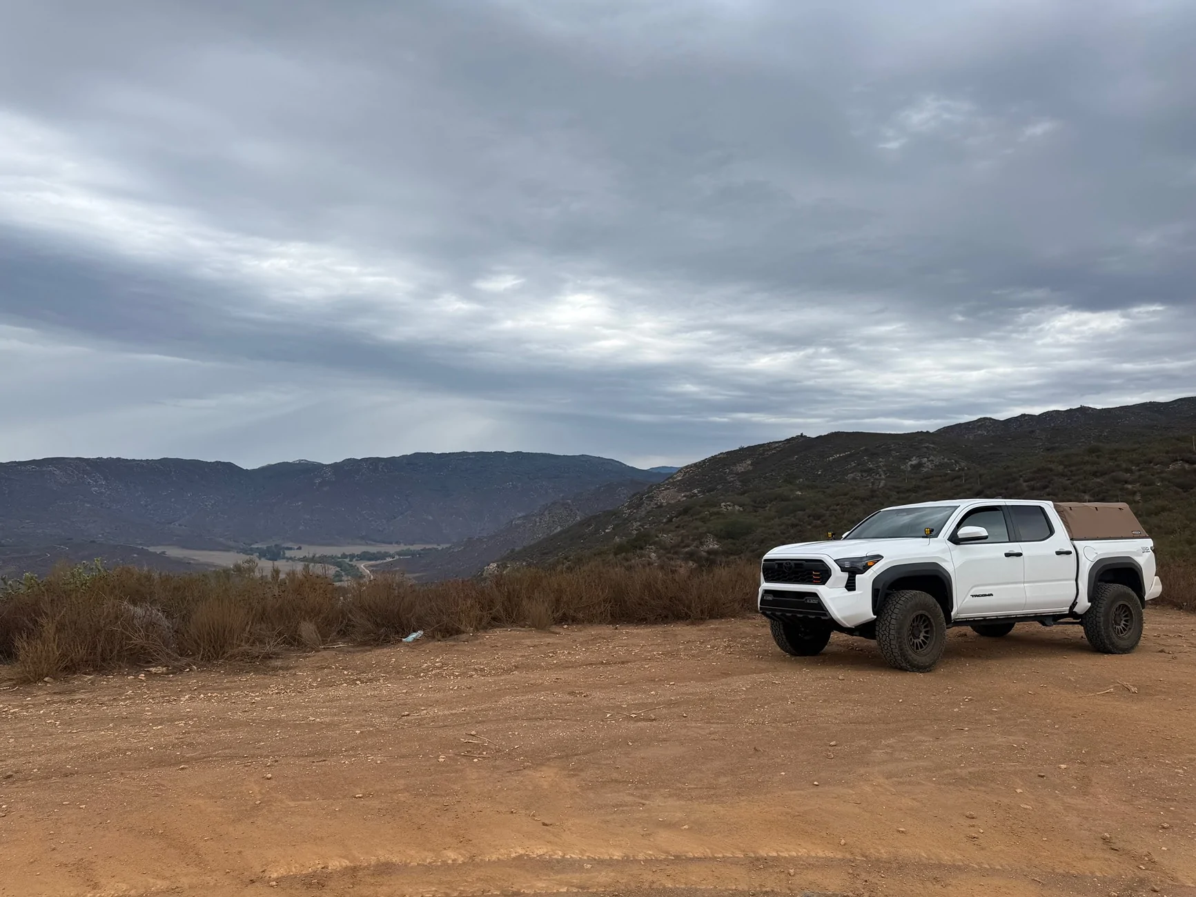

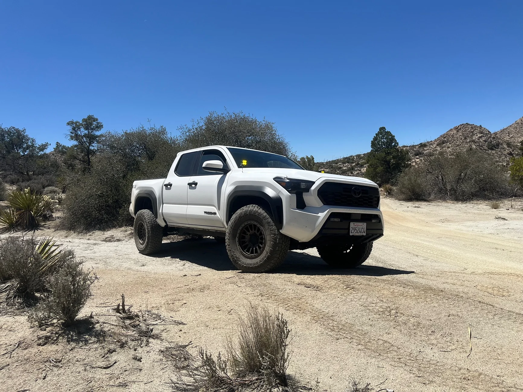

After years of daily driving my Jeep TJ trail rig and my old evo 8 I finally decided to get a decent daily that would still scratch that trail running and camping itch. I bought it brand new in November of 2024 and walked out for under sticker including California’s fees. Told myself I would keep it stock for a while and that lasted all of 6 months (a record for me) before changes began to be made. My first upgrades were a Peak 1.25 spacer lift, some RRW RR-7h’s with 17x8.5 25 offset wrapped in some 285/75r17 c-load Toyo Open County AT3’s and some Baja Designs Squadron Sports on SDHQ mounts. Came out pretty nice if i do say so myself!
2024 Tacoma Justin’s do-it-all TRD Off-Road build IMG_7079

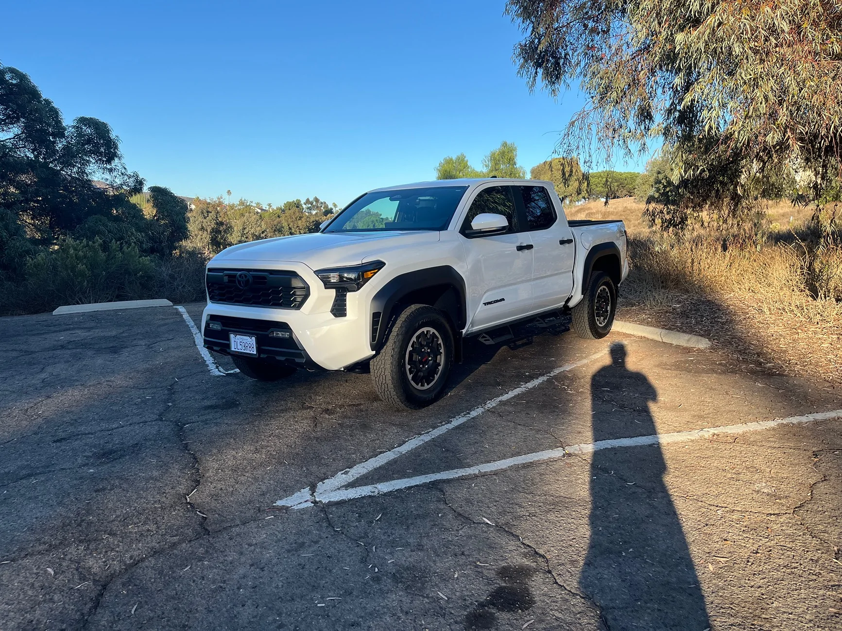

This setup works beautifully, was easy to get aligned, doesn’t rub and didn't kill my mpg’s. I will be doing another small suspension upgrade in the near future but i cant complain with how it currently sits. I have taken it on some mild stuff here in so-cal such as Sandstone Canyon and apart from the trans getting hot in 4-hi i’ve had no complaints. Next changes after the suspension were a Softopper to add a little functionality, some ARK micro flaps and the Sixth Element trail pipe.

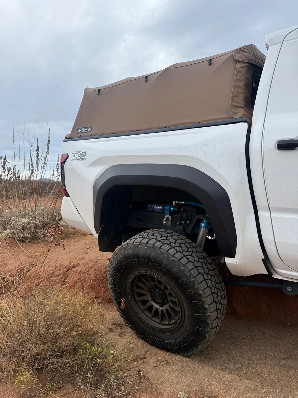

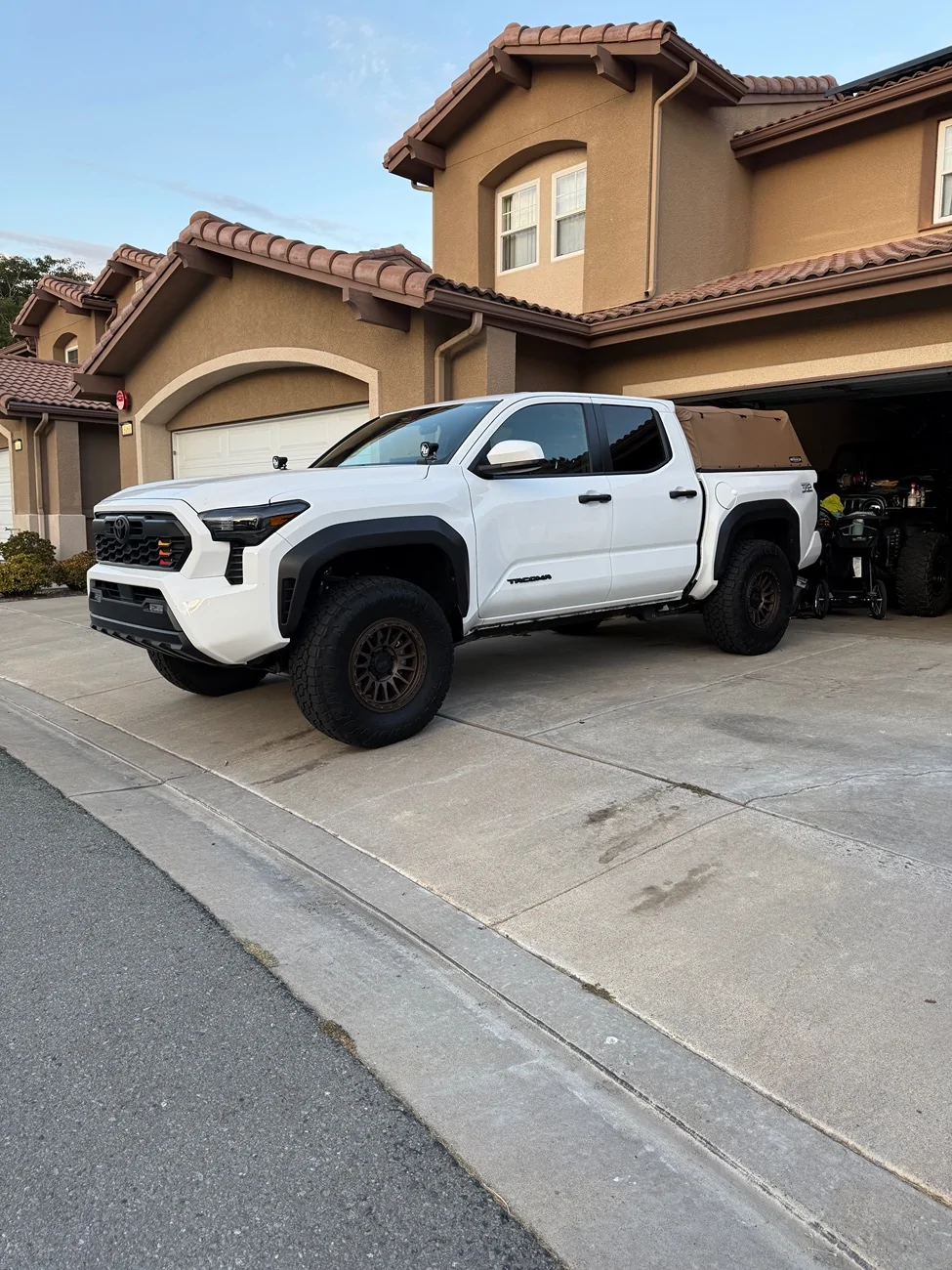

The Softopper has to be one of my favorite changes to the truck, super easy to install/remove and makes it easy to load up for beach days or camping trips. I also installed a Banks intake because i missed hearing boost noises and thats how she sits for now! Currently waiting on my next few parts, an RCI engine skid plate, some Restless sliders and am currently working on an Auxbeam setup. I look forward to sharing where this build goes in the future!

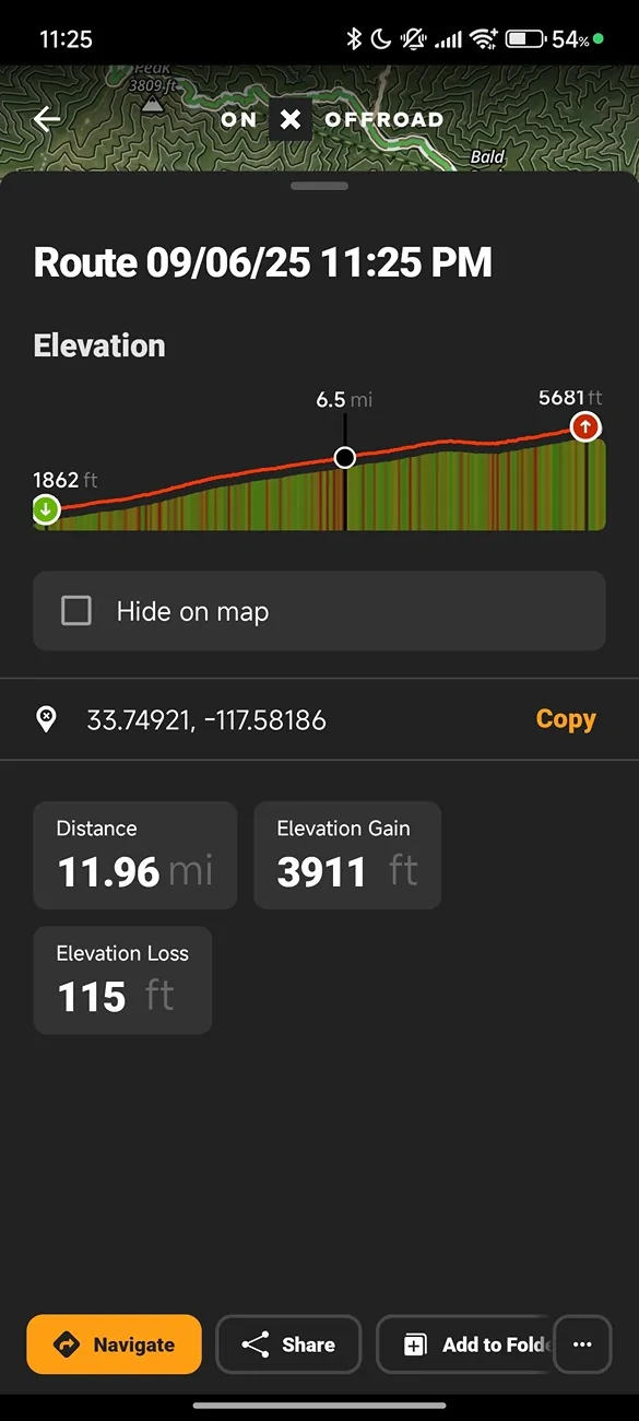

I did this:
Started off in 4Hi, but switched to 4Lo after trans temp hit 240F and then it decreased to about 230F until the peak of the climb. Hit 240F in about 3mi before I switched to 4Hi.
240F is just over halfway on the trans temp gauge, it doesn't move much from 170F to 230F.

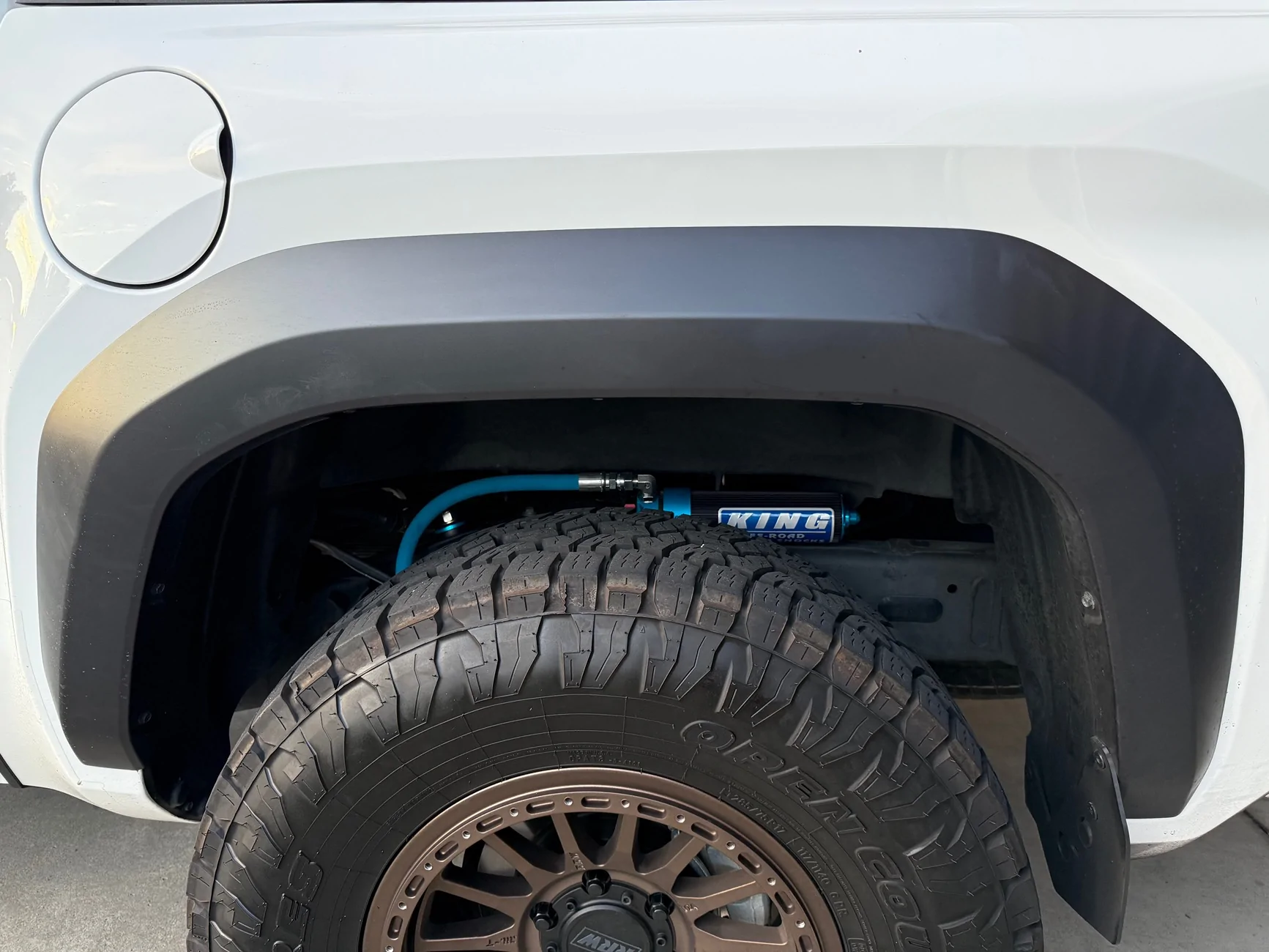

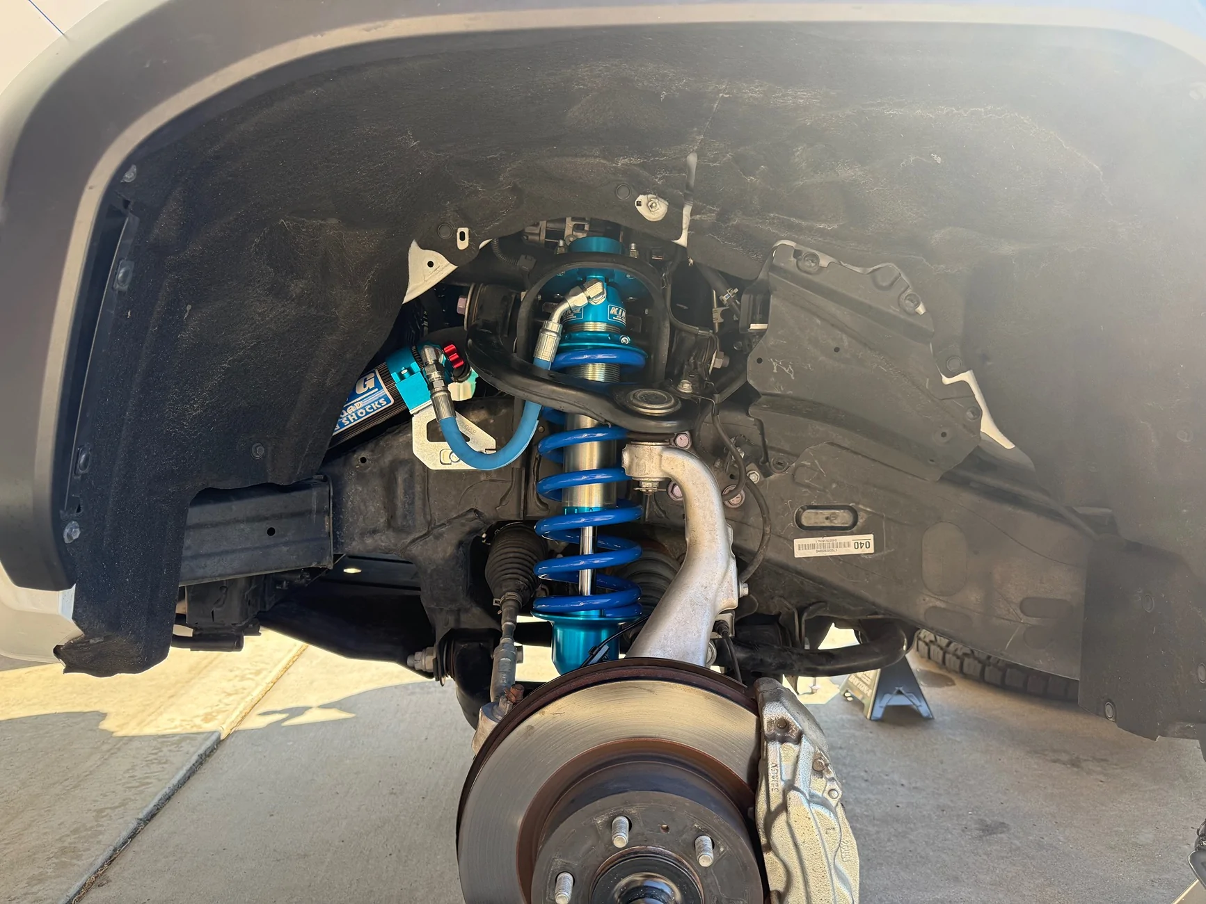

Update: small suspension upgrade turned into a big one and i got spendy on some kings!
2024 Tacoma Justin’s do-it-all TRD Off-Road build IMG_8561
2024 Tacoma Justin’s do-it-all TRD Off-Road build IMG_8566
These were very simple to install, clear and concise instructions and the setup as it comes from factory fit my truck beautifully! I look forward to getting some miles on it so i can give a full review on whether or not its worth it to drop so much on suspension!

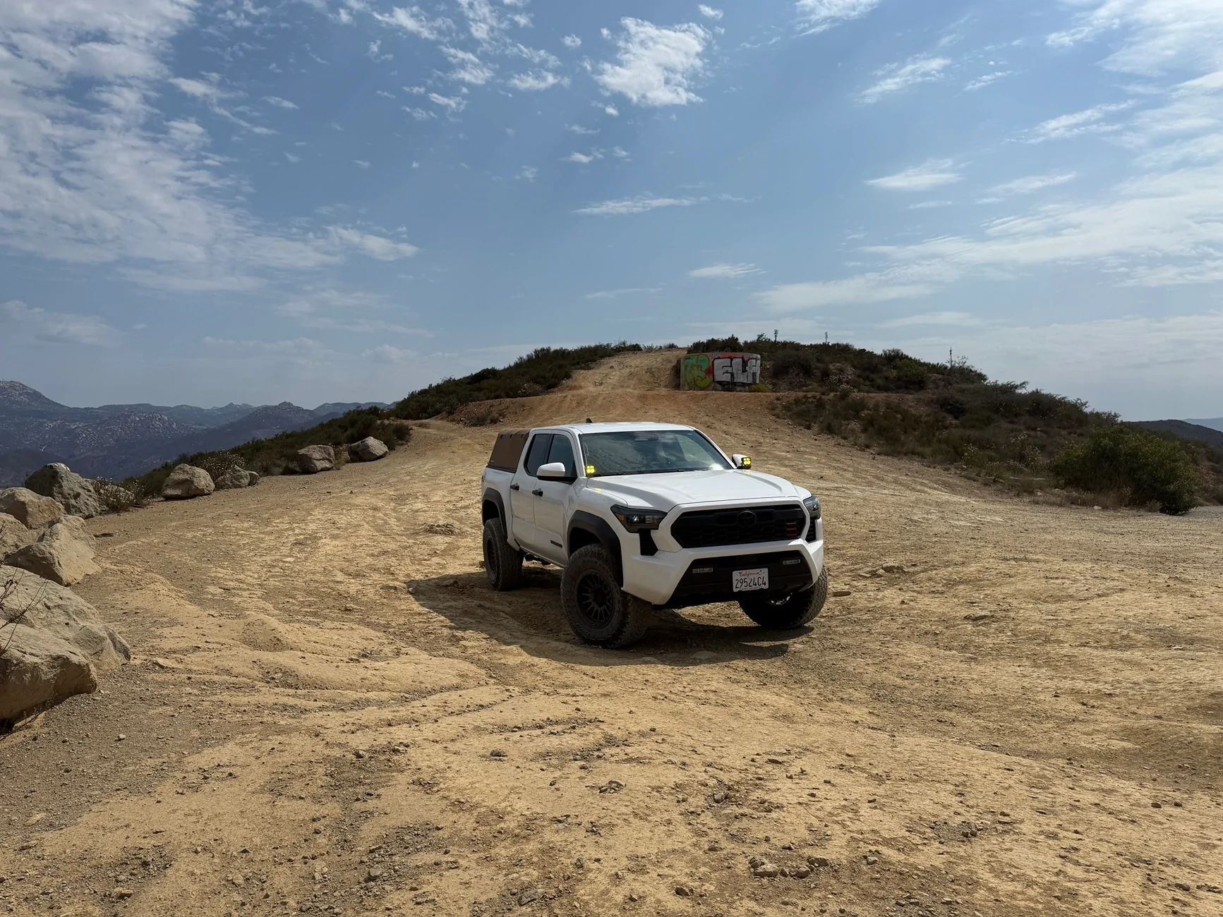

Took the truck to the Santa Ysabel truck trail yesterday as a shakedown on the King suspension, i have to say i am more than happy with how it performed! The damping over corrugations was wild and the way it smoothed out the trail is awesome! I believe they ate worth the money!
2024 Tacoma Justin’s do-it-all TRD Off-Road build IMG_8596

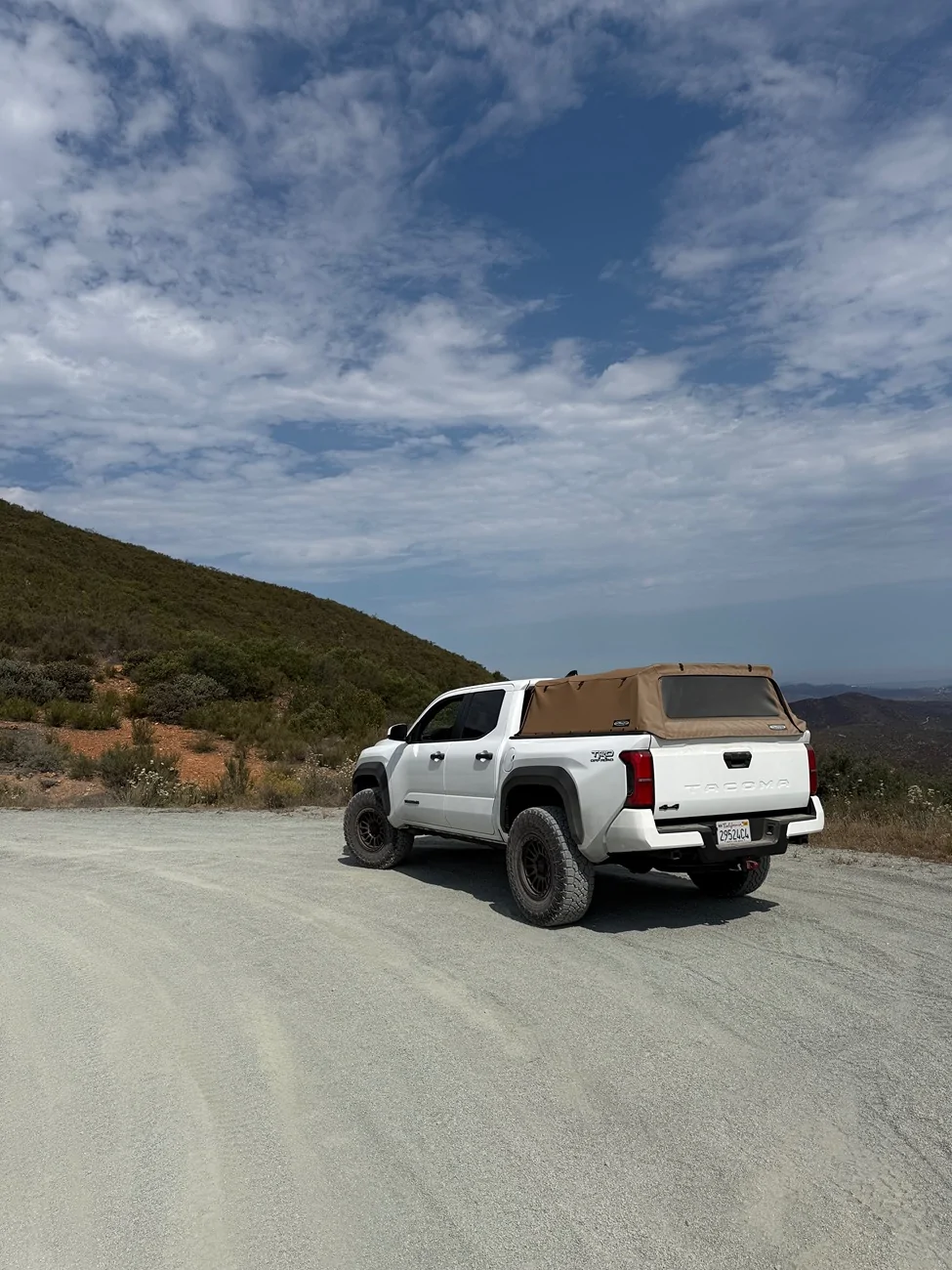

Articulation was smooth and it really did smooth out the trail! Next up will be a skid plate later this week and sliders whenever mine are done being built. It is really shaping up to be a solid little rig off road and is still a perfect daily.
