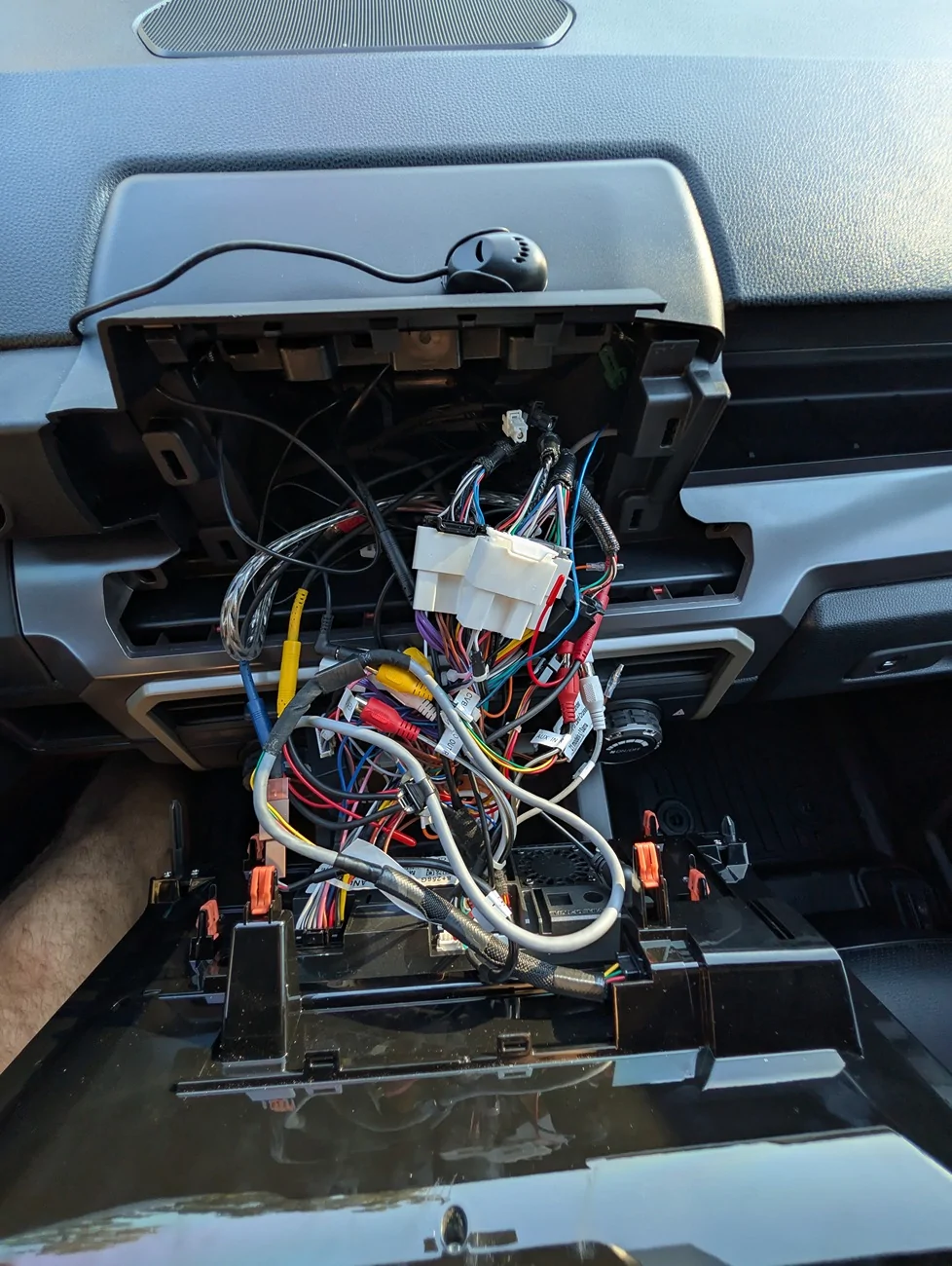

The wiring harness ends up being a rats nest - I really don't see a clean solution but maybe someone with more patience than me could clean it up.

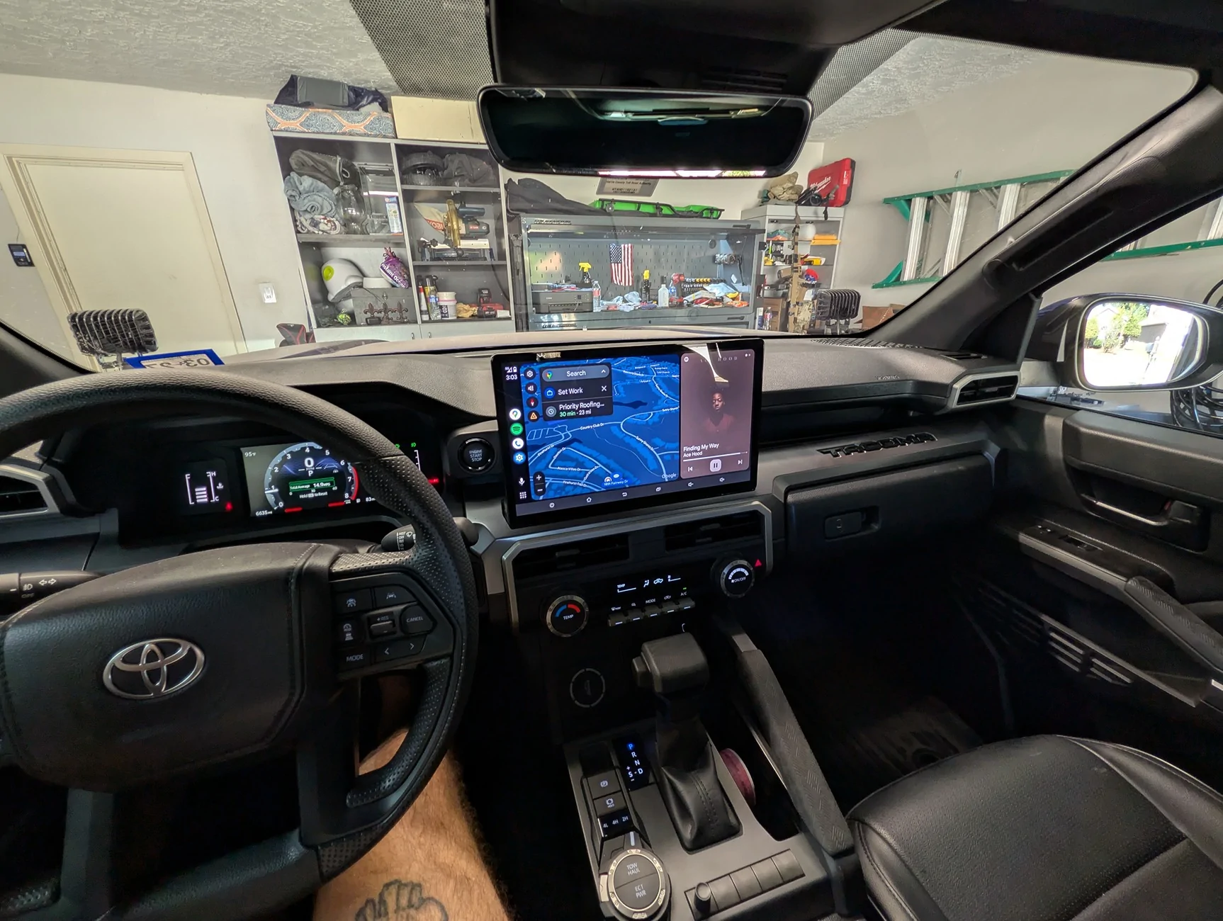

To be able to use any of the native apps while running Android Auto, you must have a dedicated 5G data SIM card. You can disconnect Android Auto and use Wi-Fi but must disconnect from Wi-Fi to reconnect to Android Auto because wireless Android Auto uses Bluetooth and Wi-Fi to connect.

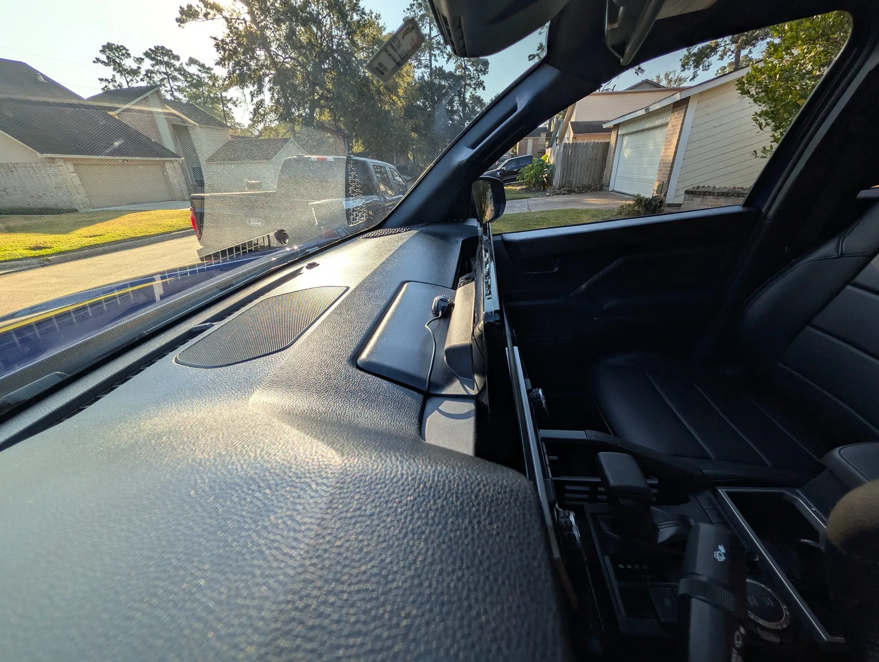

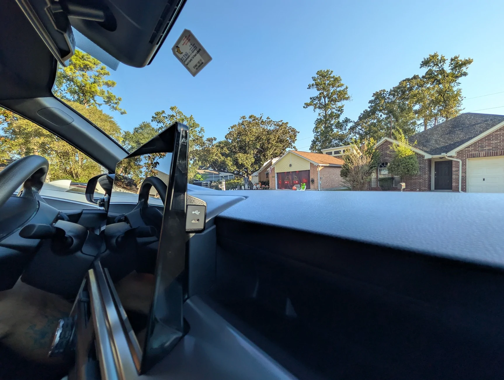

The whole unit is only press fit mount in the dash with clips. It does not use screws like the original screen.
You must harvest some of the clips and the factory USB port from your original screen.
The whole package comes with poor instructions. Luckily, most of it is dummy proof. A lot of connectors are unique. One particular issue I ran into was that they did not note that you must connect the orange Amp wire to the blue Remote wire in their wiring harness. If you are running an aftermarket amp, you will connect it to the same remote wire.
The system is not able to use your factory cabin microphone for calls, they provide an aftermarket mic. I really dislike this solution and am researching how to integrate the factory microphone.
There were one or two loose pin connectors in the wiring harness. A simple fix by just pressing them into the connector securely.

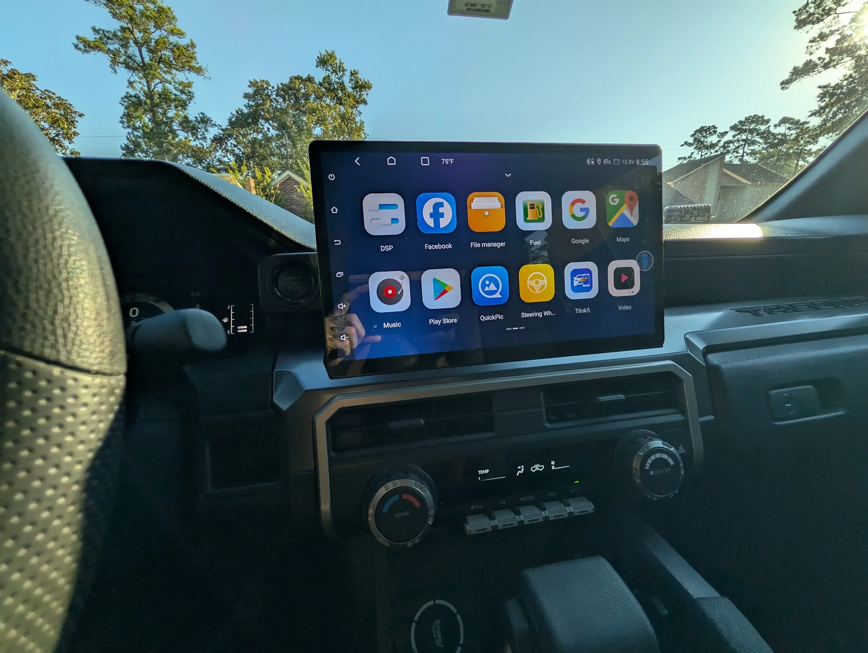

The native OS dashboard lacks customization but there is an option to buy themes. I haven't played with this much.

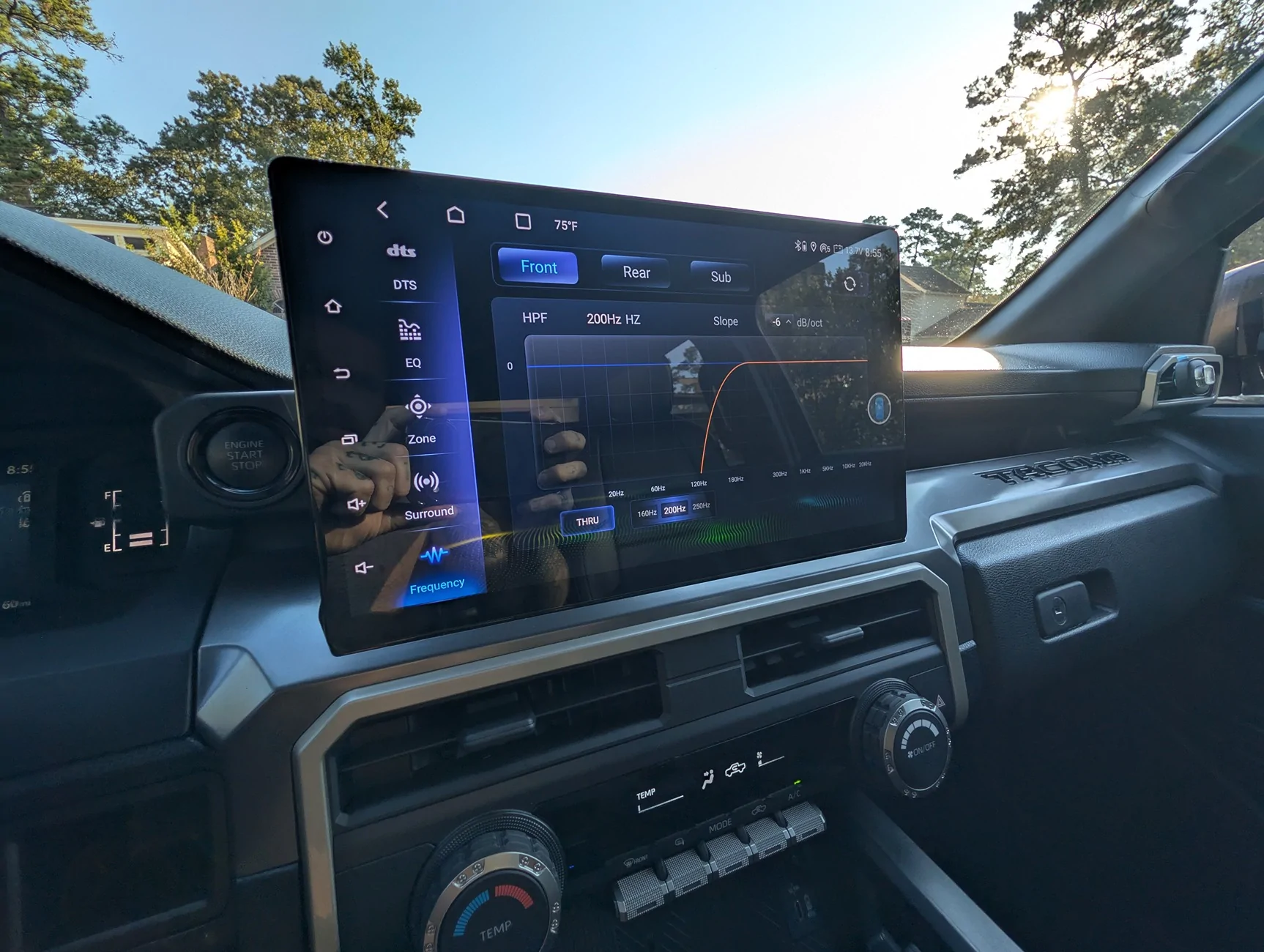

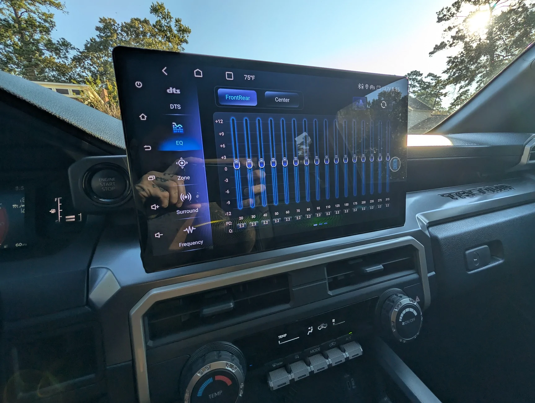

The built in DSP is pretty good from what I can tell. I'm not an audiophile so take that with a grain of salt.

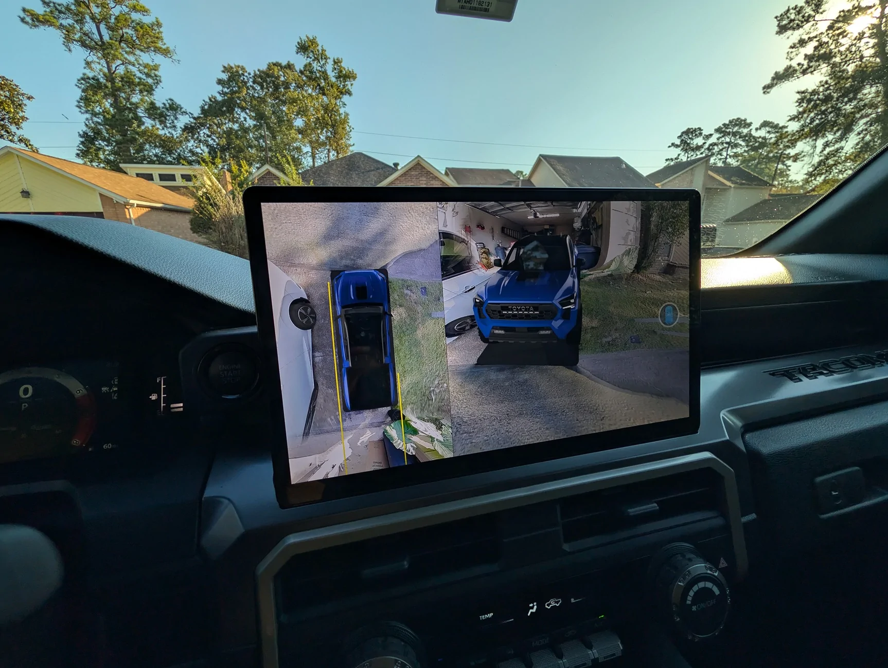

If you opt for the 360 Cameras, they require calibration with a specific calibration mat that you can also buy on AliExpress for around $30.

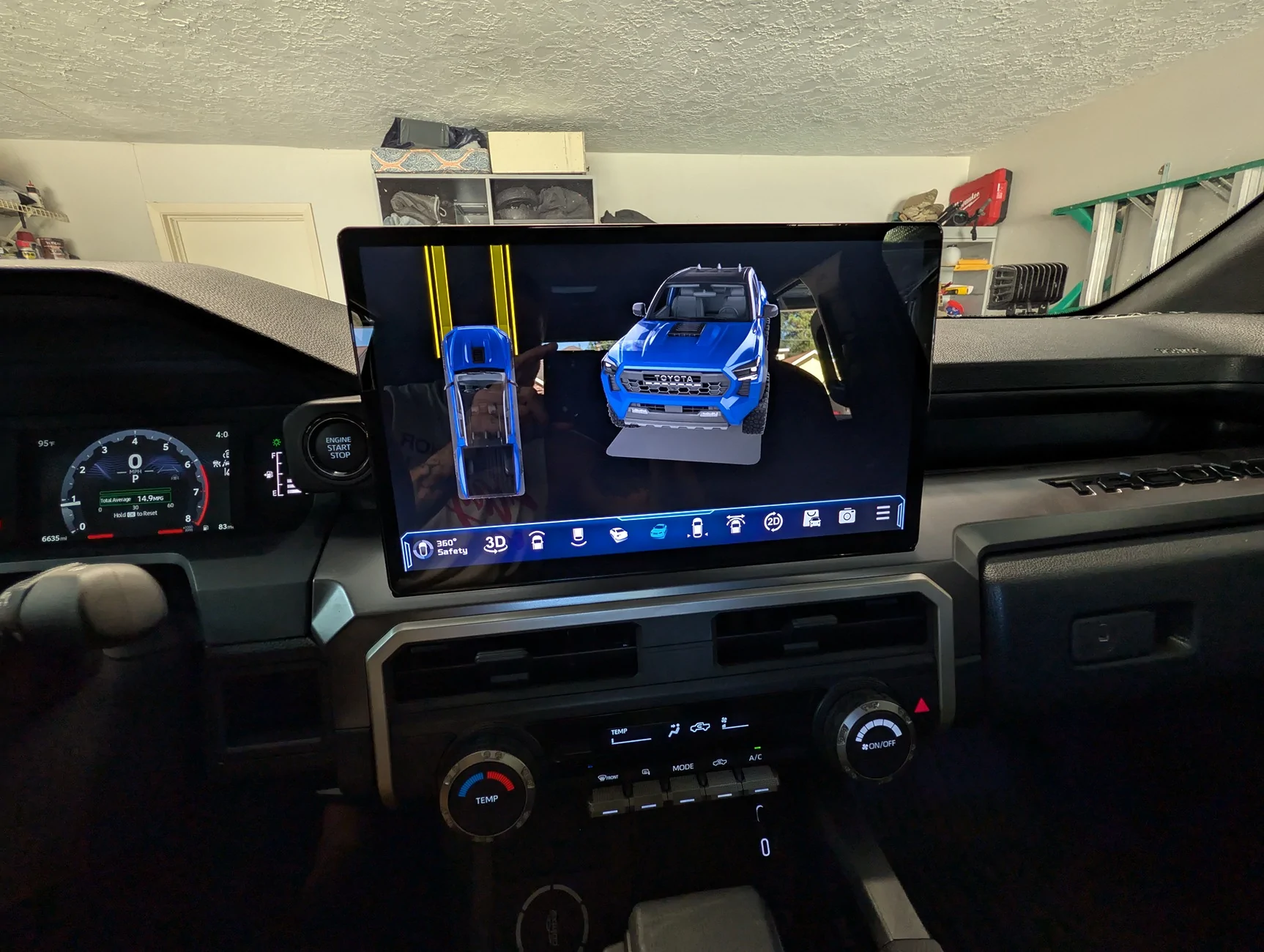

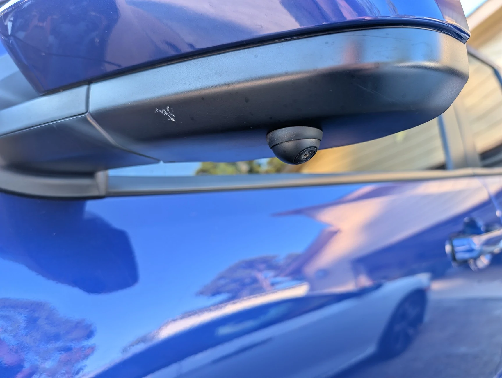

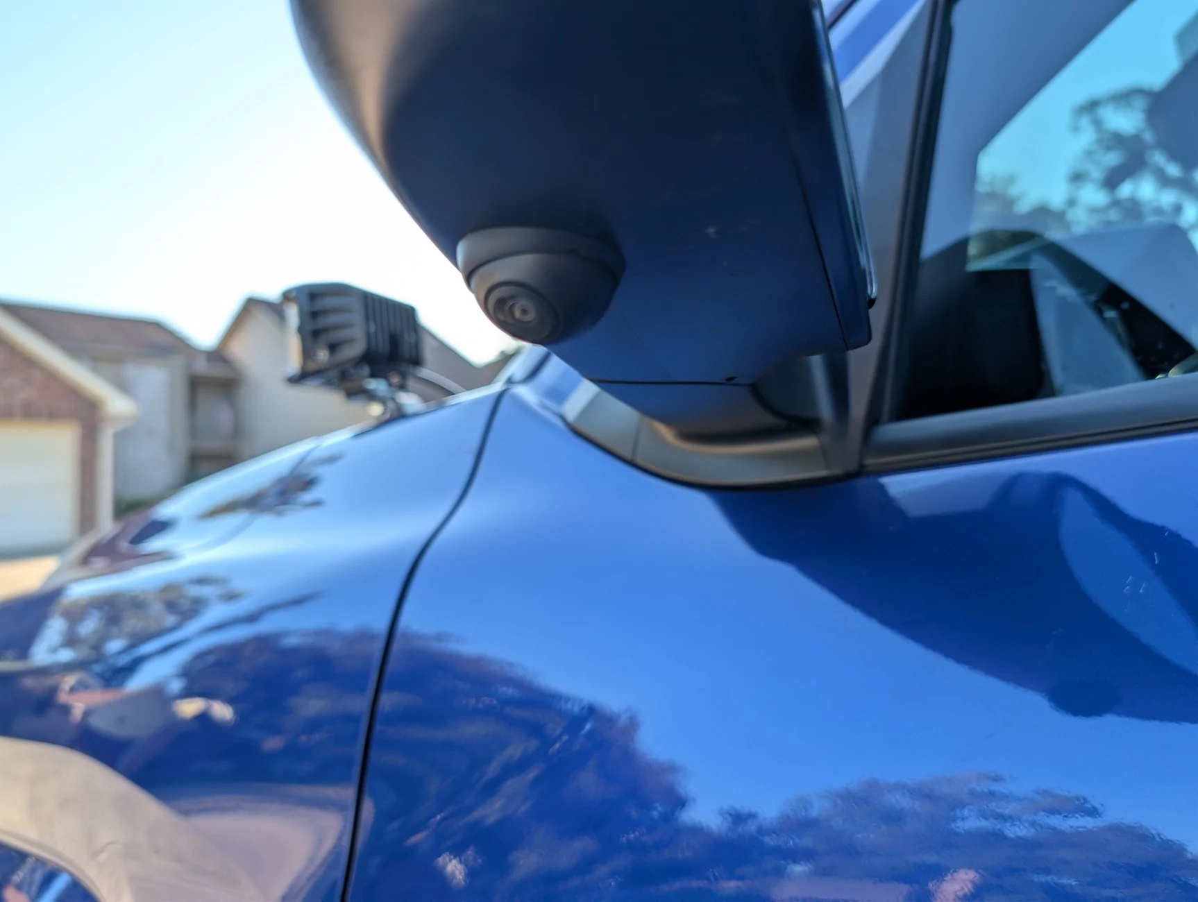

The 360 Cameras were a pain in the ass to install. I had to jerry rig my own mounting solutions for the front and back cameras - but they do use the factory cutouts. You must drill into your sideview mirror housing to mount the side cameras - it's daunting at first but came out pretty decent looking. Running the wire from the door to the cab is an absolute nightmare.
Calibrating the cameras was pretty easy with the mat I ordered. Overall, the 360 view is pretty sweet and I feel like I could spend some more time perfecting the calibration to get it to look really good.

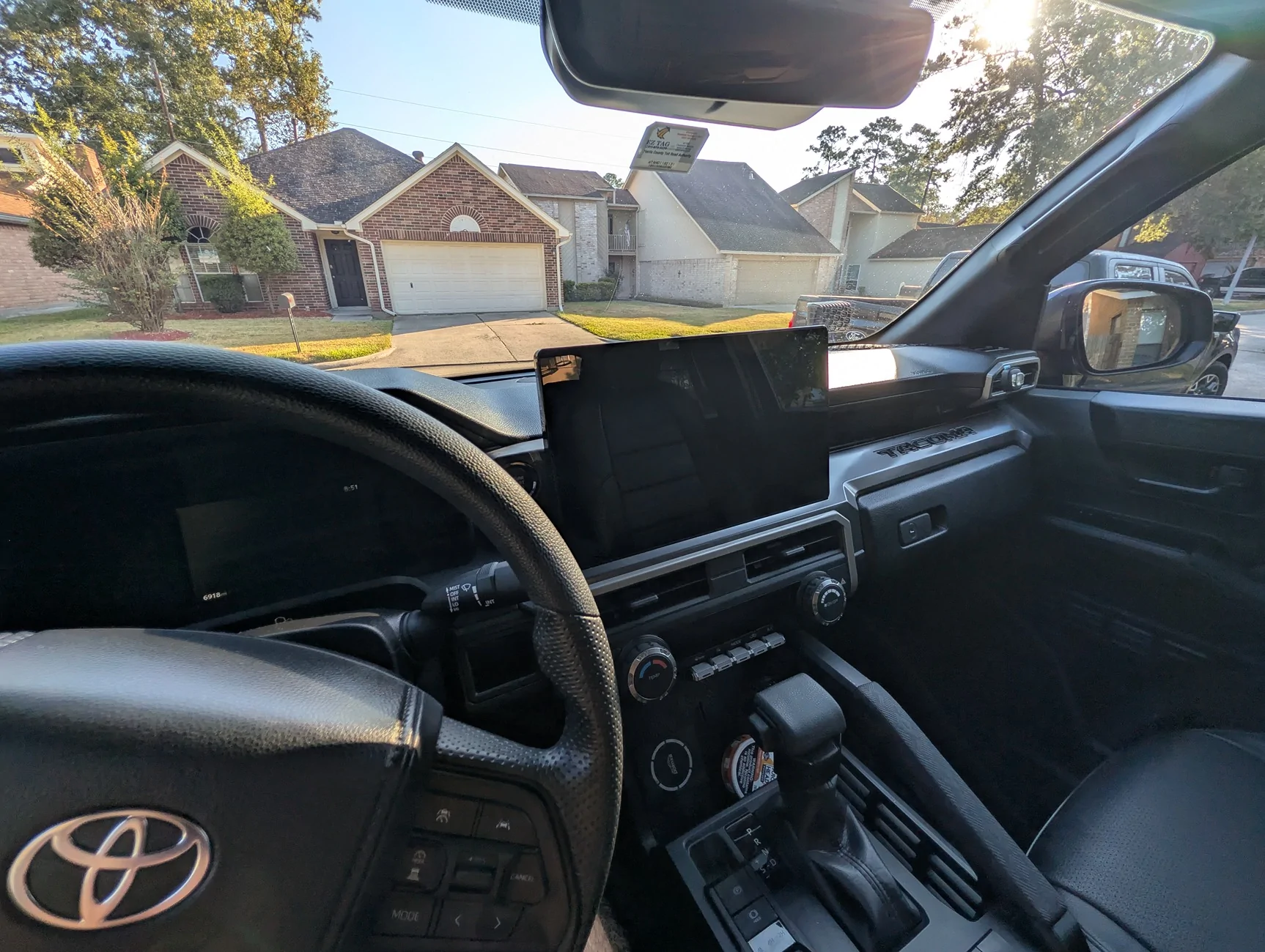

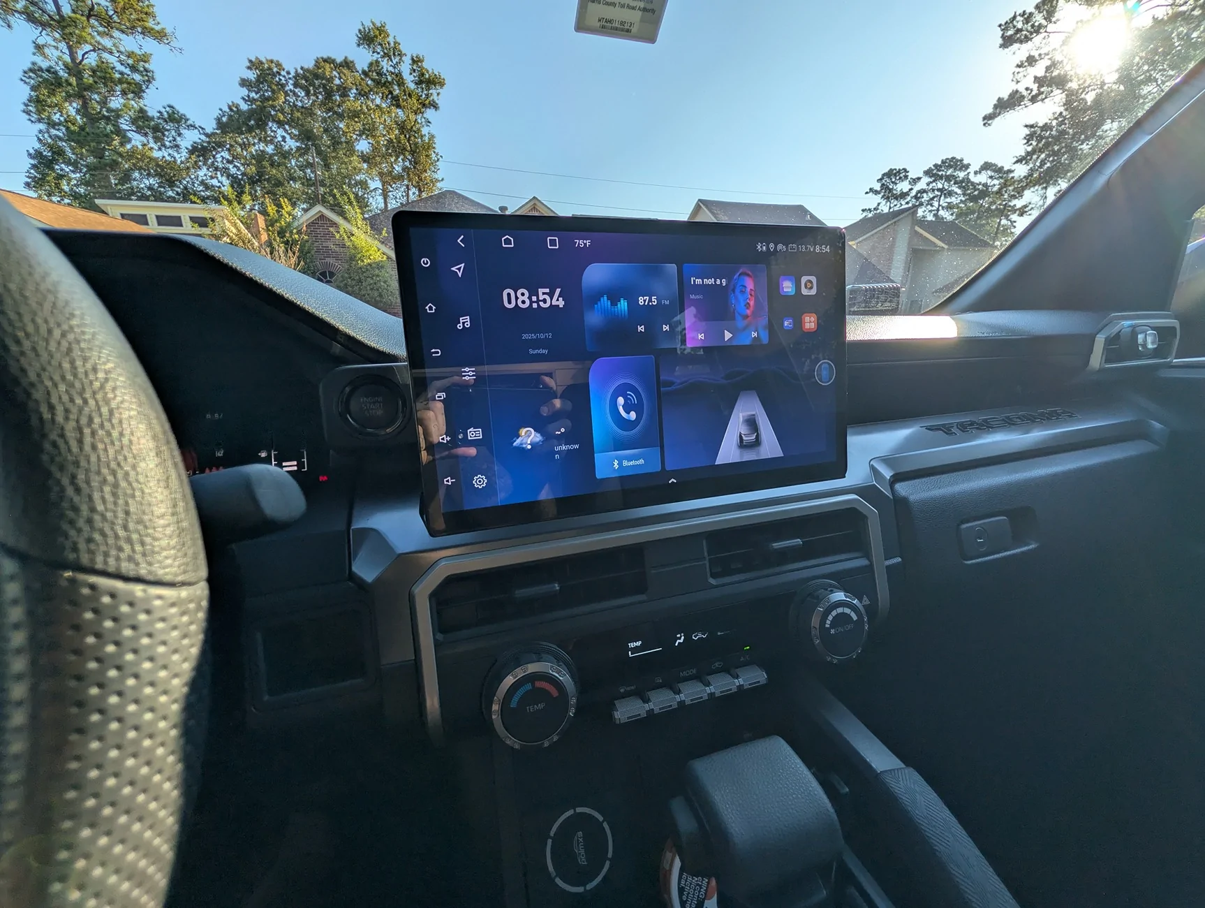

2024 Tacoma AliExpress 14" Display Android Infotainment System Upgrade (from 8" Screen) - My Experience PXL_20250928_200421362
2024 Tacoma AliExpress 14" Display Android Infotainment System Upgrade (from 8" Screen) - My Experience PXL_20250928_200331059

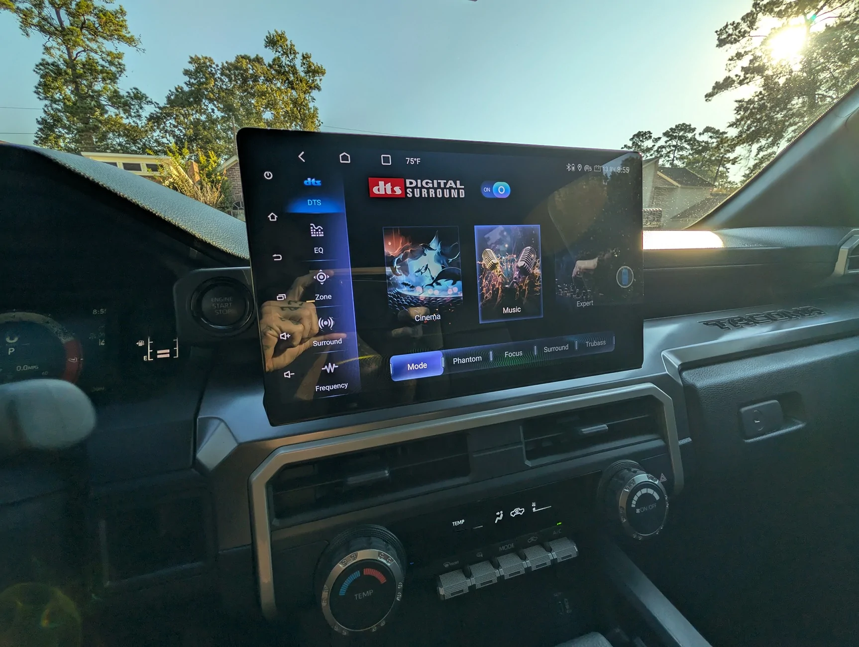

Here are some photos. The 360 view looks much better while driving but can be dialed in better with another calibration.

can you set the cameras to be on while driving as a live view?

I just got this unit installed on my 2025 4runner. Does your side USB work on the unit after harvesting the wire/plug from original oem radio? Mine doesn't seem to work when plugged into the android unit.
