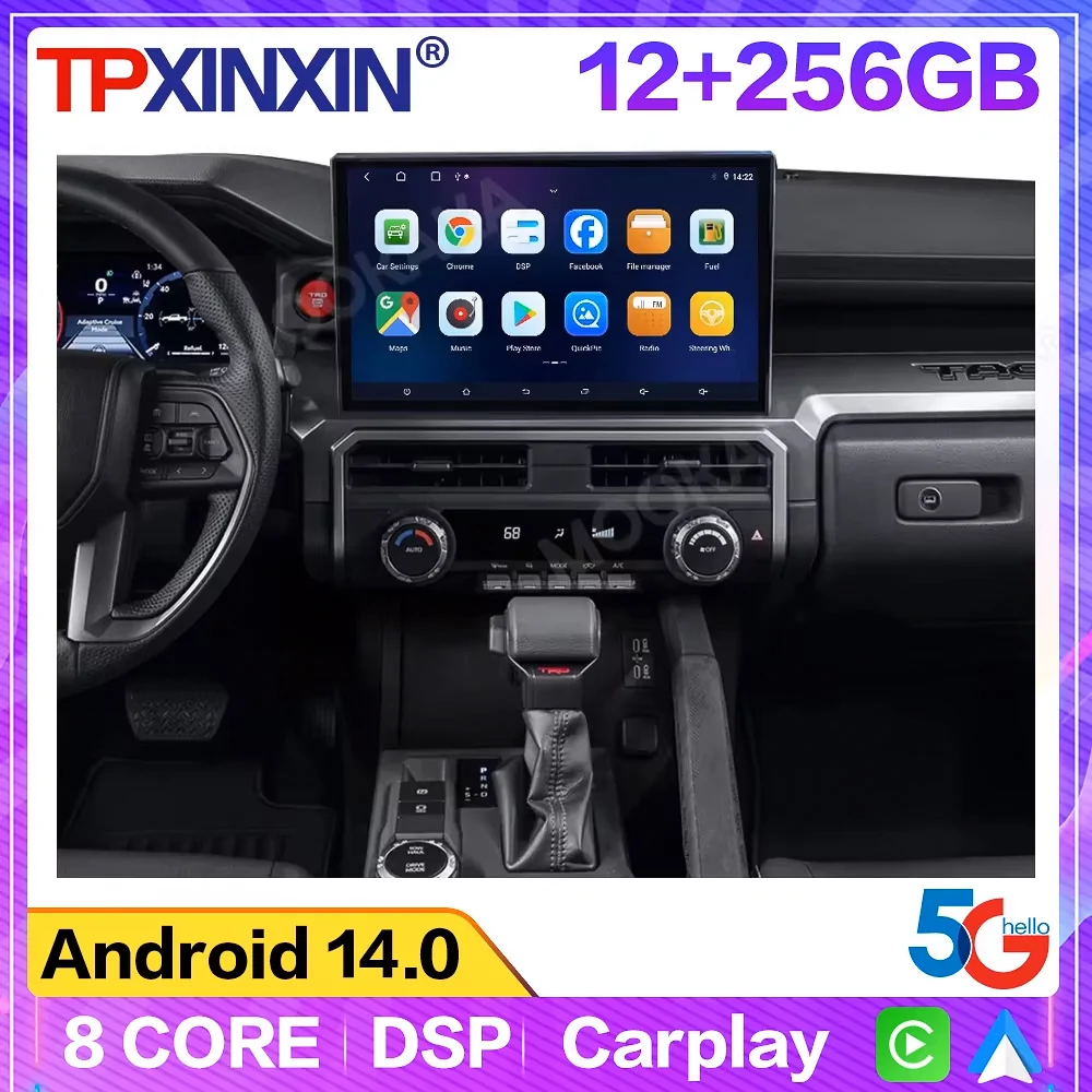

I have a 2025 SR5, and I only have a few items I don't love about the truck, one of them being the infotainment system.
It seems like our counterparts overseas are producing a 14.6" replacement for the factory 8" screen.
You can see the product here.
I'm sure none of us in T4G have purchased this particular unit, but I was hoping someone here may have experience with similar units for previous generations from AliExpress. I'm thinking I may be a guinea pig for this and just put it on a credit card for protection.

The off brand Chinese Android head units have been getting better and better over the last five years or so. There are still some duds, but if the seller has good reviews, and sells other products with good reviews, it could be worth it.

Interesting but I have questions.
For one it says it has a 4x50 watt output and it doesn't state anywhere how many ohms that power is delivered at. To me that sounds like it won't be directly compatible with the JBL system.
It's running Android 13, which is probably not uncommon but also is now three years old. That's not really a concern but it doesn't specifically say anywhere that it is licensed to access Google Play, and that would be a deal breaker for me, especially as expensive as it is. It does show the Play icon in some of the screenshots so it may be licensed but I'd want to confirm that before buying it.
You lose a physical volume knob. Again, probably not a huge deal, especially since they claim you still can use the steering wheel controls. Good thing b/c at least in some of the apps, like Google Maps, the bottom controls seem to go away.
Finally, my biggest concern would probably be not knowing what tariffs might add to the cost. I'd hate to buy it and then find out I owe another four or five hundred in import costs.

These are all very valid questions - thanks for giving me more to consider.
I'm not entirely sure Google Play matters to me since I really only use Android Auto.
I guess I'm naive, but I never even considered import tariffs. That could definitely be a deal breaker.
I've seen a few variations, running anywhere from Android 12 to 14. I'll dig a little deeper and see if they all have the same interface or not.

Would love to have one of these if they actually worked, even over the OEM 14". Would be nice to run maps natively without CarPlay.
That said, can these even get to the OEM settings menu? Not that there's a ton of critical settings in there, and maybe a decent scantool can still customize them.
Some of the specs on these are wrong. That is a 16:9 headunit, but they quote 1920x720 resolution. It's either 1280x720 or 1920x1080. If it's 1280x720, it's gonna be low-res ugliness.
They even show one with an option for a 360 camera. That seems improbable, but would love to see that if it works.

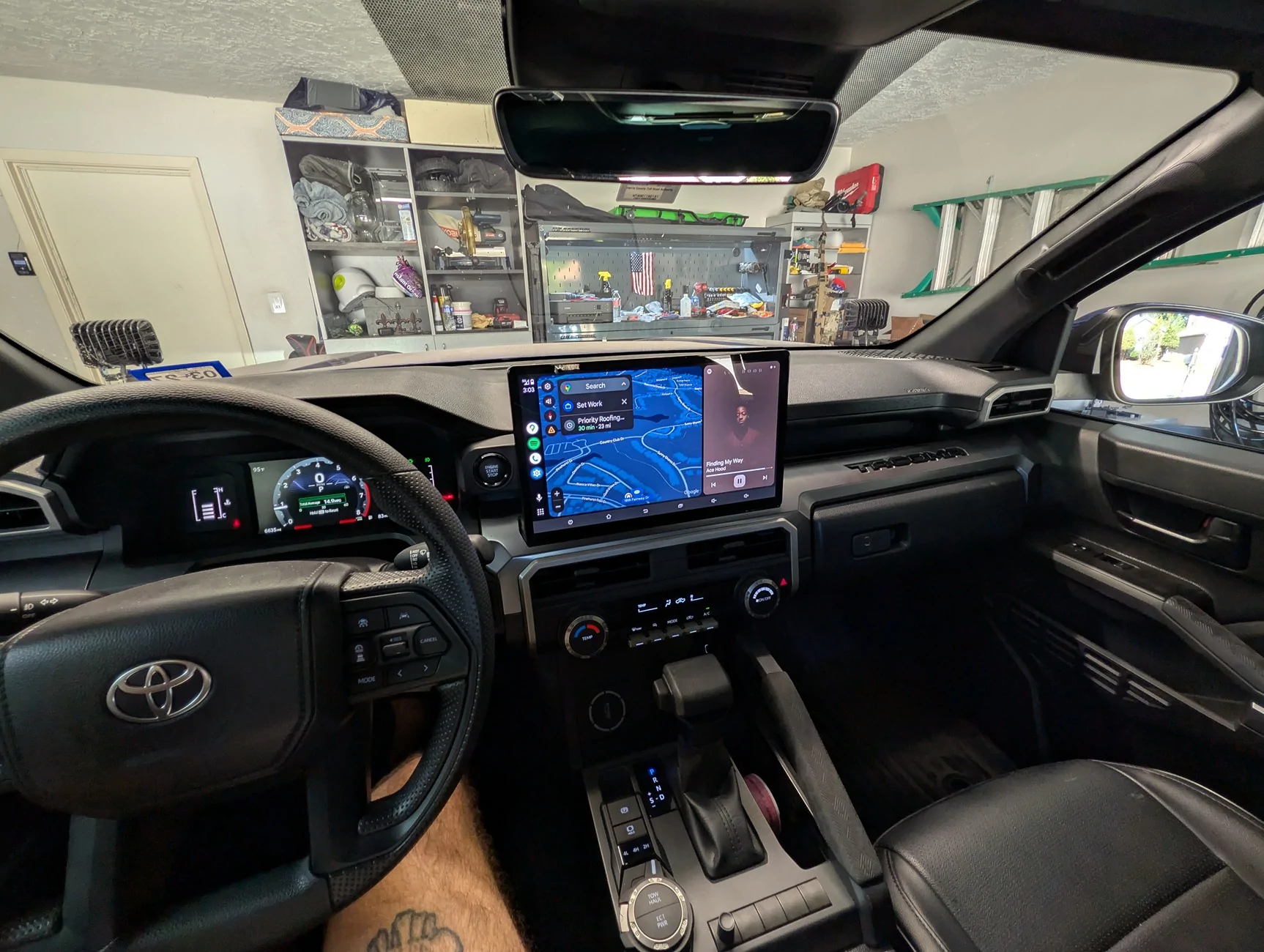

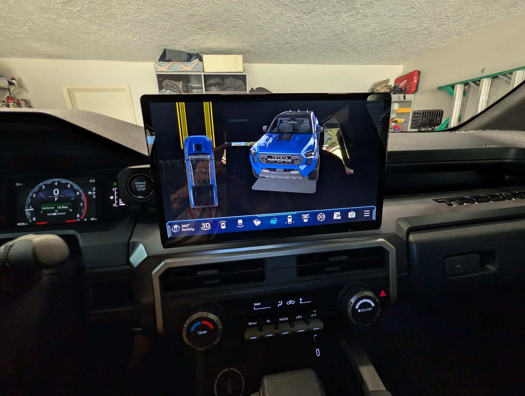

I got the infotainment system in on Saturday and spent way too much time working on the install on Sunday.
Some thoughts;
  • There is nearly no installation support/instructions, which was to be expected. I did initially reach out to the seller with a question that I found my answer to before they could reply, but they did say to record any issues I have, and they will act as an intermediary between their tech support and me.
  • The screen looks fantastic - great resolution, great quality, looks super clean installed.
  • The cameras are excruciating to install - I'm still working through this and will report back when I'm done.
  • The "DSP" built into the system definitely gives you a lot more control over the sound quality of the stock system. I had to remove my ENA-3T3, and I am getting better sound out of this headunit.
  • There are some little quirks I need to work through before I can give my recommendation on this unit.
  • From what I can tell, I've retained all of my factory/app features. The infotainment system has a CANbus module that relays information such as open doors, etc. This seems to work well.
I'm attaching a couple of pics so everyone can see what the screen looks like. I will report back once I finish the install later this week.
