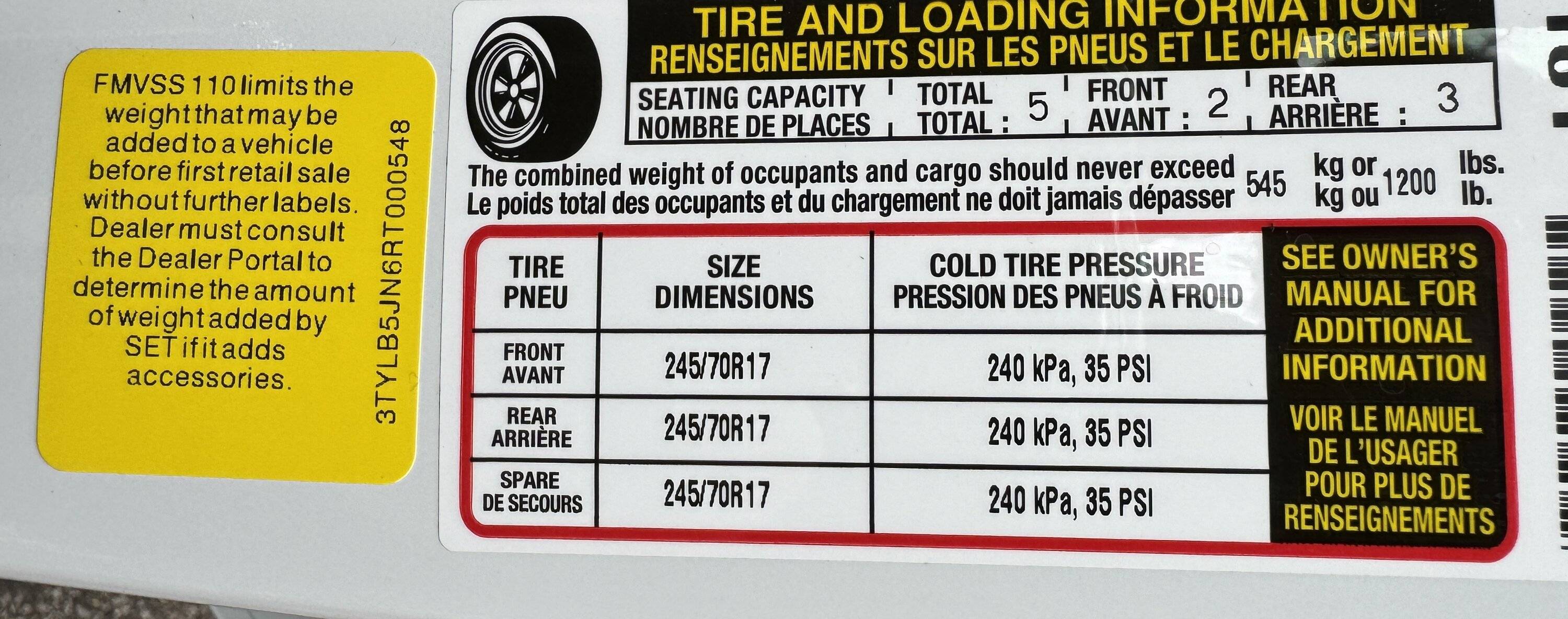

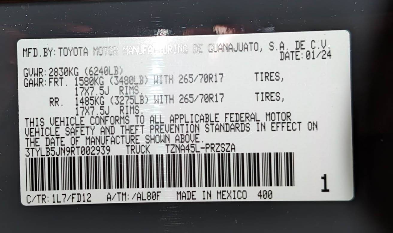

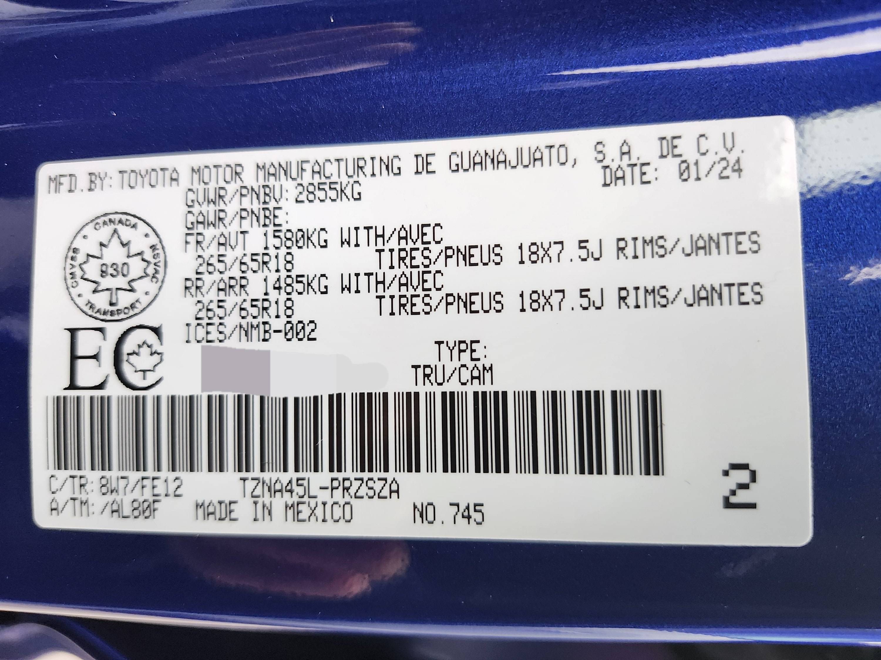

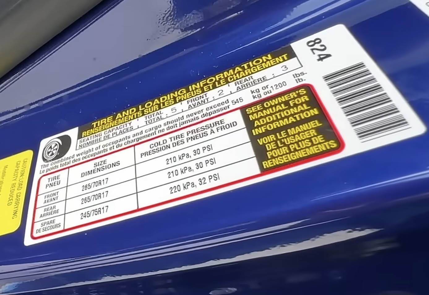

Thought this might be a helpful thread to post up the payload / GVWR figures you see on your 2024 Tacoma (or others you spot online).
Payload / GVWR from TFL's delivered TRD Off-Road
2024 Tacoma Door Sticker Thread (GVWR / Payload / Tire and Loading Figures Label). Post Yours Up 2024 Tacoma Off-Road payload GVWR lavbel sticker

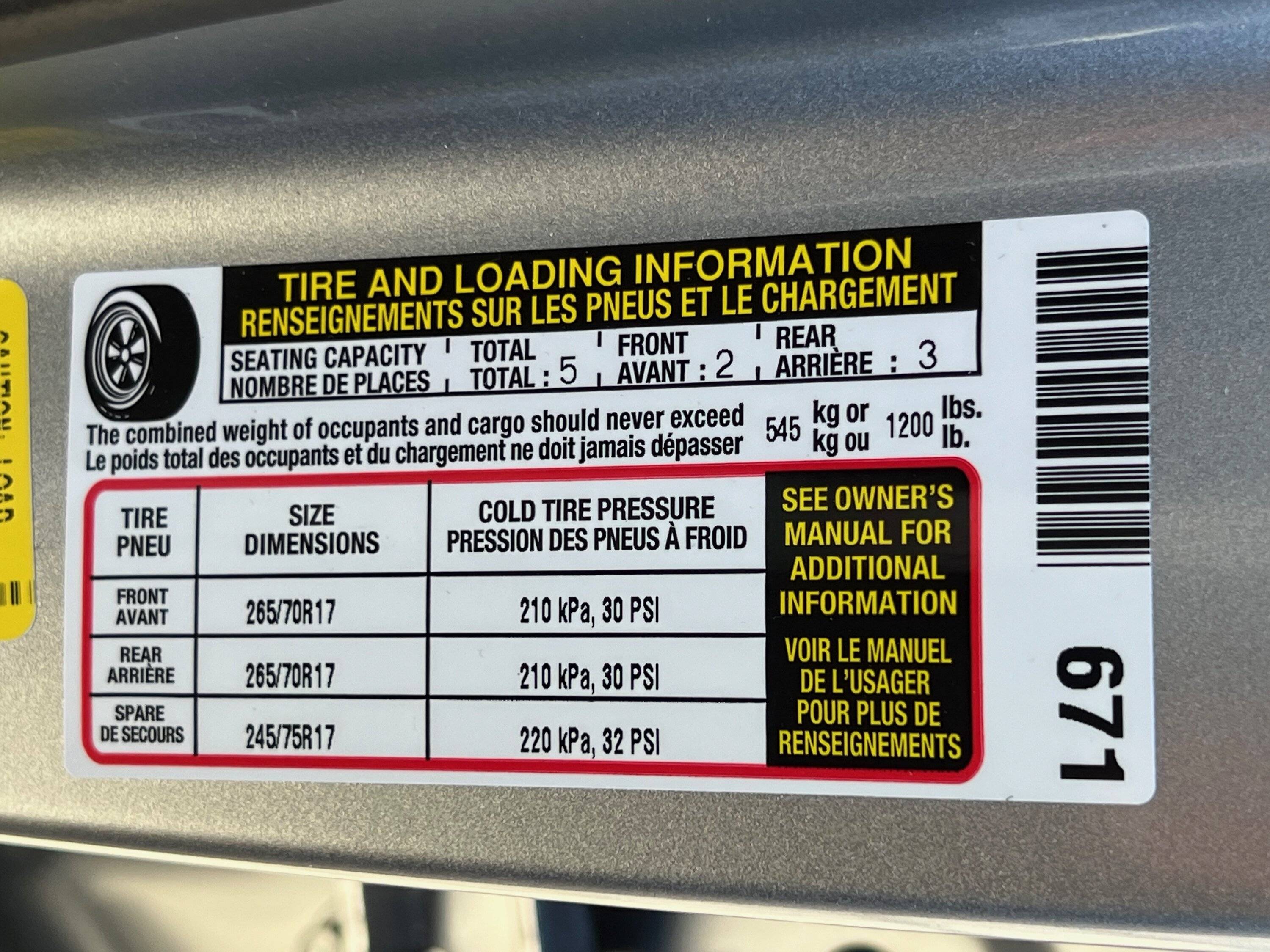

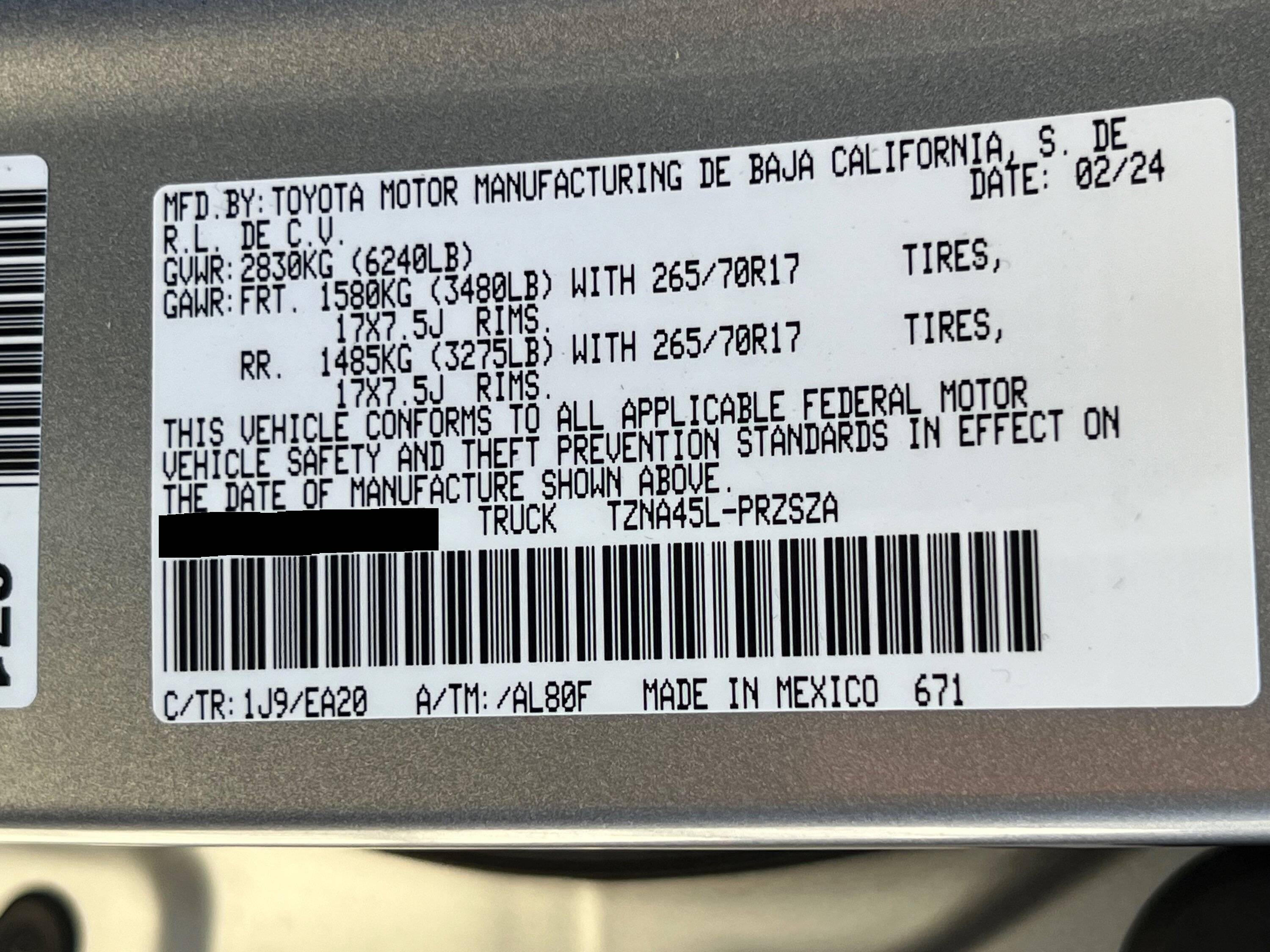

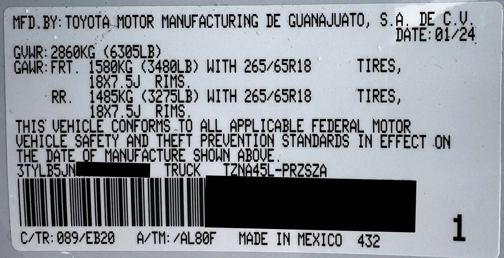

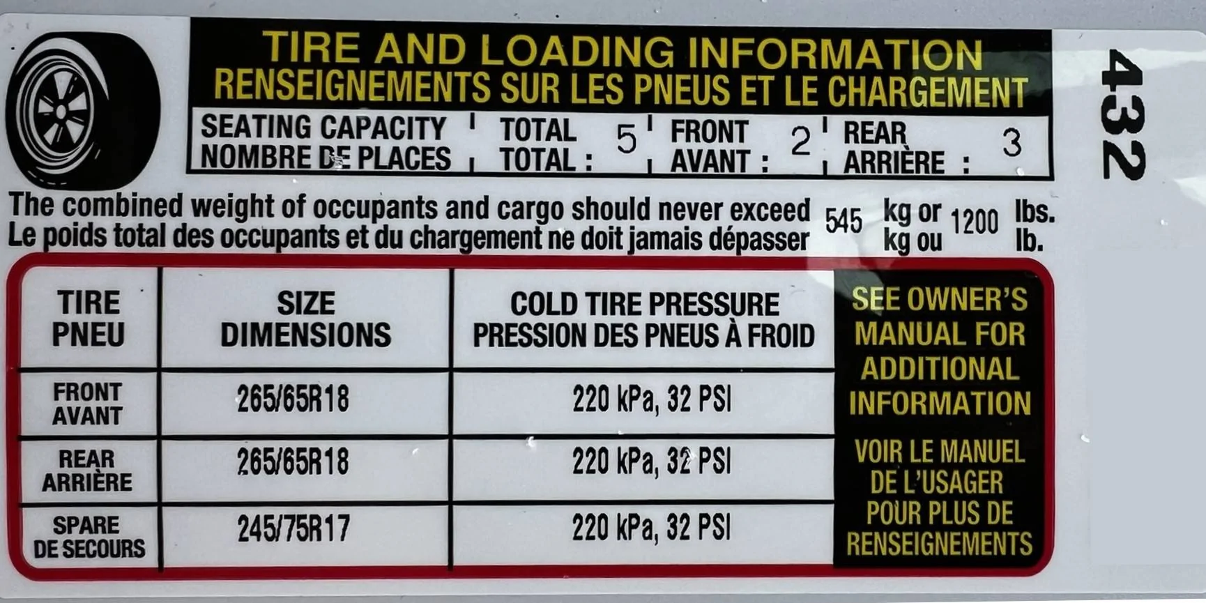

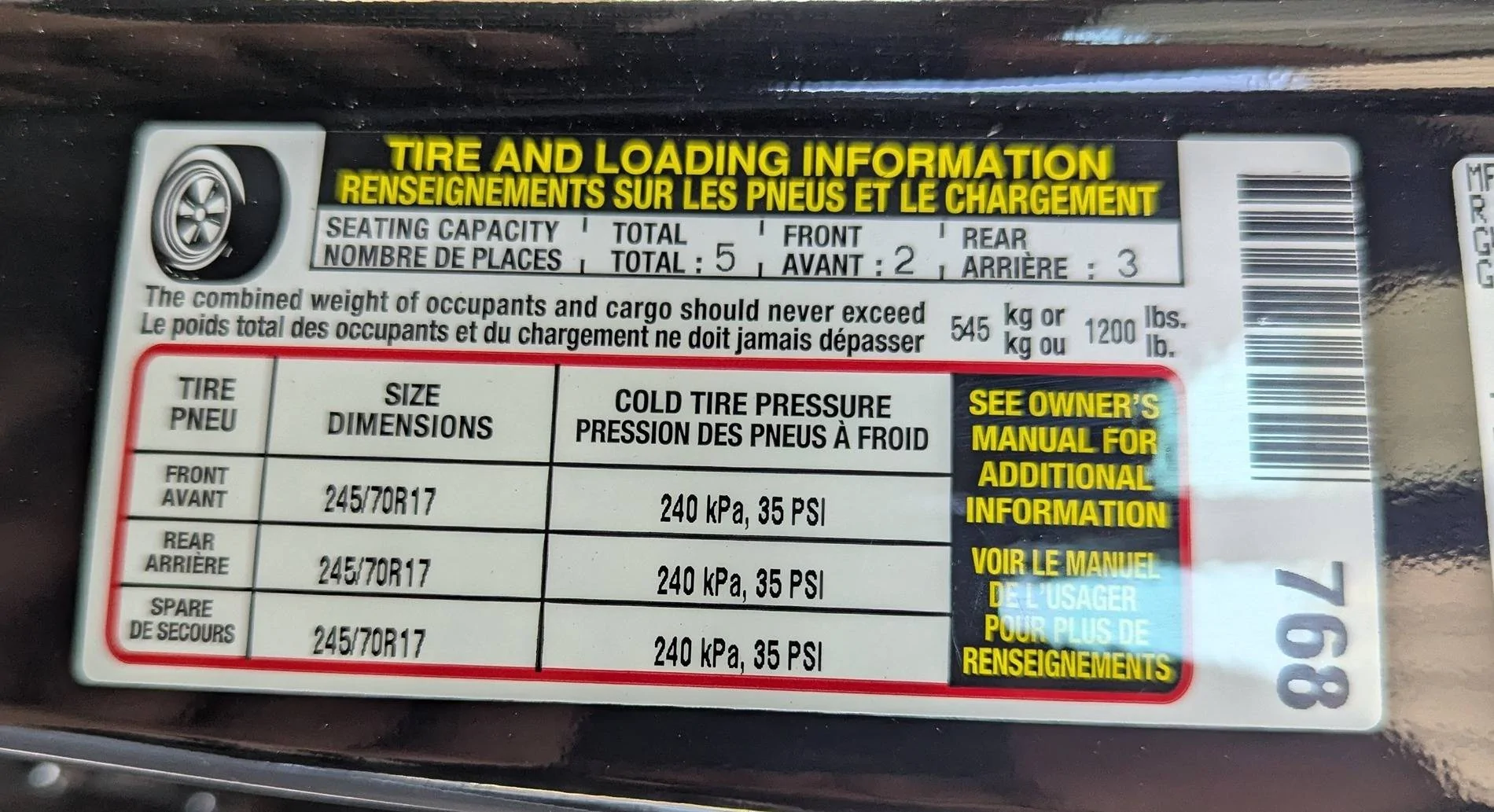

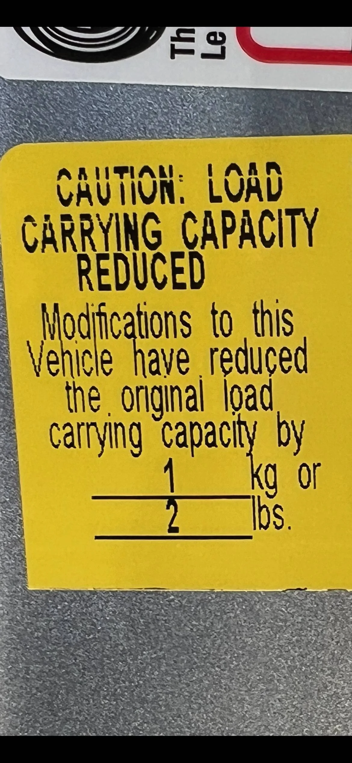

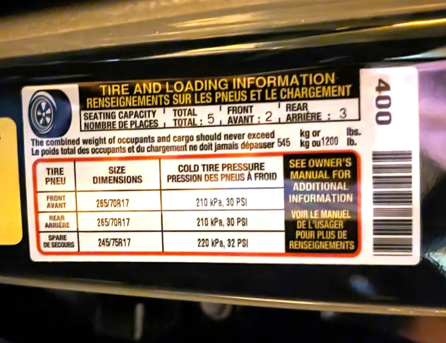

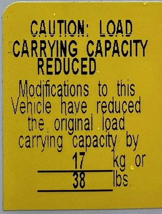

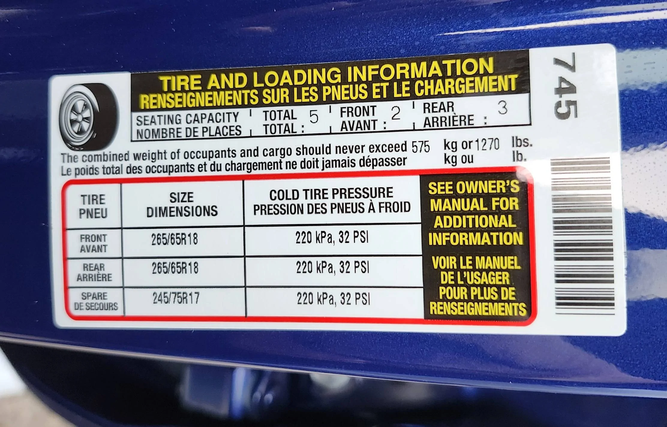

Here is the information for my USA spec TRD Off Road with only the premium option, 8 Speed Auto, 5" Bed and no steps or Stabilizer disconnect.
2024 Tacoma Door Sticker Thread (GVWR / Payload / Tire and Loading Figures Label). Post Yours Up IMG_4736
2024 Tacoma Door Sticker Thread (GVWR / Payload / Tire and Loading Figures Label). Post Yours Up payload-gvwr-sticker-2024-tacoma
2024 Tacoma Door Sticker Thread (GVWR / Payload / Tire and Loading Figures Label). Post Yours Up IMG_4821

Has anyone scaled their Tacoma yet? If the 1200lb rating actually includes occupants as it's worded, that would suggest a curb weight of around 5100lbs which seems a bit high to me?

These payloads on the door stickers are likely way off of actual GVWR minus curb weight. Car and Driver weighed a premium OR at about 4800 lbs (https://www.caranddriver.com/toyota/tacoma) which should be one of the heaviest non-hybrid models. That would put actual payload closer to 1450.
All the other reviewers and youtubers are just reading these stickers and not actually weighing trucks. It's driving me nuts to be honest

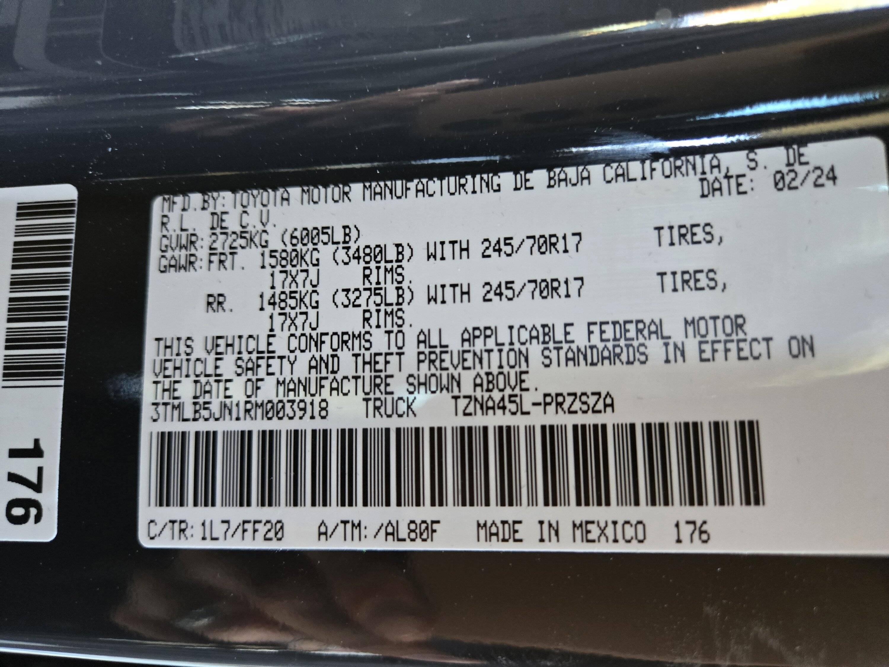

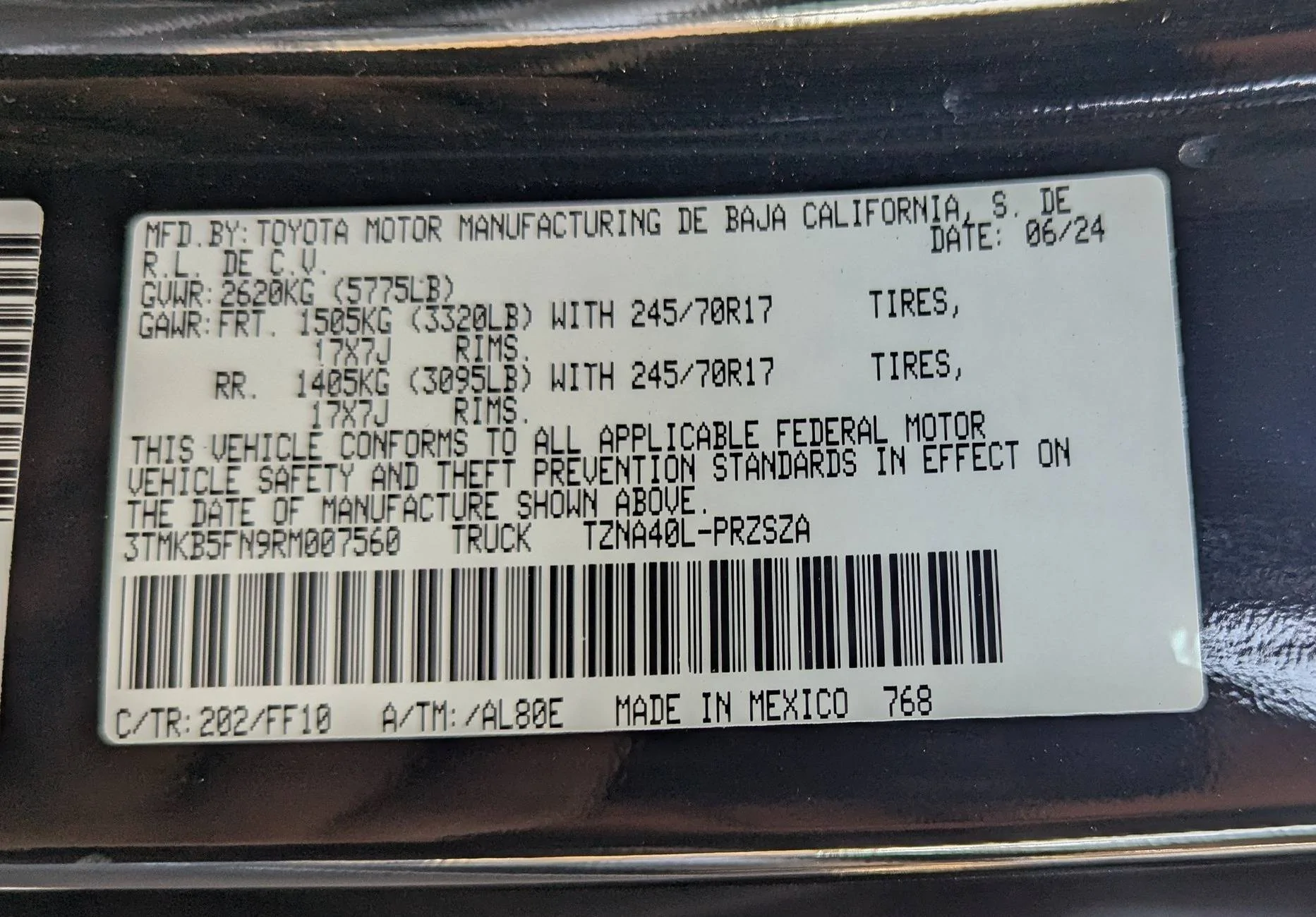

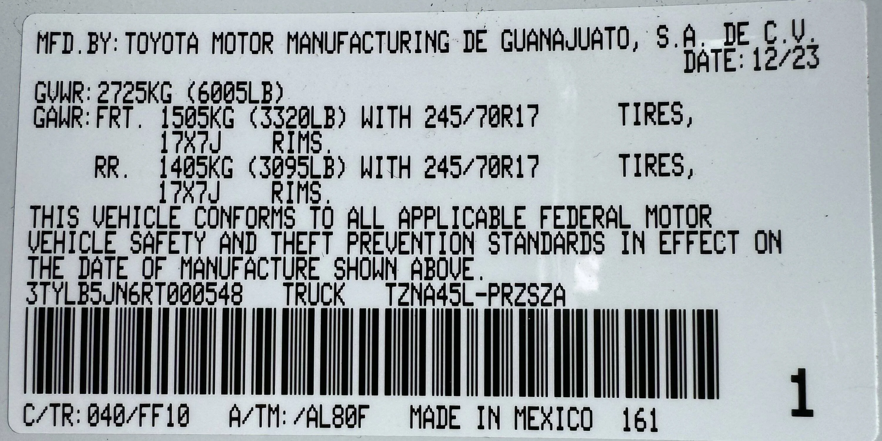

I picked up a 2024 Tacoma SR5 double cab long bed a few days ago. Just has heated seats and bed rails (no upgrade package or anything)
Weighed in at 4760 with (almost) full tank and 210lb passenger.
Curb weight: About 4550
GVWR: 6005
Payload: About 1445
2024 Tacoma Door Sticker Thread (GVWR / Payload / Tire and Loading Figures Label). Post Yours Up 20240330_114928
2024 Tacoma Door Sticker Thread (GVWR / Payload / Tire and Loading Figures Label). Post Yours Up 20240330_114947

The door sticker still claims 1,200 lbs (and it only has a reduction sticker of about 39 lbs). So this validates that you can definitely add 200+ lbs to what the door sticker claims!

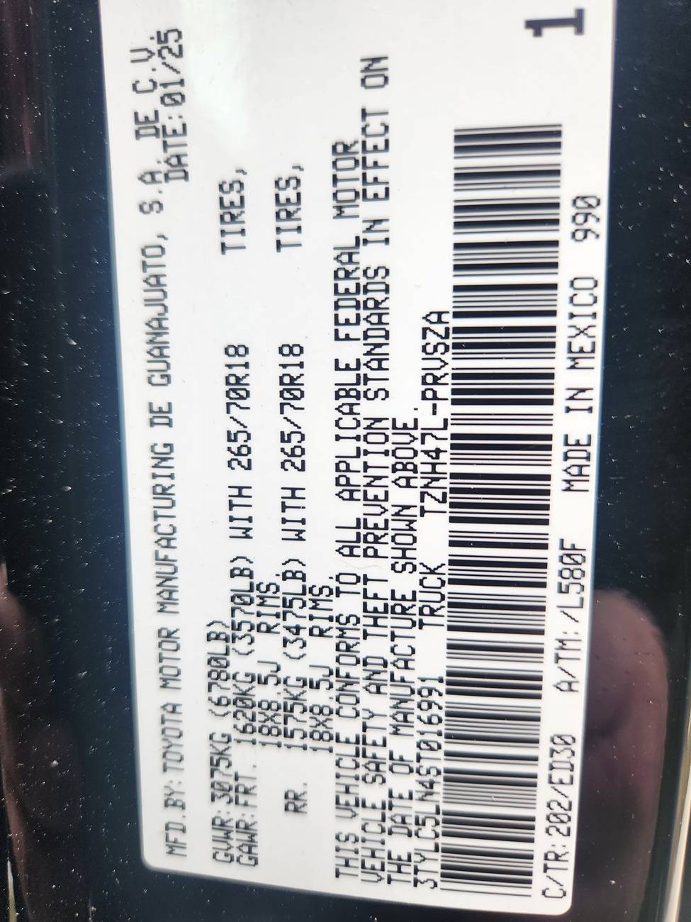

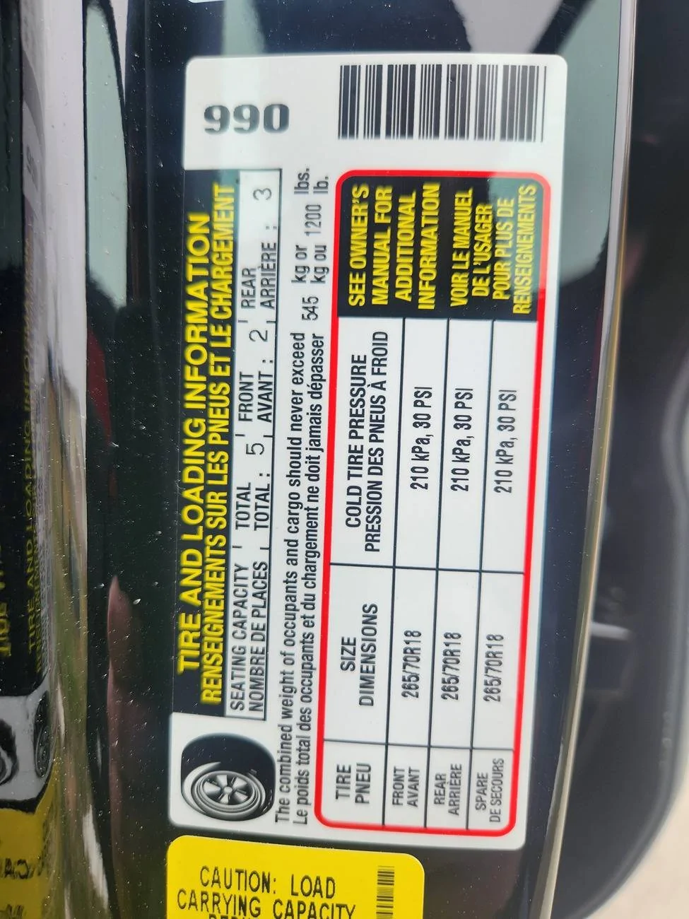

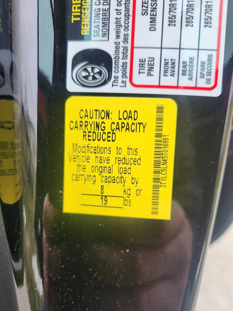

My 25 Trd pro, only option above pro package is spray on bed liner.
2024 Tacoma Door Sticker Thread (GVWR / Payload / Tire and Loading Figures Label). Post Yours Up 20250202_111036
2024 Tacoma Door Sticker Thread (GVWR / Payload / Tire and Loading Figures Label). Post Yours Up 20250202_111039
2024 Tacoma Door Sticker Thread (GVWR / Payload / Tire and Loading Figures Label). Post Yours Up 20250202_111106
