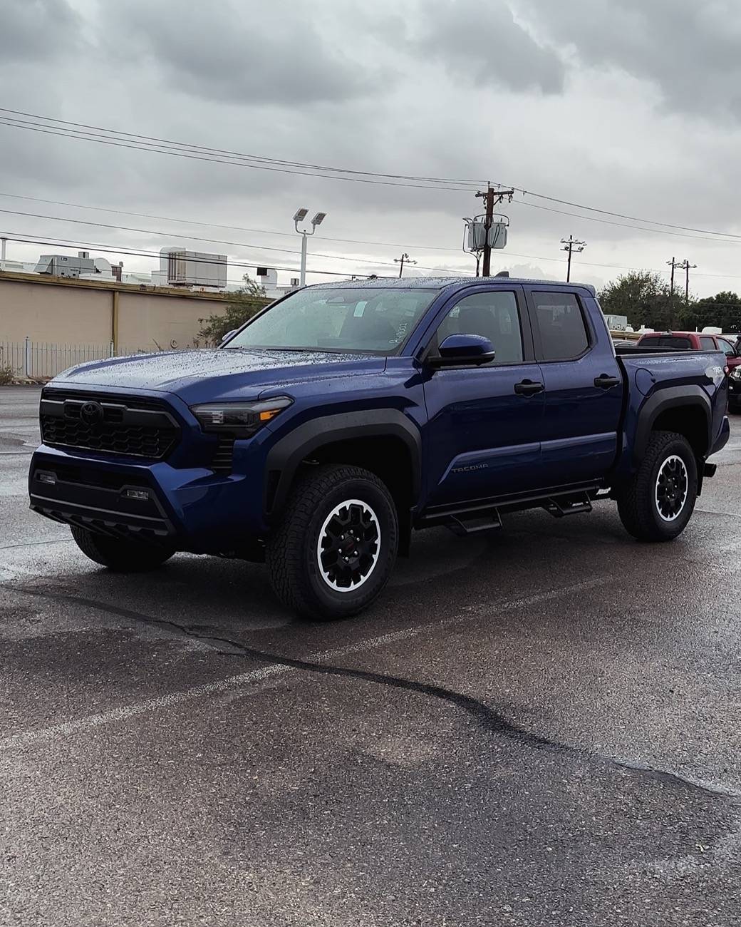

I recently went to my local dealership at Fox Toyota in El Paso, Texas and I came across an issue on a 2024 Tacoma TRD Off Road Premium that was not opening when I held the button down on the key fob. Not only did this happen when on the key but pushing the button from the driver side cabin was not working.
i posted a short on my YouTube channel in case anyone ever comes across this issue before leaving the dealership with a new Tacoma.
