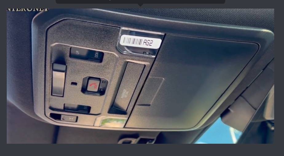

I got my present, 2020 Tacoma TRD Sport during the pandemic, and when I got it home after masked and rushed pickup at the dealer, found it had no programmable door/gate openers built into the overhead console, and neither did it have Auto-headlights. I found a 2024 TRD sport interior shot that looks like they are again not there on this model. Anyone have an idea about which package this might have been on, or will be in in 2024? Anyone have other packages info that is definitive, such as tech, cameras, lift packages, etc? Thanks in advance..
2024 Tacoma 2024 Tacoma packages with programmable door / gate / garage openers built into the overhead console? Screenshot 2023-10-26 at 6.42.29 PM

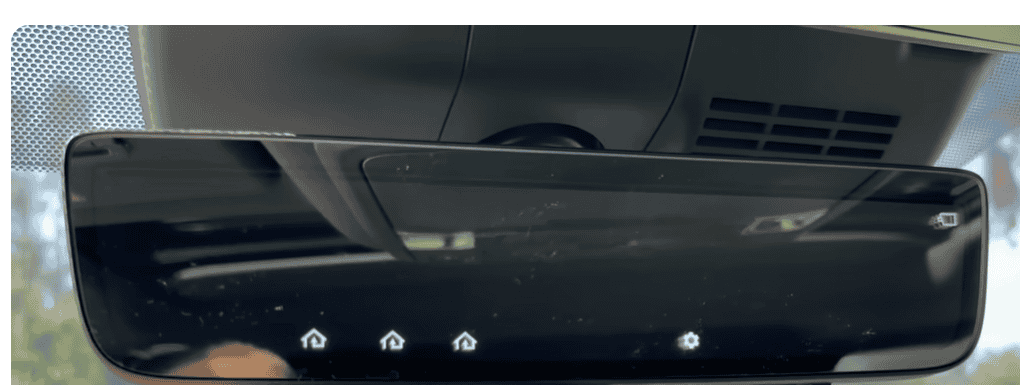

Homelink is in the mirror. Looks like this:
2024 Tacoma 2024 Tacoma packages with programmable door / gate / garage openers built into the overhead console? 1698416821934
