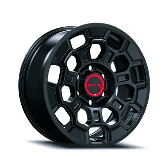

RTX TY-03 is a new wheel out that mirrors the factory TRD design. Most aftermarket wheels are going to have either a +25mm or +35mm offset. That gives you approximately an inch of poke for a better stance.
