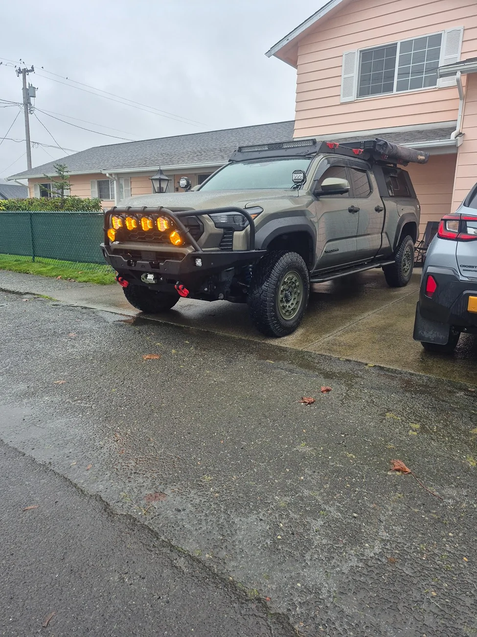

For me, I'm an aftermarket and original parts kind of guy. But when it comes to the tire pressure monitoring system, I went with factory, in my aftermarket, black rhino wheels. I have not had any problems.
2024 Tacoma 2024 TRD PRO Wheel TPMS Recommendations 20251204_094553
