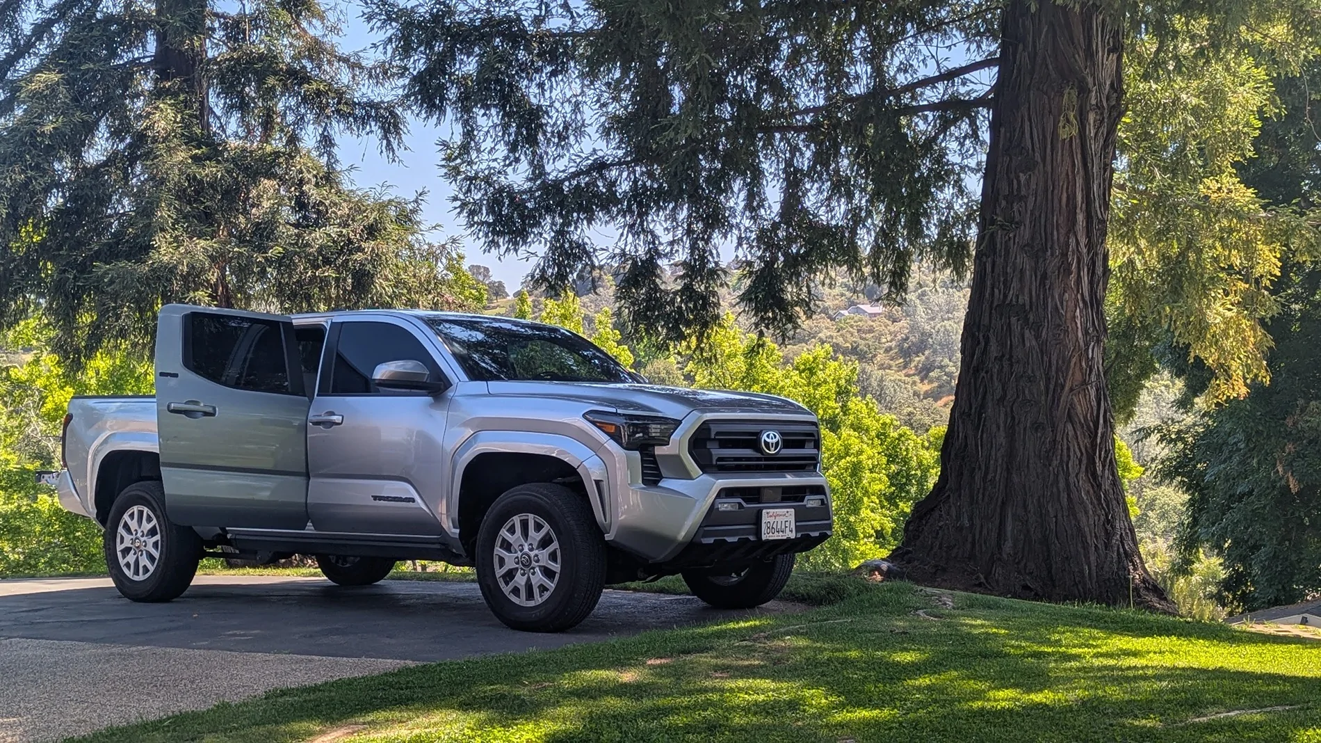

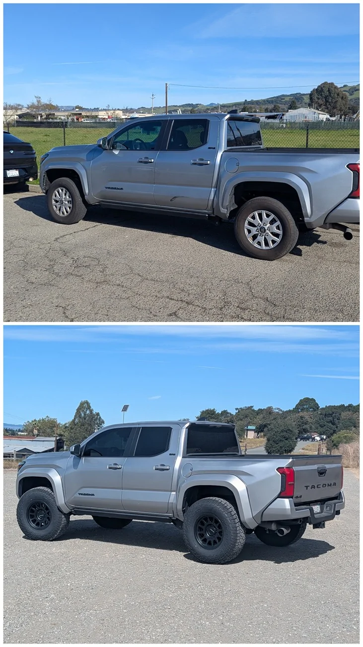

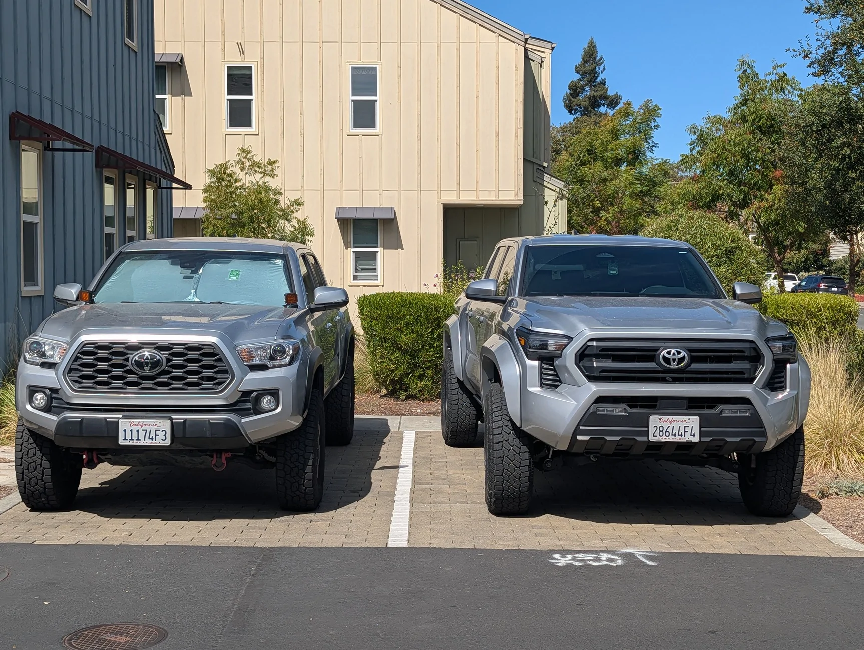

. I spent a lot of time considering this build and what I wanted to do with it.
The List with some thoughts.

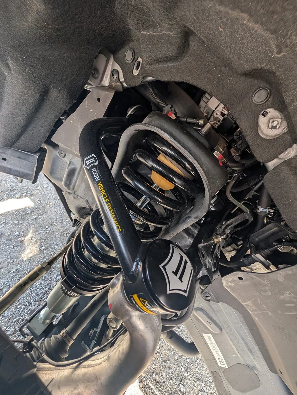

  1. Bilstein 6112 Strut & Spring Front - great bang for the buck and what I wanted to run

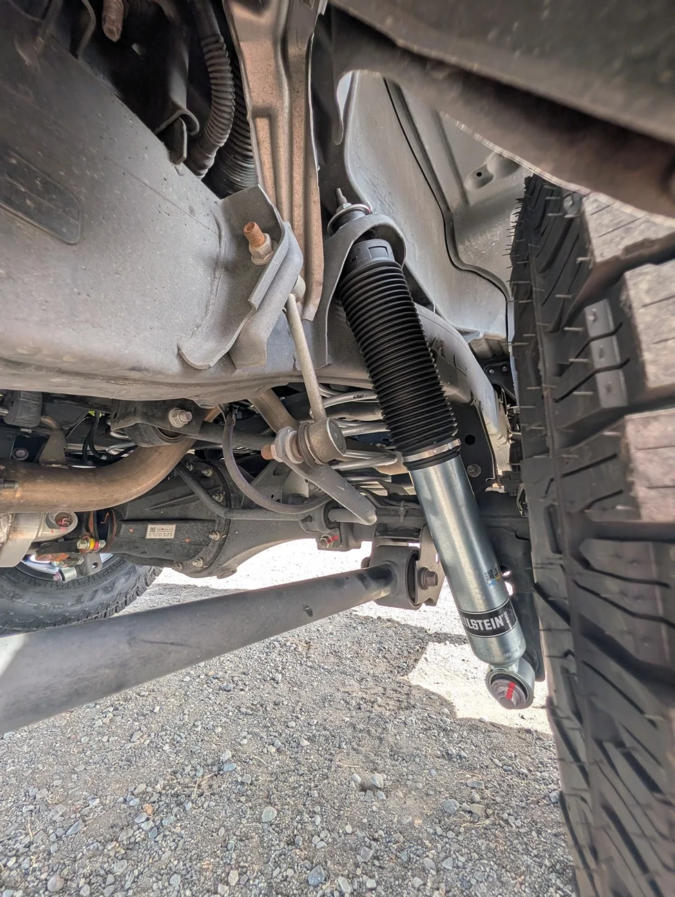

  2. Bilstein 6100 Rear Shocks - match front
  3. Eibach pro springs (rear) - `1.5" lift/level to bring even w/ front
  4. Icon Tubular UCAs - fit the need - nothing fancy

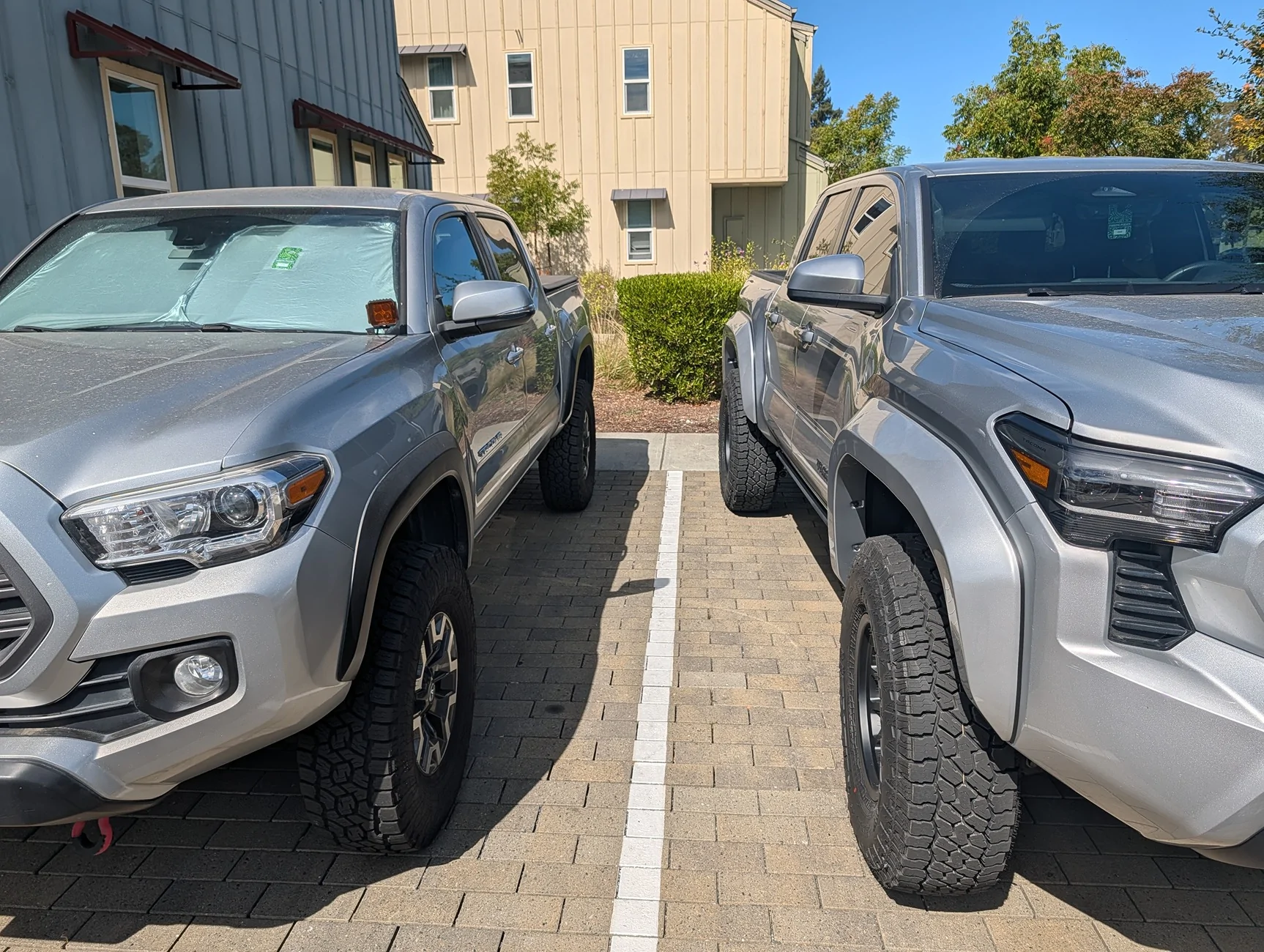

  5. Method 703's, 17x8.5 0mm offset - Im not a big "poke" guy but with my flares Im going to run I think I will be flush or just barely past. Hoping for a nice wide yet tight looking fit.
  6. Falken Wildpeak AT4w - 35x11.50R17LT 118R C - honestly wanted KO3s in 35x11.5 to save a few lbs. but too long a wait.
  7. Westcott Designs billet top hats BLACK
  8. Rough Country Fender Flares - painted to match
Mods so far:
  • TGP inline dash amplifier
  • TGP Alpine speaker swaps (8" doors not 6x9)
  • Sound deadened and foamed all doors, floor and rear cabin wall
  • Kicker 10" - hideaway (behind rear seat)
  • Tint
  • Black badge covers and tailgate letters (considering debadge)
  • Rocker pannel guards
  • wind screen removed.
The Before - the transformation is going to be dramatic.
